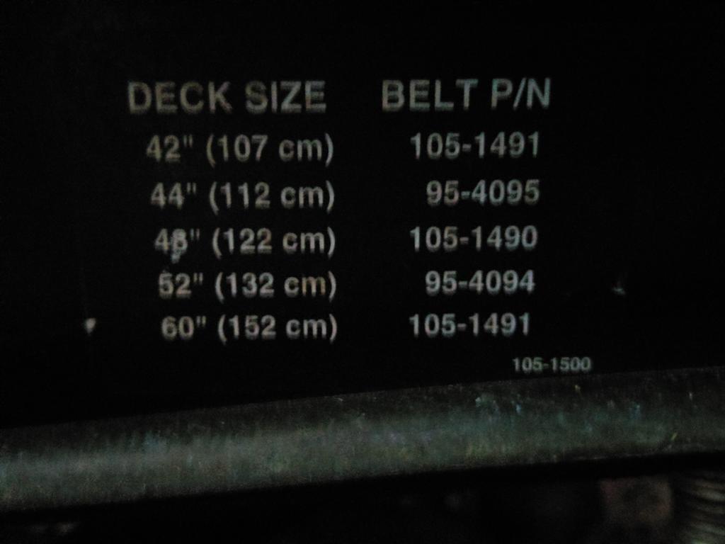

73545 is the model number of the tractor.
42" rear discharge deck for 5xi is 78353
Belt listed is almost 94" long.
Click on the pictures
Garry
WVHillbilly520H
Straight from the last the xi I owned...
