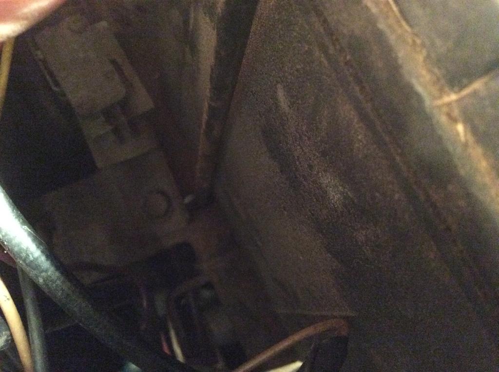

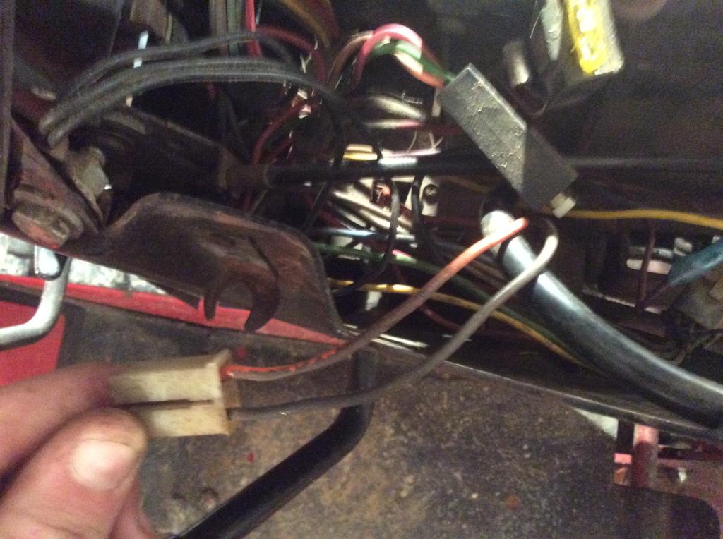

520hC-120 136 #1 Posted September 12, 2018 (edited) Hi guys, My pto safety switch doesn’t work. A little two wire connector was next to it and has a pink wire and a brown (or black) wire. What does this connector do. Any help would be nice thanks. Also may I have the wiring diagram for just the head and taillights for a 520h Edited September 12, 2018 by 520hC-120 Share this post Link to post Share on other sites

520hC-120 136 #4 Posted September 13, 2018 And there are no wires or connectors near the safety switch. This harness has definitely been messed with before. 1 Share this post Link to post Share on other sites
gwest_ca-(File Mod) 11,187 #5 Posted September 13, 2018 Did you not join the pink and gray together in an earlier post? Not common to join wires of different colors. What is the model number and serial number of your tractor? They are not all wired the same. Garry Share this post Link to post Share on other sites
520hC-120 136 #6 Posted September 13, 2018 Yes previously I joined wires to fix my no spark problem. It worked fantastically (knock on wood). That was a different connector though and was already connecting the wires of different colors. I think my 520h was tinkered to the point of having no fuse block. I cannot find one. I will work on getting you those numbers tonight. Share this post Link to post Share on other sites
Kurt-NEPA 755 #7 Posted September 13, 2018 18 minutes ago, 520hC-120 said: Yes previously I joined wires to fix my no spark problem. It worked fantastically (knock on wood). That was a different connector though and was already connecting the wires of different colors. I think my 520h was tinkered to the point of having no fuse block. I cannot find one. I will work on getting you those numbers tonight. What year 520H do you have? The 1988 and 1989 models do not have the fuse block. If you want a fuse block for a later 520H go here http://store.wheelhorsestables.com/index.php?route=product/product&product_id=94 Share this post Link to post Share on other sites
520hC-120 136 #8 Posted September 13, 2018 1988 thanks for the info Share this post Link to post Share on other sites
