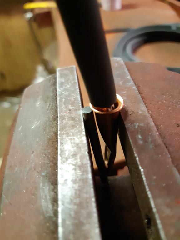

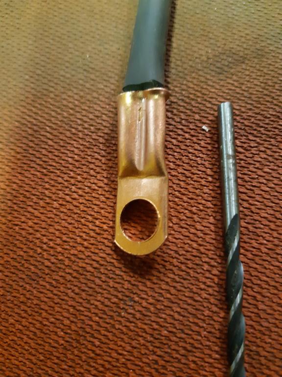

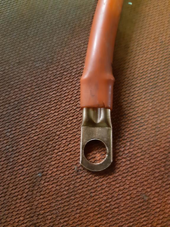

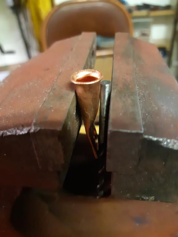

The Gman 476 #11 Posted September 11, 2018 Have been making my own for a few years now. I buy good quality mig ground cable from princess auto, the stuff with high silicone content in the jacket. Then clean the inside of the lug with a little wire brush and flux it. Strip the cable end so about 1/16 will stick out and flux the cable too. Set up in the vise with a 5/32 drill shank and the lug and squish it down with the wire in it. Heat and solder fill till it comes to the top. Then clean with alcohol and heat shrink. I've done them without solder and never had one come loose even though it's not a true toothed crimp. Works for me 4 4 Share this post Link to post Share on other sites
