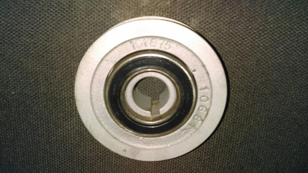

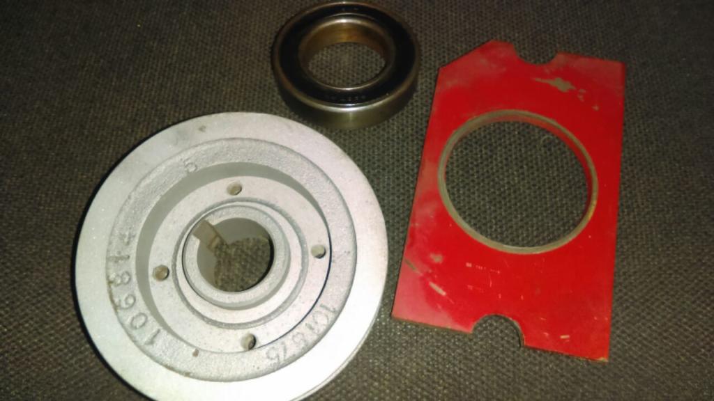

ol550 830 #31 Posted September 11, 2018 Don't know what shape the bearing is in, but I would consider taking this off. 1 Share this post Link to post Share on other sites
CountryRock 199 #32 Posted September 11, 2018 19 minutes ago, ol550 said: Don't know what shape the bearing is in, but I would consider taking this off. That would be much appreciated. Share this post Link to post Share on other sites
ol550 830 #33 Posted September 11, 2018 Next thing you may want to check is the end play of your crankshaft. If the bearing went south the crankshaft most likely was forced against the housing inside and might be damaged. This end play could be corrected with the thrust bearing properly preloaded or may need to be corrected with a different block. Just my . Share this post Link to post Share on other sites

Goldnboy 978 #36 Posted September 11, 2018 Have you attempted to pull the bearing out of the pulley with a puller? It could be that bearing will press fit in the recessed area on drive pulley 101875 used on the 8 Hp Kohlers that have the 1" shaft. Share this post Link to post Share on other sites
ol550 830 #37 Posted September 11, 2018 1 hour ago, Goldnboy said: Have you attempted to pull the bearing out of the pulley with a puller? It could be that bearing will press fit in the recessed area on drive pulley 101875 used on the 8 Hp Kohlers that have the 1" shaft. Not to jump on you or others. The inner or smaller race of the bearing mounts to the pulley #1 leaving the outer race to spin freely. The outer race contacts the thrust plate #2 thus taking the load off the inside where the crank contacts the block. 1 Share this post Link to post Share on other sites

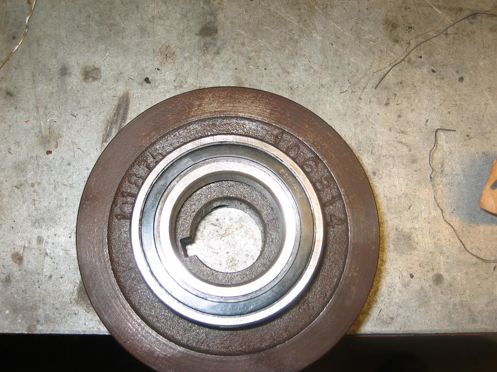

ol550 830 #39 Posted September 11, 2018 37 minutes ago, CountryRock said: I haven't because I don't have a puller for it. Doesn't need a puller, a couple of 1/4 X 20 bolts will push it out.. Looks like this. 2 1 Share this post Link to post Share on other sites

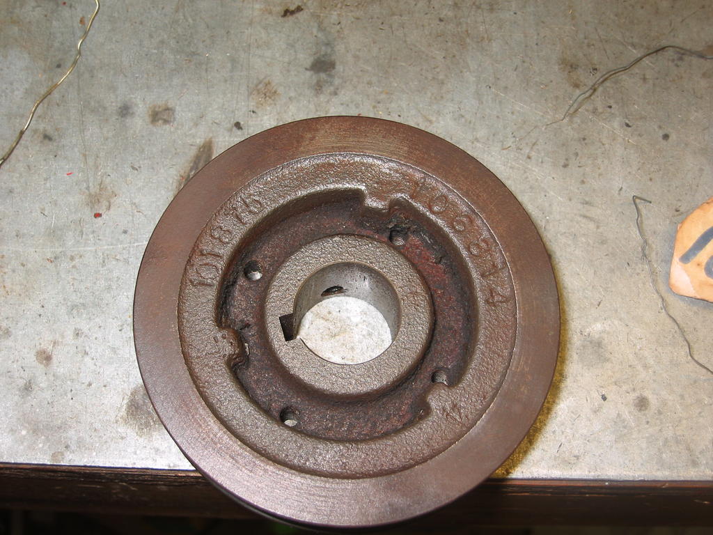

pfrederi 18,277 #41 Posted September 12, 2018 19 hours ago, ol550 said: Doesn't need a puller, a couple of 1/4 X 20 bolts will push it out.. Looks like this. OK I am a bit confused did Wheel horse machine out the inside of a 106814 and apply it to this particular setup.. This is a pic of a 106814 but you can see the lugs inside would preclude inserting the bearing and the center hub is to big for the bearings inner race Share this post Link to post Share on other sites
ol550 830 #42 Posted September 12, 2018 Best guess, sure looks like some engineer came up with a "fix" for the side load for the Briggs engine. Share this post Link to post Share on other sites
