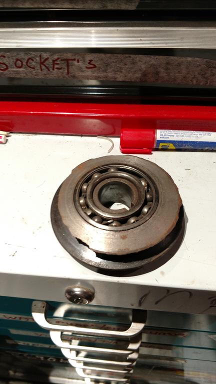

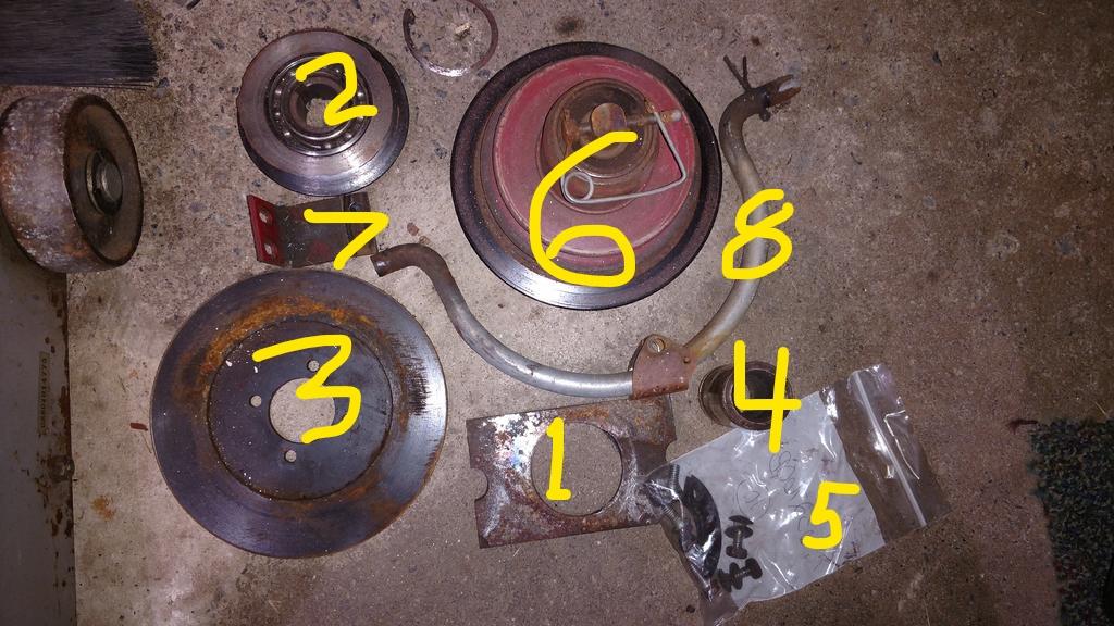

CountryRock 199 #1 Posted September 9, 2018 (edited) Just went through the box of PTO clutch parts that came with my GT2500s. There's a few things that need replacing from what I can tell. Does anything appear to be missing or not for the pto? Main question is how do I put it all together when I get the proper parts? Pics for reference Edited September 9, 2018 by CountryRock Share this post Link to post Share on other sites

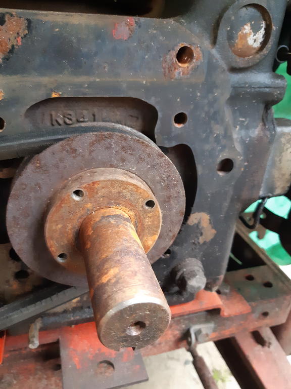

CountryRock 199 #3 Posted September 9, 2018 I have the parts diagrams to look at. That piece in the upper left of the second picture doesn't appear to show on the diagram. That's the part I'm concerned about replacing if I need to. Share this post Link to post Share on other sites

pfrederi 18,277 #9 Posted September 10, 2018 1 is backing plate goes against the block 2 Drive pulley bearing goes against 1 3 Friction Disk goes against 2 4 Sleeve goes inside 3 5 Clamps fit in groove on 4 bolts through 3 to 2 6 slides over crank and 4 7 Bolts to PTO linkage mount (not shown) 8 PTO linkage on top Plate on frame below engine on bottom. I am not sure about the snap ring maybe it holds the ball bearing in the pulley?? 1 Share this post Link to post Share on other sites
CountryRock 199 #10 Posted September 10, 2018 1 hour ago, pfrederi said: 1 is backing plate goes against the block 2 Drive pulley bearing goes against 1 3 Friction Disk goes against 2 4 Sleeve goes inside 3 5 Clamps fit in groove on 4 bolts through 3 to 2 6 slides over crank and 4 7 Bolts to PTO linkage mount (not shown) 8 PTO linkage on top Plate on frame below engine on bottom. I am not sure about the snap ring maybe it holds the ball bearing in the pulley?? If 2 is the bearing that's supposed to go behind the drive pulley, I think I'm screwed then. I can't find that part anywhere online. I'll have to look at my other GT2500 and see how that's set up. I already took some of the PTO parts off that in preparation for pulling the engine to work on. Share this post Link to post Share on other sites
pfrederi 18,277 #11 Posted September 10, 2018 Is the bearing inside the pulley (#2) bad???? Share this post Link to post Share on other sites
CountryRock 199 #12 Posted September 10, 2018 (edited) 19 minutes ago, pfrederi said: Is the bearing inside the pulley (#2) bad???? Bearing and pulley both are shot. It's the pulley I can't seem to find anywhere. I'm thinking previous owner tried pulling the pulley or something. I don't know what he used for the current drive pulley on the tractor, but it works ok, just won't work with the PTO. Edited September 10, 2018 by CountryRock Share this post Link to post Share on other sites
pfrederi 18,277 #13 Posted September 10, 2018 The bearing is 6007-RS about $50.00 1 1 Share this post Link to post Share on other sites
CountryRock 199 #14 Posted September 10, 2018 Pulley is 106814 or 110139, discontinued from what I can tell. Share this post Link to post Share on other sites
pfrederi 18,277 #15 Posted September 10, 2018 1 minute ago, CountryRock said: Pulley is 106814 or 110139, discontinued from what I can tell. Try A to Z Tractor for the pulley may get lucky Share this post Link to post Share on other sites
CountryRock 199 #16 Posted September 10, 2018 (edited) Think I looked last night and found nothing. Edit: Just looked, out of stock. Edited September 10, 2018 by CountryRock Share this post Link to post Share on other sites
pfrederi 18,277 #17 Posted September 10, 2018 You could switch to an electric PTO. Did that on my C175 when I put in KT 17 from a John Deere (no thrust bearing) Share this post Link to post Share on other sites
CountryRock 199 #18 Posted September 10, 2018 I just found a post on another forum while searching the number from a-to-z and apparently it's now toro 7466, about 90 to 100 dollars. Guess I'll be ordering one in a few weeks. 1 Share this post Link to post Share on other sites
CountryRock 199 #19 Posted September 10, 2018 OK, now that I got the part numbers figured out, could someone explain a little more in depth the bearing preload procedure. I find the instructions in the service bulletin to be a bit vague and I don't quite understand them. Share this post Link to post Share on other sites
pfrederi 18,277 #20 Posted September 10, 2018 10 minutes ago, CountryRock said: OK, now that I got the part numbers figured out, could someone explain a little more in depth the bearing preload procedure. I find the instructions in the service bulletin to be a bit vague and I don't quite understand them. i think what you are not seeing in the TSB is you remove the PTO Pulley but not the sleeve (#4) (The pic appears to leave the friction disk in place) Then you use a 3/8 NF Bolt and washer to push in on the sleeve and drive pulley Tighten to 5ft lbs to seat the bearing/pulley then back off and tighten finger tight plus 1/8 turn with wrench the using new set screws lock the drive pulley on the crank. 1 Share this post Link to post Share on other sites
CountryRock 199 #21 Posted September 10, 2018 Ok, that makes more sense now. Trying to look up the part numbers for the bolt and washer now. Seems everything has been changed. Share this post Link to post Share on other sites
pfrederi 18,277 #22 Posted September 10, 2018 I think any old 3/8 NF bolt and washer that will catch the sleeve will work Washer is $3 1 Share this post Link to post Share on other sites
gwest_ca-(File Mod) 11,205 #23 Posted September 10, 2018 7466 is 4" OD for a 1-1/8" crankshaft and no thrust bearing used with gear transmissions. The 106814 replaced by 110139 is 4" OD for 1" crankshaft and thrust bearing used with gear transmissions. Hydro models use a 5-1/4" OD engine pulley. I'm wondering if a 4" OD pulley for a 1" crankshaft pulley could be bored out to take the bearing? 101875 was used on the 8hp Kohler models. They want the bearing to take the thrust pressure generated by applying the pto clutch. The pto pushes on the pulley which pushes on the bearing. Then you tighten the pulley setscrews. If you tighten the setscrews without the pto applied the pressure is put on the crankshaft when the pto is applied. That will push the crank out of the engine. Garry 1 1 Share this post Link to post Share on other sites
CountryRock 199 #24 Posted September 10, 2018 Ok. So because there's no plate or bearing behind the pulley on the tractor now, I can just take that pulley off without doing that procedure then. Share this post Link to post Share on other sites
CountryRock 199 #25 Posted September 10, 2018 5 minutes ago, gwest_ca said: 7466 is 4" OD for a 1-1/8" crankshaft and no thrust bearing used with gear transmissions. The 106814 replaced by 110139 is 4" OD for 1" crankshaft and thrust bearing used with gear transmissions. Hydro models use a 5-1/4" OD engine pulley. I'm wondering if a 4" OD pulley for a 1" crankshaft pulley could be bored out to take the bearing? 101875 was used on the 8hp Kohler models. Well that's no good then. No Idea where I'd go to get a pulley bored out. Jack's Small Engines shows that 7466 pulley would fit an SB-421, which I think is the same engine. Share this post Link to post Share on other sites
