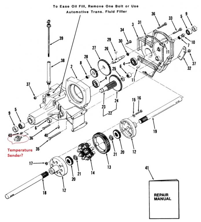

Duff 206 #5 Posted February 21, 2020 Bringing this thread back to the top.....I've got a 1990 520H I bought last fall and am now getting around to cleaning up. Where on the hydro is the temp sensor located? The wire was disconnected when I bought the tractor and it looks like the terminal may have broken of the sensor. I've looked at the transmission, the IPL and the wiring diagram but can't figure out where the actual sensor is located. Help and thanks! Share this post Link to post Share on other sites
gwest_ca-(File Mod) 11,241 #6 Posted February 22, 2020 Perhaps this is it. Appears to be under the right axle below the dip stick. The sending unit is shown on the electrical page but that does not help with location. Garry 1 Share this post Link to post Share on other sites
