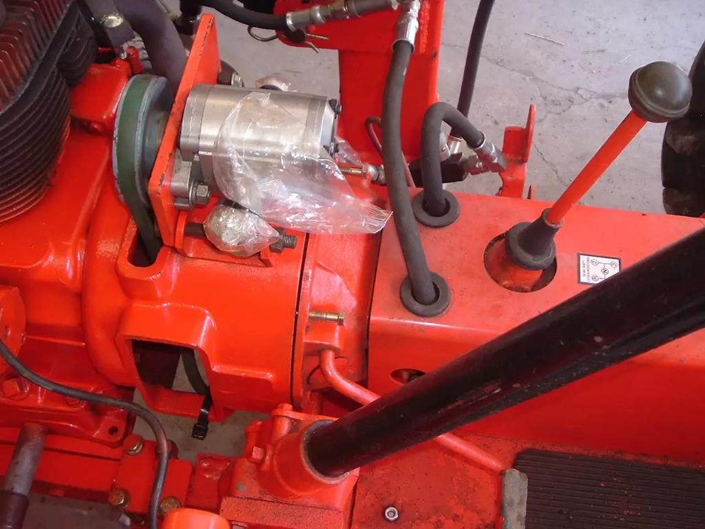

squonk 41,936 #9 Posted September 3, 2018 (edited) Trying to upload some pics of the hyd belt replacment. You have to pull the engine or trans to do it. Not a bad job. I'm bored today. TOO HOT 95 ++++ https://www.mytractorforum.com/200-power-king-economy-tractors/187470-chronicles-elvis-dont-let-hyd-belt-scare-ya.html Edited September 3, 2018 by squonk Share this post Link to post Share on other sites

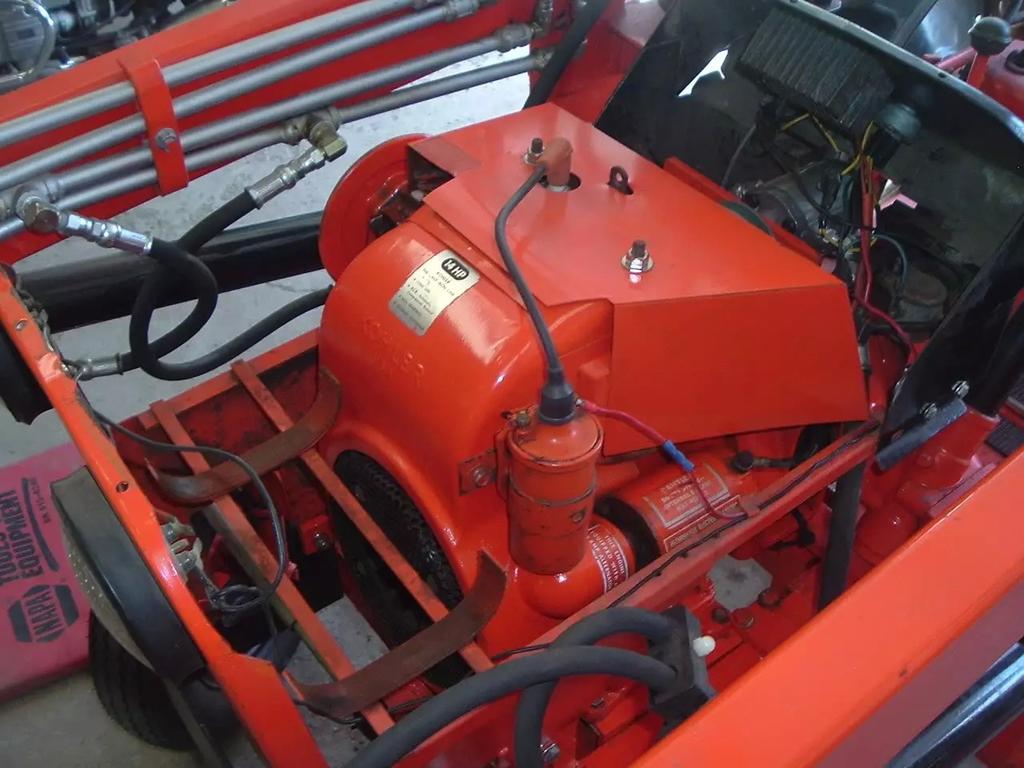

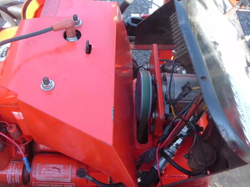

squonk 41,936 #10 Posted September 3, 2018 Working on converting pics to something usable. Here are a few. You have to pull off the gas tank, The panel the headlights mount in and the dash panel. Not really a hard job. I had done some painting in the process. prolly would have been a 3 hr. job with out the sprucing up. I'll have some before pics when I get them converted. Hood off you can see the K321 New belt is on the pump. There is another belt in there tied off for when this one wears out. You can see the heavy tie strap and part of the other belt in the last pic. 2 Share this post Link to post Share on other sites
rjg854 11,709 #11 Posted September 3, 2018 Nice job Mike, looking good Share this post Link to post Share on other sites
squonk 41,936 #12 Posted September 3, 2018 It was harder to convert all these pics than doing the job itself. after this I'm going to try to find my loader build pics and post those. This is what Elvis looked like under the hood before I did any work on it. Like I said the dash board comes off. Most of the bolts also holds the trans to the engine. You can see how worn that belt was. Engine slid away from trans I cleaned up and painted the engine bay. Couldn't leave it like this! Replace the head gasket whilst the big block was out. New belt much better. 1 Share this post Link to post Share on other sites
