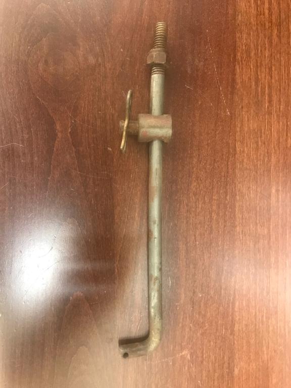

I am planning on attaching the snow plow to my 71 Raider 10 this weekend to move some dirt around.  The only lifting rod I have came off the mower deck, and has a slip collar that allows the deck to float up if necessary.  Should the plow have a lift rod that allows me to put downward force on the blade?   My tractor has the electric lift mechanism.   Picture of lifting rod for mower deck is attached.   I think I remember being able to lift the front of the tractor off the pavement with the plow when I was a kid?  I hope what I am asking makes sense...   Thanks!

I'm at work,  so I can't take any pics,  but I have a short piece of flat stock that attaches mine.  It does have down pressure.

Daron,  Thanks!  That is what I needed to know!
Tankman
Down pressure or lift your snow plow.

I think @wheeledhorseman makes a solid link between the upper arm and the blade frame, also.
Tankman
I just drilled a couple of pieces of flatbar. Off the rack at Home "Cheapo" or Lowes.
