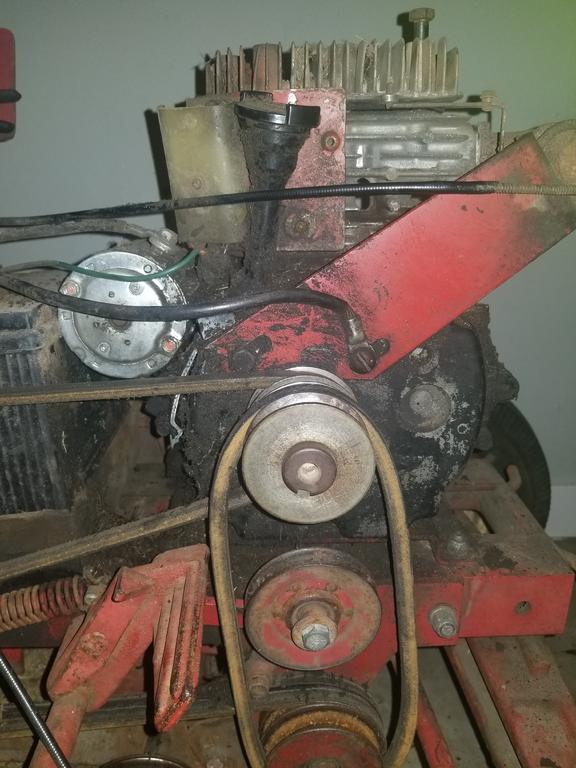

So I have been working on a 656 I picked up at the end of last year and I did my first ever motor rebuild by my self on it. However it seems that I have lots of play in the piston and some slop at TDC more then I should have. So to finish the year mowing I am thinking of doing a predator swap while I go over the engine again. I am sure several people have done this before and I have a spare mounting plat to make it work. I am wondering if anyone has any pictures of ones they have done for help along the way. I know I will need a adapter to use the factory pulley and I don't want to destroy any of the sheetmetal since it is in good shape. I will keep you posted as I go along and eventually when I get the hh60 back together correctly to re install.

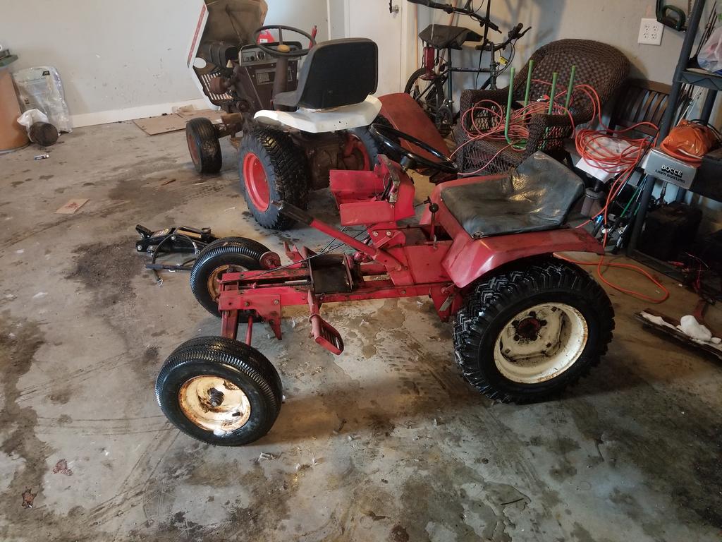

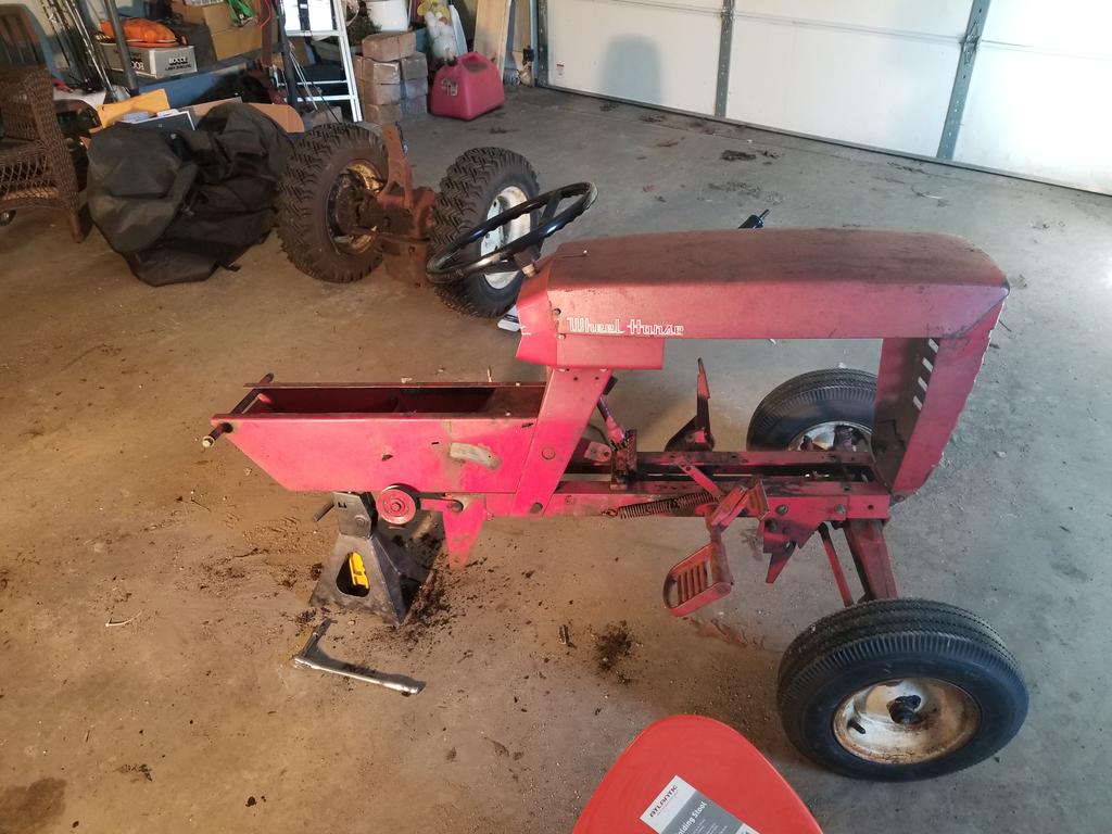

ohiostate454
Those are the before pictures, don't really have any of it right now lol. I ended up buying a short block of Ebay that "needed rings" because the block that came on the tractor was blasted to bits for the previous owner never putting oil in it. So the flywheel, carb, pulley, etc came from that motor and the piston, rod, crank, etc where from the used block. I honed the cylinder put new rings in it but now I am wondering if I should have went with a whole new piston and rod assembly. New bearings in the block and rebuilt the carb. I want it to be original but my bolens deck needs to be rebuilt bad so I am thinking of using the predator to mow with this and pull trailer for leafs etc the rest of the year.
