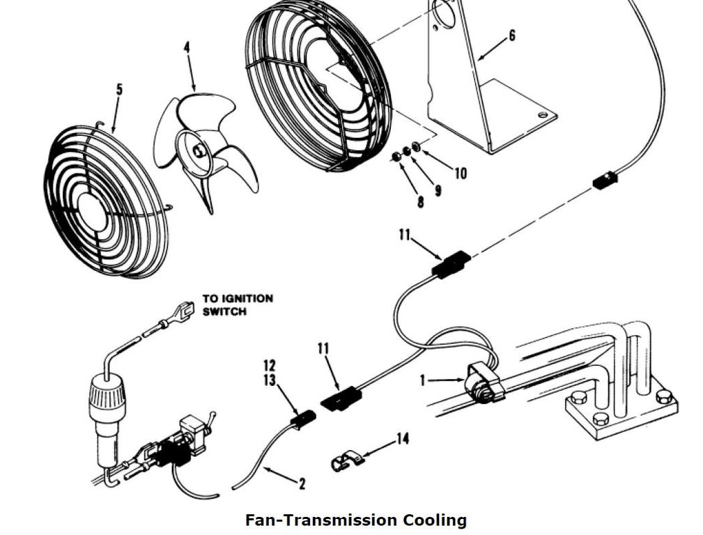

bo dawg 516 #1 Posted August 12, 2018 Where does the thermostat attach to for cooling fan? Share this post Link to post Share on other sites
pfrederi 17,934 #2 Posted August 12, 2018 around a manifold pipe 3 Share this post Link to post Share on other sites
squonk 41,571 #3 Posted August 12, 2018 That thermal switch looks just like a fan switch that we use in refrigeration. Definitely clamps on a pipe. That's what the "valley" on the switch is for. 2 Share this post Link to post Share on other sites
bo dawg 516 #4 Posted August 12, 2018 (edited) Doesn’t matter which manifold pipe? Edited August 12, 2018 by bo dawg Share this post Link to post Share on other sites
pfrederi 17,934 #5 Posted August 13, 2018 I doubt it would make a material difference but you could use the one in the picture..or what ever one it is easiest to get on.... Share this post Link to post Share on other sites

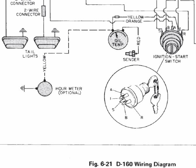

bo dawg 516 #6 Posted August 16, 2018 After tracing down the wires to it, my first thought was it was wired up wrong, cause someone has done some splicing here and there in a poor way, It was hooked up to the light switch. But after looking at the diagram it does show it being hooked up correctly. Now for me that seems odd, I would thought there would be a separate switch for it or something cause I'm not one to run the tractor during the day with the lights on. But I guess on this D the light switch will stay in on position if I want the fan to kick on when needed. Or maybe I will install a separate switch or could it be wired up direct? Share this post Link to post Share on other sites
pfrederi 17,934 #7 Posted August 16, 2018 You wire it to the feed side of the light switch, it is hot when ever the key is in run. The temp sensor will turn the fan on an off as needed 1 Share this post Link to post Share on other sites
gwest_ca-(File Mod) 11,117 #8 Posted August 16, 2018 This diagram shows a temperature gauge wired to the Ignition terminal along with the hourmeter. Does the engine have a temp sender? From it's position on the diagram it looks like it would be for the cooling fan. The lights are wired to the Accessory terminal on the ignition switch using an orange wire. Garry 1 Share this post Link to post Share on other sites
pfrederi 17,934 #9 Posted August 16, 2018 (edited) The only difference is the fan would run while the engine was cranking... not sure i like that idea... D200 diagram shows it off hot side of the light switch being onllight switch it is coverd by a 20 am fuse. don't see a fuse off ignition Edited August 16, 2018 by pfrederi 1 Share this post Link to post Share on other sites
