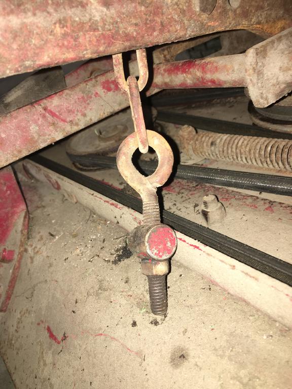

Hello,
Tried searching around and could not find my answer. So I bumped a tree with the deck and the linkage for the hydro lift came out. I have looked but can’t quite figure out where it goes. Any insight would be great.
I looked at the ram it is moving normally, checked the lift brackets that the ram moves but was not able to see where this goes.

richmondred01
Here you go.
Edited by richmondred01
richmondred01
And the top one goes on the rock shaft.
KC9KAS
I bet #21 hair-pin came out of the trunnion #20. Easy fix!!
Haficon
Thanks man... that is exactly what happened.. just could not find where it goes just got the tractor not long ago and it needs some tic and cleaning.
Haficon
Got it fixed... against thanks was easy just did not know where it hooked up to.
