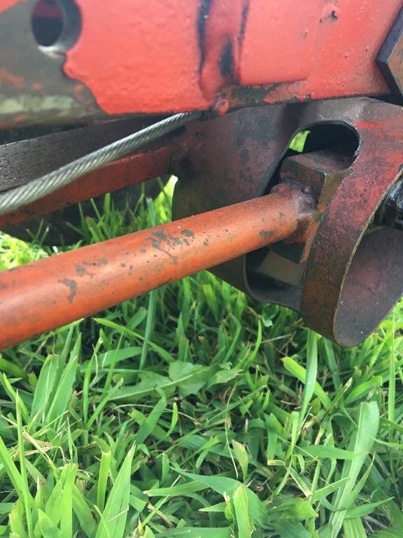

Hey Everyone,
I purchased a CBR-32 this weekend and for the most part it is complete. The only things that were missing were the foot pedal (Found a drawing on here for that) and the circular guard that is welded to the main support rod of the unit. I have attached a picture for reference. Has anyone every remade one of these or does someone have a drawing with dimensions so I can remake it? Thanks in advance!!

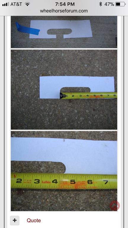

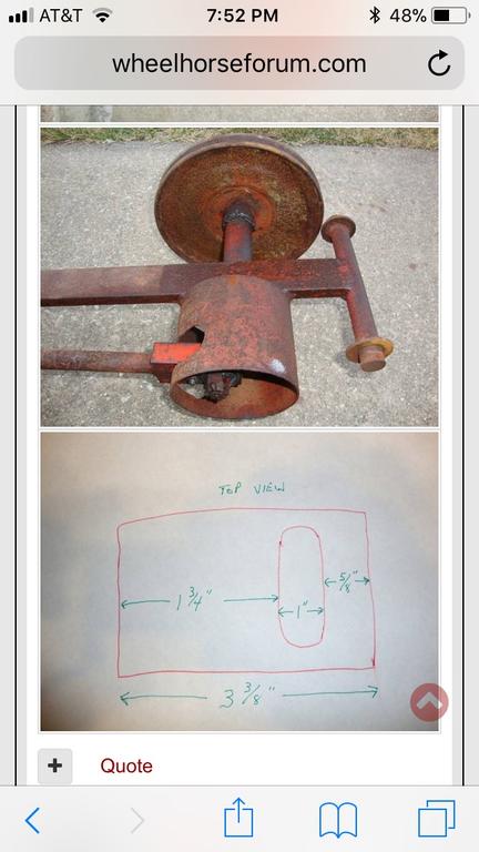

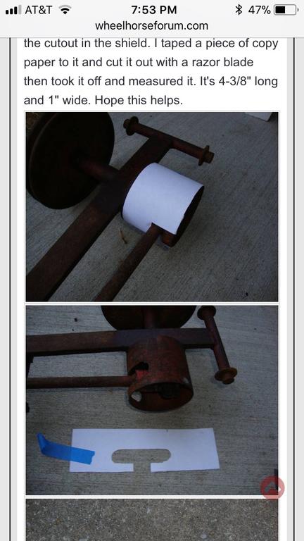

I took these pics several years ago, hope they help. I no longer have the sickle to measure the diameter of the guard.
