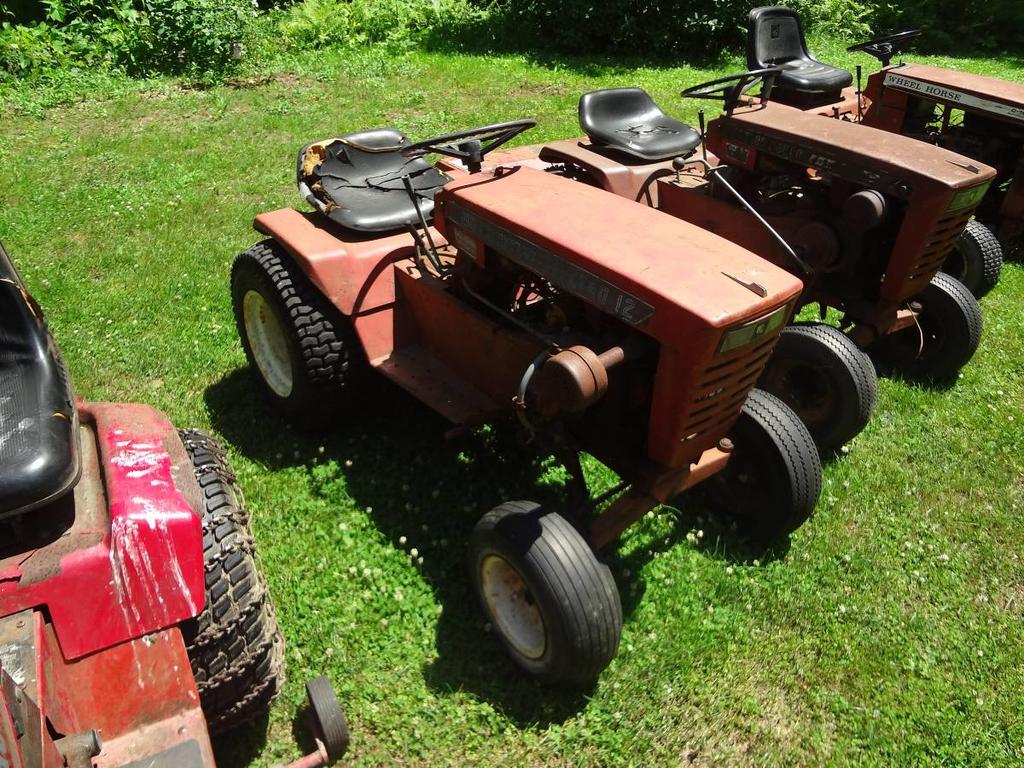

FatJackDurham 318 #21 Posted August 7, 2018 If you do go out there, it looks like that guy also has a Charger-12 for sale, for $350. Something about the left side lever controls looks interesting, but I can't make it out in the picture. Share this post Link to post Share on other sites
pfrederi 18,334 #22 Posted August 7, 2018 20 minutes ago, FatJackDurham said: If you do go out there, it looks like that guy also has a Charger-12 for sale, for $350. Something about the left side lever controls looks interesting, but I can't make it out in the picture. It was an Electro that came with an Electric PTO. It must have failed and when they went with a manual they went with a more modern style with the hoop and linkage used on C series and later.. Share this post Link to post Share on other sites
