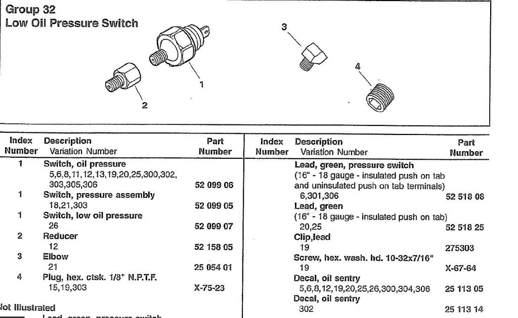

A look at the service manual shows the oil pressure switch having a 1/16" NPTF thread which I have not heard of. I expected to see 1/8" NPT and the 1/16" may be a typo. There is a difference between NPT and NPTF in the thread design and sounds like the naked eye can't see the difference. NPT = National Pipe Thread and F = fuel
http://www.cutting-tool-supply.com/TechTips/Tapping/NPTvsNPTF/NPTVsNPTF.htm
The switch in the parts manual is Kohler 5209903 that is replaced by 5209905. Neither are listed as available.
Did find an online reference that 2409903-S for the later CH and CV models is a replacement but don't know for sure.

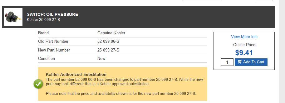

A few years ago the oil pressure switch on my 418 started spraying oil on the muffler.  It is a Magnum 18 but in reality Mag 18 and KT 17 Series 2 are essential same engine with a different ignition. The variant number for the WH spec 24510 magnum is 8  I do not recall where I got the switch but it was cheap.  For $9 bucks I would try this one.  Or forget it ans use the 1/8" NPTF plug
THAT IS THE EXACT SWITCH ON MY ENGINE!! Where do I buy this part?

I looked at one of my older KT17s she doesn't have the switch just a pipe plug sealing the hole.  It is definitely 1/8" NPTF.
You can get the switch from any parts place this is from Replacement Commercial parts warehouse

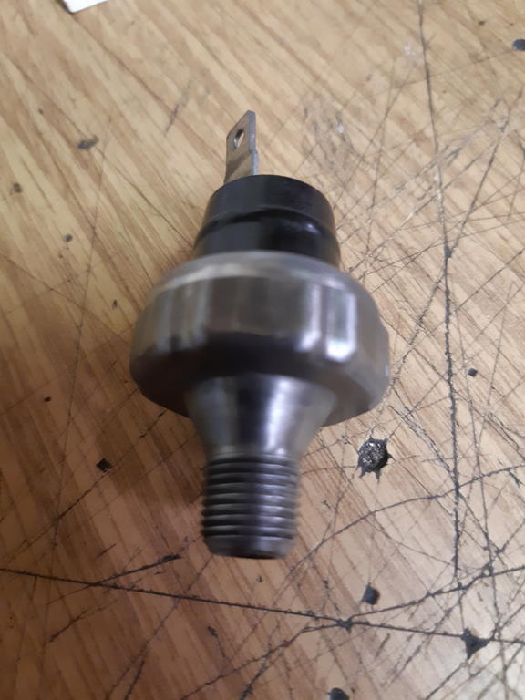

This is what you need. It came off my series II. I use an electric pressure gage now.
PM me your address and I'll mail it to you. Freebie!

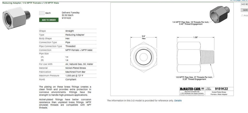

1 hour ago, Elijah’s Wheel Horse 417A said:
I actually already bought this one the thread is to big
If you still have get an adapter like this and use it.  the one on my 418 has an adapter like it.
