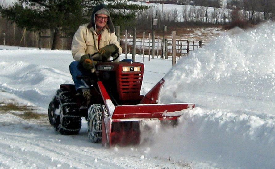

pfrederi
moved a lot of snow with this Charger 12....

peter lena
I picked up a nice set of j/d flat cast iron  wheel weights, painted them black and look much better then the w/h weights that hang out of the wheels, that smile tells us all what we know, good blowing , pete

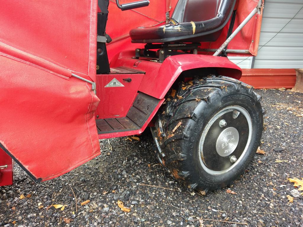

WVHillbilly520H
Hey Pete, Whatcha think of these...
peter lena
they are pretty sweet, but finding a set of those is rare, I sold off my plastic coated wheel weights, I think your flush mount weights are the way to go , very efficient and also has the look ,to enhance your tractor. pete
