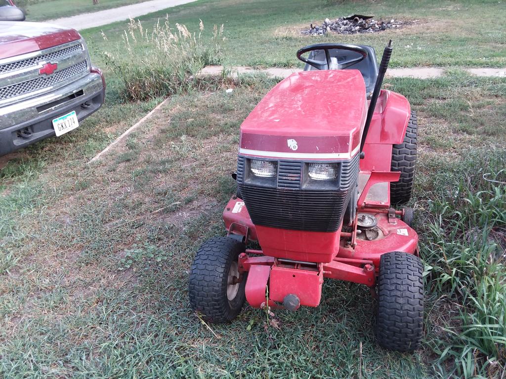

My right wheel hits my deck every time I  turn how can I fix it or adjust it ?
cleat
Do you have the deck latched properly into the Tach-A-Matic ?
Can we see a side pic. It looks like the deck hitch bar is rotated forward.
This is what cleat is thinking. The fork #2 must be around rod #5.
clueless
:text-yeahthat:
dcrage
Do you have 8” front wheels? The 37” SD deck was designed for use with 6” front wheels to alleviate the kind of issues you are having.
