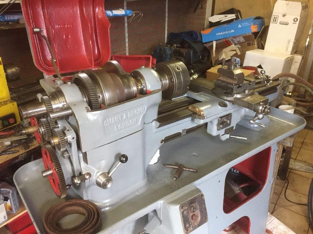

C-101plowerpower 1,606 #3 Posted July 20, 2018 i've currently got two lathes, one cheapo chinese thingy with no brand name, that one is ok ish for small work. the other one i have is a bigger and way older machine. a english made Smart & Brown model M mk1 from just after the war, got it basicly for free(did some work for my mate where i got it from) so far its not in operating condition yet as we are still restoring it 3 1 Share this post Link to post Share on other sites

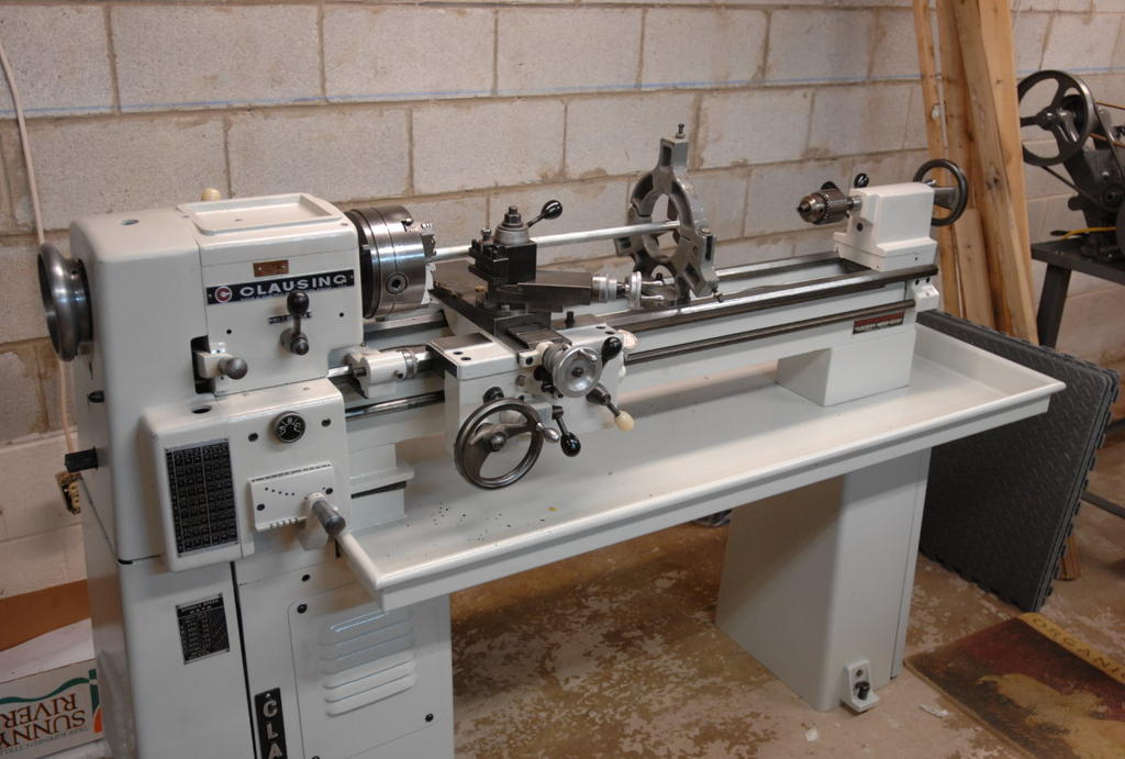

Kurt-NEPA 755 #4 Posted July 20, 2018 You always have to balance need, cost and space. For me I went with a 10" Clausing. I have about $1700 in it and so far its been big enough for everything I want it for. Would I like bigger, sure, but where will I put it. I think 9 to 12" swing is just about right for a home shop. 6 1 Share this post Link to post Share on other sites
Machineguy 877 #5 Posted July 20, 2018 25 minutes ago, Kurt-NEPA said: You always have to balance need, cost and space. For me I went with a 10" Clausing. I have about $1700 in it and so far its been big enough for everything I want it for. Would I like bigger, sure, but where will I put it. I think 9 to 12" swing is just about right for a home shop. Well said. My friend expressed the same thing to me about lathes. He suggested a Select brand if you wanted new or a used TOS or Cholchester would be safe. It’s all about cost and options. Share this post Link to post Share on other sites

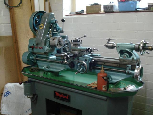

Anglo Traction 761 #6 Posted July 20, 2018 No previous experience or training. Had to learn from books and could only afford an old used machine initially just over 30 years ago. Also stuffed for size/space, so I settled for a small 1949 English Myford 3 1/2" x 20". It's tired, but renewed many parts and has produced a lot of precision parts for my Tractors and Models etc. I wish I had space for a bigger one, but happy with what this can handle. Will swing 7" over the bed ways and 10" in the gap- Machining the faces of a reduction gear unit held in a 6" 4 jaw chuck- I also have a secondhand hobby sized Milling Machine which is also a bonus in versatility. Whatever you decide on, it will open a whole new world of opportunity to make stuff. Enjoy!. 4 Share this post Link to post Share on other sites

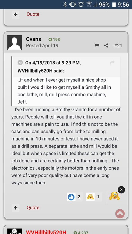

WVHillbilly520H 10,376 #7 Posted July 21, 2018 I'm really leaning towards a "3 in 1" myself mainly for a couple reasons size/space utilization, electricity needs and cost, with that being said another member (can't remember at the moment) on here replied to my thinking out loud on this very subject about buying a new SmithyBilt brand "Granite" saying that he uses them in a shop setting and they are reliable machines now, Jeff. Share this post Link to post Share on other sites

WVHillbilly520H 10,376 #12 Posted July 21, 2018 (edited) @Cvans maybe you can add more about the 3in1 machining centers...Here's the post I was referring to above...i still honestly believe if you are not taking 1/8" deep cuts at 15+IPM surface speed the mill will do what we need to do for ourselves but when time is money well yes find a 24" Bridgeport and 10-12" lathe and "hog" on the material all you want...at work I get paid by the hour not by the job so with that being said lighter cuts and slower surface speeds, gets the job done without wearing the machine out faster, Jeff. Edited July 21, 2018 by WVHillbilly520H Share this post Link to post Share on other sites
Cvans 1,009 #13 Posted July 21, 2018 I enjoy working on the lathe or mill so Hogging metal isn't necessary. One update that I can strongly advise is converting the tool holder to a Phase II. Had to make an adapter but it was easy to do and has worked out well. If you purchase one of these plan on spending at least a day cleaning, setting it up and making adjustments. Mine had been used for one small project before I purchased it and had spent years setting in a garage. Many of the boxes and tooling had never been opened. Most of the exposed metal surfaces had minor surface corrosion and needed attention. This was an early model and the motors were junk. The new motor is great and has far more torque than the original. I did make a simple sheet metal chip shield to put over the motor to keep material out of it. Milling with it is easy and to switch to milling takes very little time. Remove the chuck and tool holder then install the vice. Swing the mill over the vice and lock it and your set. The cam lock chuck is a neat feature. I have never quite figured out the down feed to the point that I'm completely comfortable with it. Milling key ways has not been a problem and all have turned out nicely. My experience with surface milling is limited and have only used the fly cutter once. I believe there is two different power options available for the Smithy Granite now. Mine is the 110v which works fine for what I'm doing. The variable speed is nice. While I have been into metal fabrication most of my life I am only a shade tree machinist. If you have any questions about the Smithy feel free to ask and I will try to help. Also from my experience the people at Smithy have been very good to work with. 1 Share this post Link to post Share on other sites
WVHillbilly520H 10,376 #14 Posted July 21, 2018 @Cvans, many thanks to you for your input/opinion on this particular machining center, I see that they are both 110/220 volt selectable anything above would require 3 phase or a "phase converter", BTW I'm not formally trained either all OTJ. 1 Share this post Link to post Share on other sites
