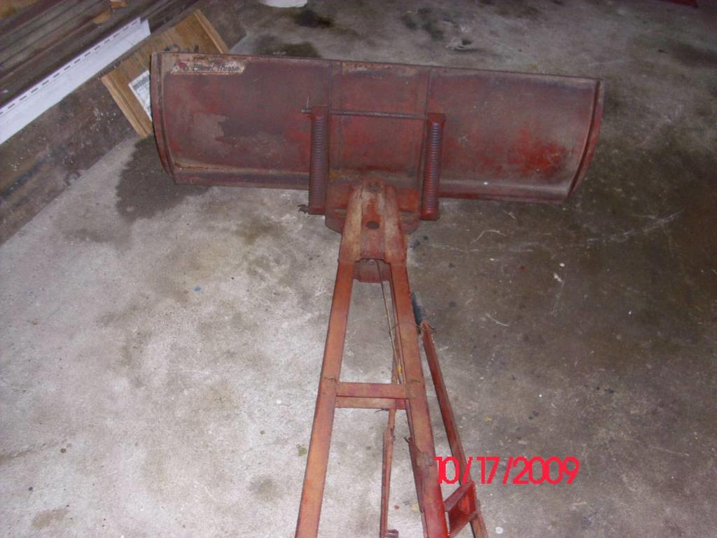

wildfire305 58 #1 Posted July 16, 2018 Can anyone tell me if this is the right plow for a 310-8? Share this post Link to post Share on other sites

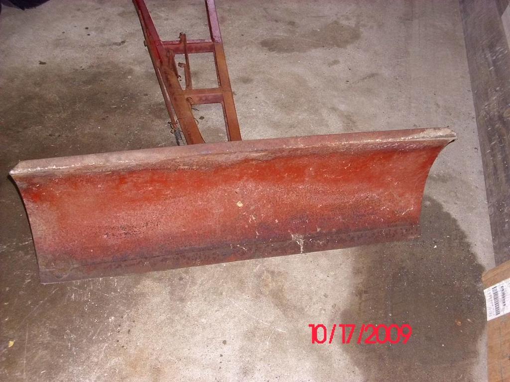

wildfire305 58 #2 Posted July 16, 2018 Bigger image quality Share this post Link to post Share on other sites
Ed Kennell 40,188 #3 Posted July 16, 2018 That looks like a frame for a short frame tractor. The 300 series has a long frame. Share this post Link to post Share on other sites
wildfire305 58 #4 Posted July 16, 2018 Is that long attachment plate / rod thing in the center a dead giveaway? Should I be looking for one with a short plate? Could someone please post a a link or pictures of the correct one? When I ask folks on Craigslist , they never seem to know what they have or what it came from, or how old it is. I'm basically looking for a measurement that I could have them take so that I might know right away if it would work on mine or not. Share this post Link to post Share on other sites

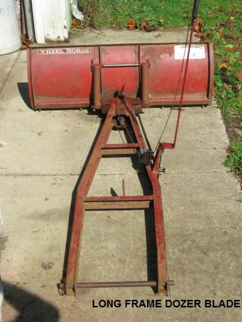

daveoman1966 3,788 #5 Posted July 16, 2018 That is a short-frame dozer blade. You need one like this...axle bracket is also required. Note the difference in the shape of the A-frame. 2 Share this post Link to post Share on other sites

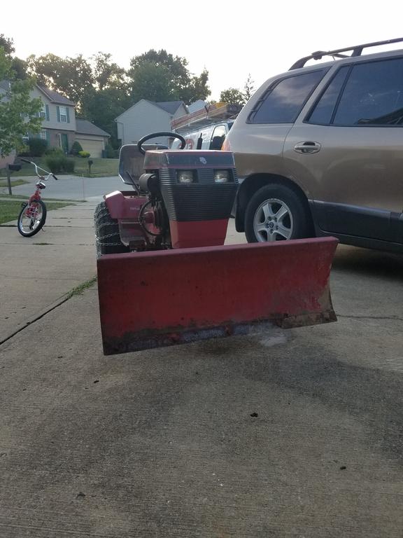

wildfire305 58 #9 Posted July 18, 2018 New vac mfg. Brand with axle brackets. Looks like it's only seen a few seasons. Here it is mounted on my steed. 2 2 Share this post Link to post Share on other sites
