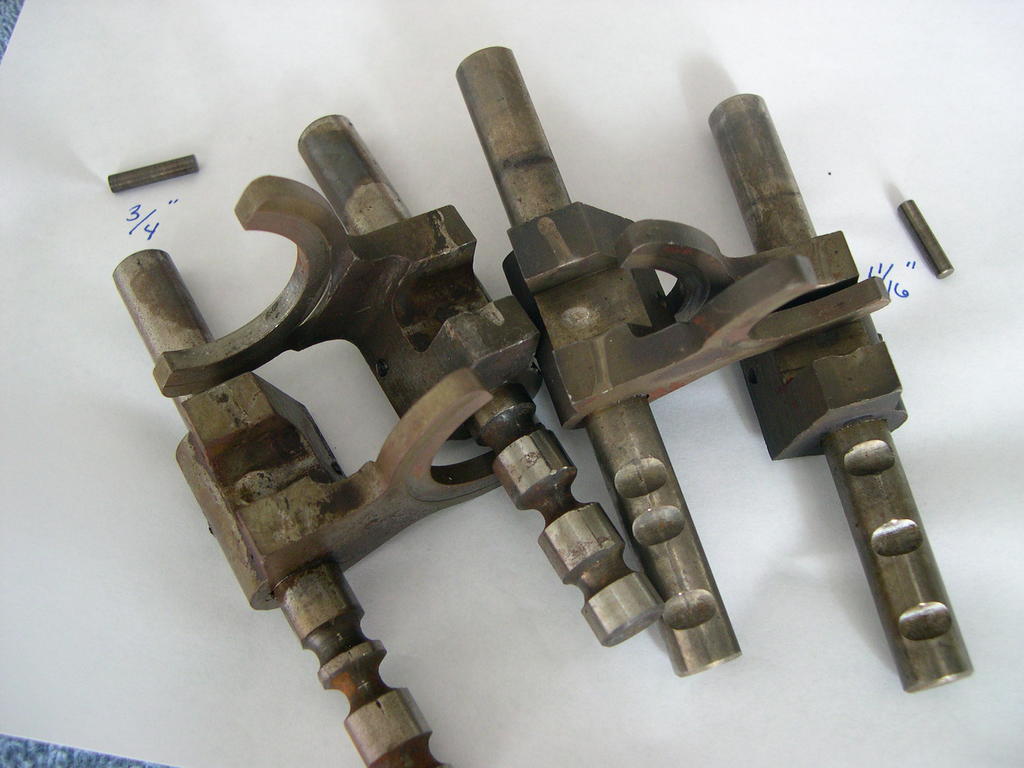

thanks for the quick and helpful replies  I will let you know it goes , I have a couple of new balls  same size as originals and original spring but doesn't seem to do deep enough to push the second selector in , but no doubt we will master it , The drawing shows a pin in there  which we don't have , whats the purpose  of that ?
regards Phil
The pin keeps the two forks from being able to engage at the same time.
It keeps the balls a certain distance apart thereby only one at a time can be in a groove on a shaft.
Racinbob
Pretty much what Eric said. The pin on yours will be 3/4" long. The center detent on the shift rails will be deeper than the outer detents. In order for the shift rail to be moved side to side one of the balls must be in the deeper center neutral detent. The detents on the older style shift rails were all the same depth and the stop pin was 11/16". The change came about back in the mid 60's. :)

The 11/16" pin can be used in any of them. The 3/4" pin can only be used if the neutral detent is deeper. Ignore the fact that the detents go all the way around the rail. They also made them that look like the older style with the neutral groove being deeper. It likely was just a change in the manufacturing process when they switched to the detents that went all the way around. As I said, the 11/16" pin can be used with any rails but you'll defeat the purpose of them. The design is such that with the 3/4" pin one of the balls must be in a deeper detent before the rails can be moved. The idea is to prevent the shifter from locking up in two gears. :)

I have managed to put the selectors in by grinding a small taper on the one  side . Now I know that the pin is 3/4 long I will make one

You really shouldn't have to do that but it can't hurt. One thing I forgot to mention is that the first ball that you put in will be against the 3rd/2nd rail (the one to the rear). You need to make sure it's seated in the neutral detent or it will not push in far enough for the rail to clear the second ball.  I use a small allen wrench to push the second ball into the hole then push the 1st/rev rail in forcing the wrench to the side of the hole then just pull it out. The rail will be far enough to hold the ball captive. That being said I still have a few 1/4" balls that escaped scattered around the garage. :rolleyes:

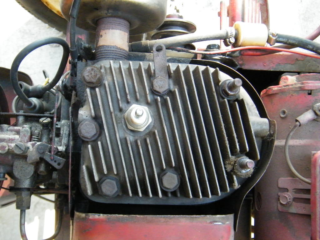

Right Mark...it was a guess on my part using the US list as a guide.  Over here...all of the 10 hsp horses around the mid-70's have the 8 speed transmission.  The 8 hsp horses have the 4 speed.  Phil did not say what size engine he has...we could find out by counting the head bolts.  :)  Here is the head bolt arrangement of the K-181   8hsp Kohler.
Phil Burley
Hello , the head on my Kohler  has 9 studs , It has no numbers anywhere , What HP does that make it ? We have got the gearbox together on the  bench , but *** seems to jump out of top gear unless you hold the gear lever over , is there any bodge we can do to improve that , it probably wont matter much because if we can get it running it will only be a bit of a toy to run round our paddock which is a bit hilly  so  low gear will  be in use I should think .

Bob is correct...the block is the same for the 10, 12 and 14.  I would think Mark is right...10 hsp K-241-S with the 4 speed transmission if the engine is original.

When we have the engine running ( it needs a valve grind badly , ) we can decide if its worth spending cash on . The engine is 2 ,3/4 bore  by 2 ,7/8 stroke , I make that about 24 cu inch , which HP is that ?
