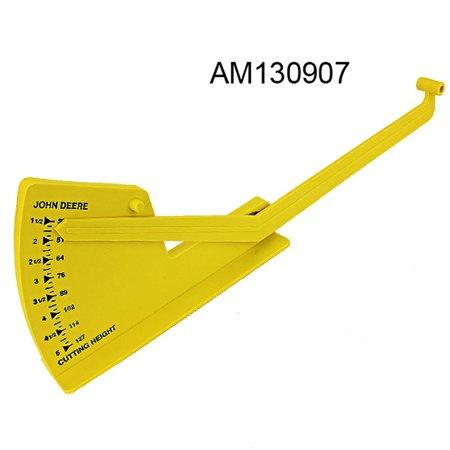

shallowwatersailor
Try one of these. They are available from Oregon, JD, Stens, and probably others.
