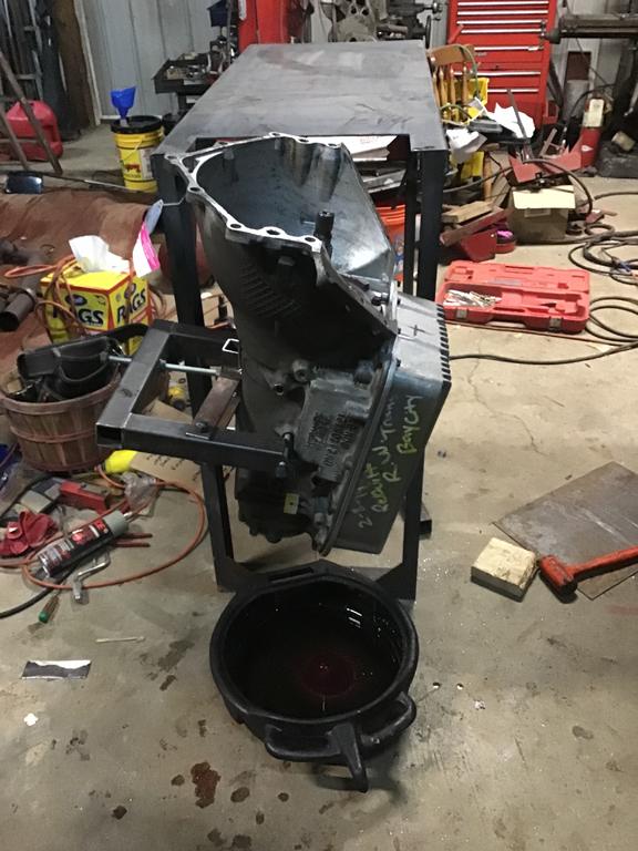

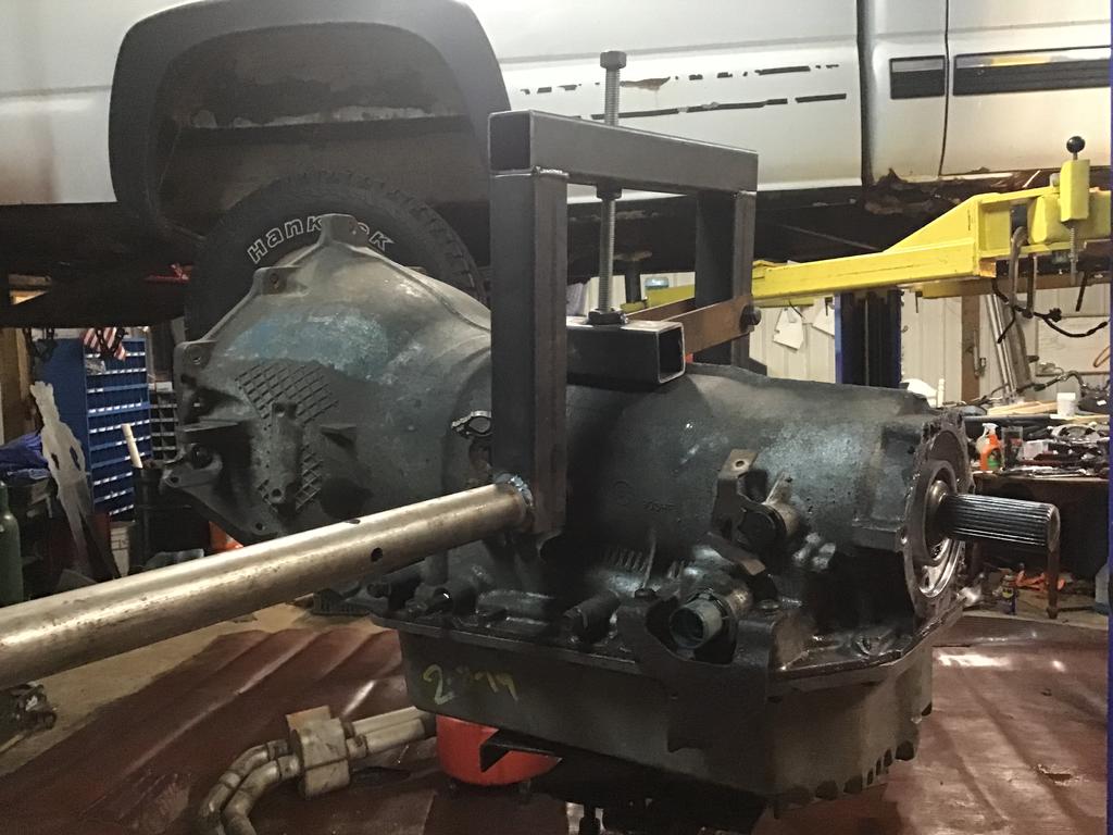

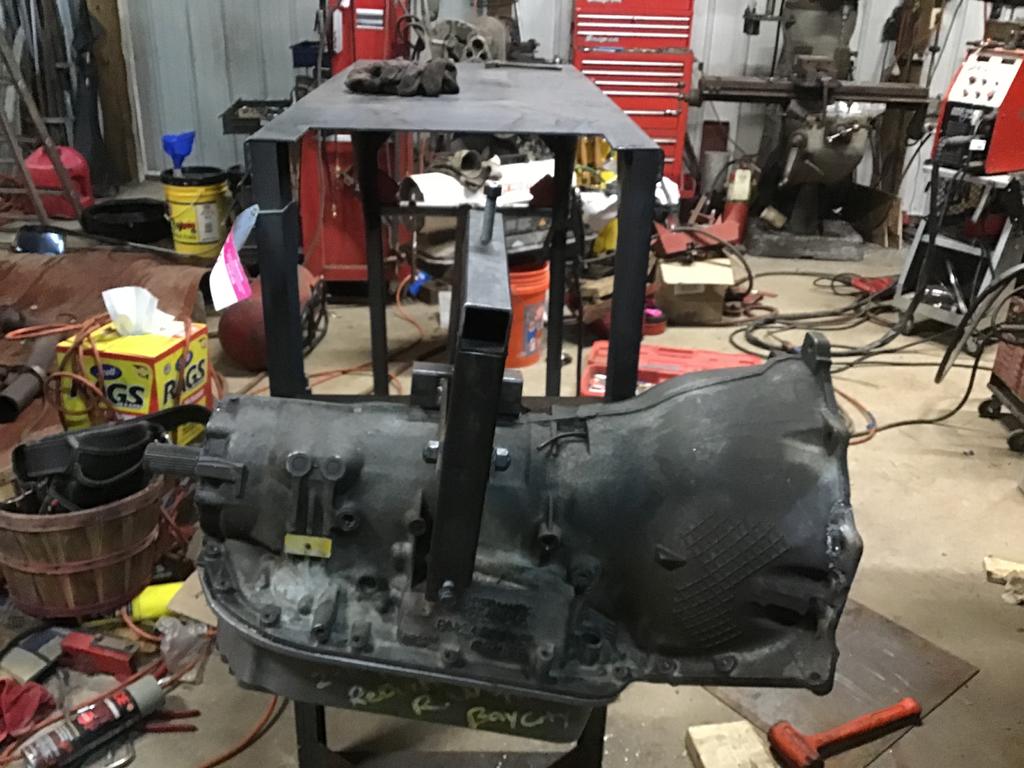

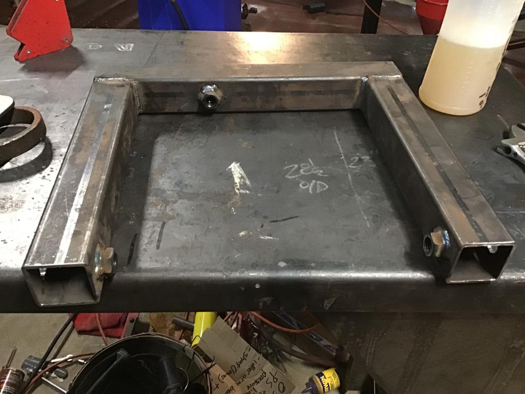

Well, this’ll work, just need to do work to get it in the case!

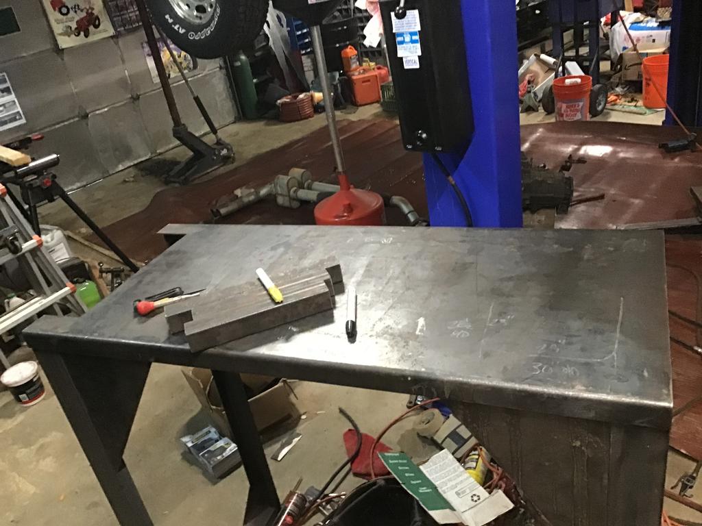

And....  WOW!!!!  A WORK SURFACE!!!!

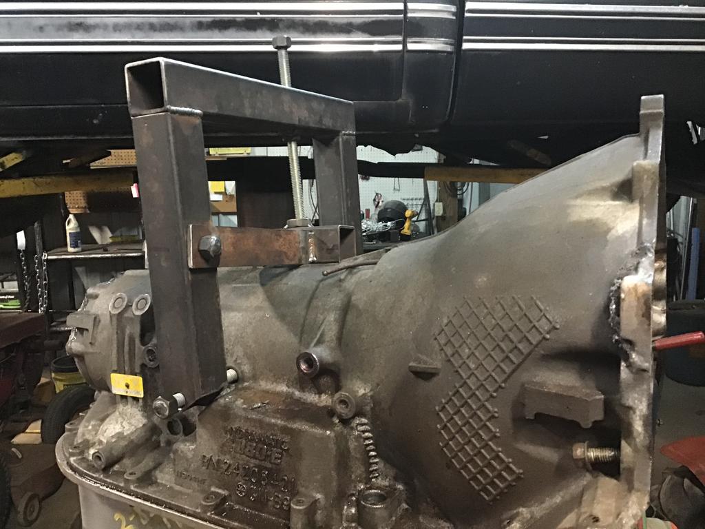

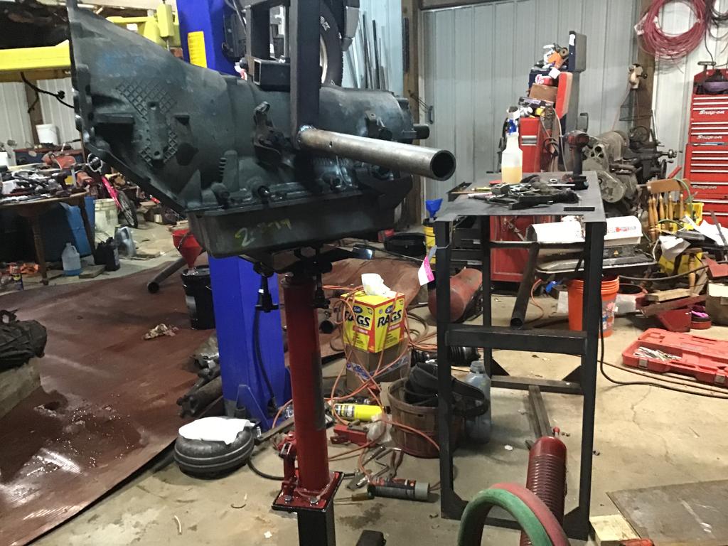

I just need to build one of those fancy transmission holder brackets, and we’ll be in rebuild business!
Stage 1 of my bench mount is nearing completion.
The bench mount is finished, trans is ready for tear down!  That sucker is heavy!  Eric, is Trina available to come help me lift it onto the jack in a few days?  :ROTF:

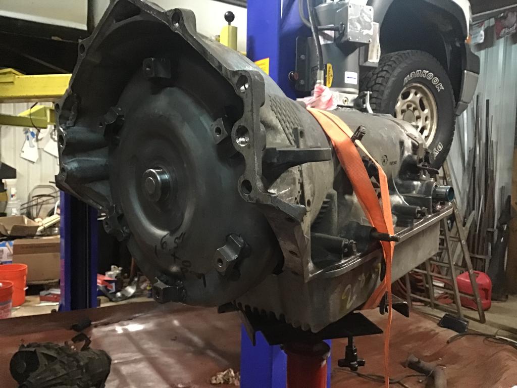

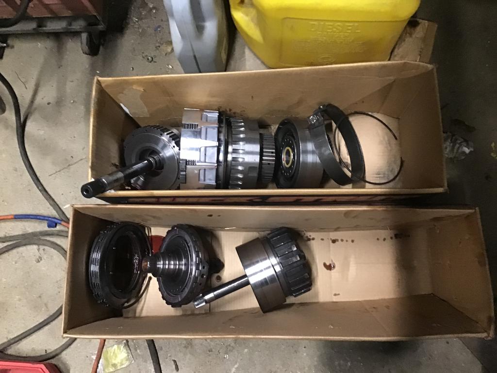

That’s a hard break!  All my parts are in line, waiting to go back together.
The first (and only) automatic transmission I rebuilt I had a 30 foot strip of plastic on the floor and laid all the parts out in the proper order and facing in the correct direction. It was a Chevy 350 Turbo Hydramatic and I am happy to report that everything went together well. I have put over 100K on it and is going strong.                :auto-layrubber:
Hope yours is just as successful.       :handgestures-thumbupright:
Soon to find out, Richard!  It’s ready for install, once again.

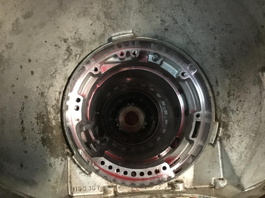

One of the most effective automatic transmission mounts for rebuilds I've seen yet is a steel 55-gallon barrel. Does two jobs - holds the case firmly and gives a place for all the fluid to go in one unit. One of the rebuild shops I visited had a frame welded on top of a steel drum with different adapter plates to fit different case types -  it worked pretty slick and provided full access to every part needed.

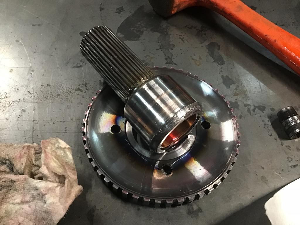

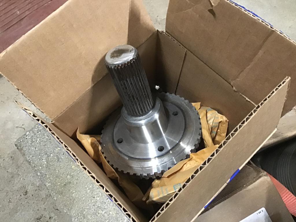

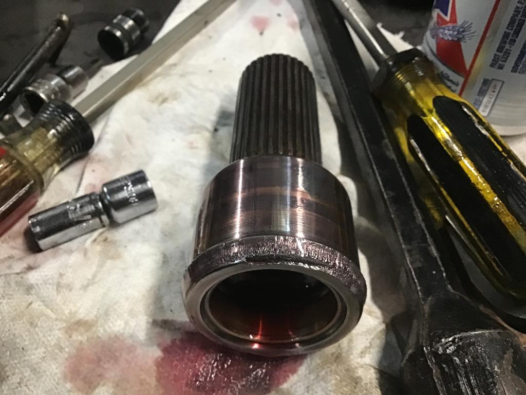

I'd wonder when that shaft let go - did it dump any fragments or filings into the valve body? I know the older 700R4 units were famous for plugging up circuits and contaminating themselves to the point of failure - we swapped out a ton of those in the old diesel shop when I worked there. I got it down to 25 minutes to rip one out after getting the vehicle up on stands - farmers around here could destroy one of those easily in that first generation.

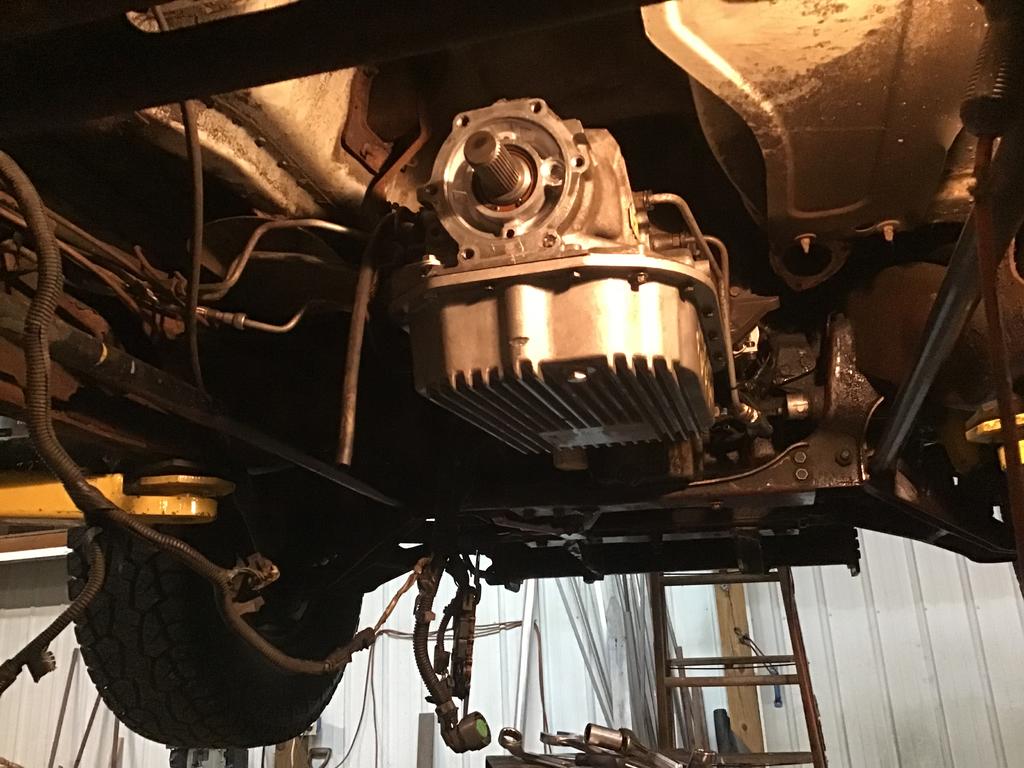

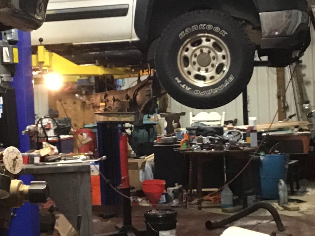

Getting somewhere..... again....
She drives again!
  • Excellent 3
27 minutes ago, pullstart said:
She drives again!
:woohoo:                                        :auto-layrubber:                                   :happy-jumpeveryone:

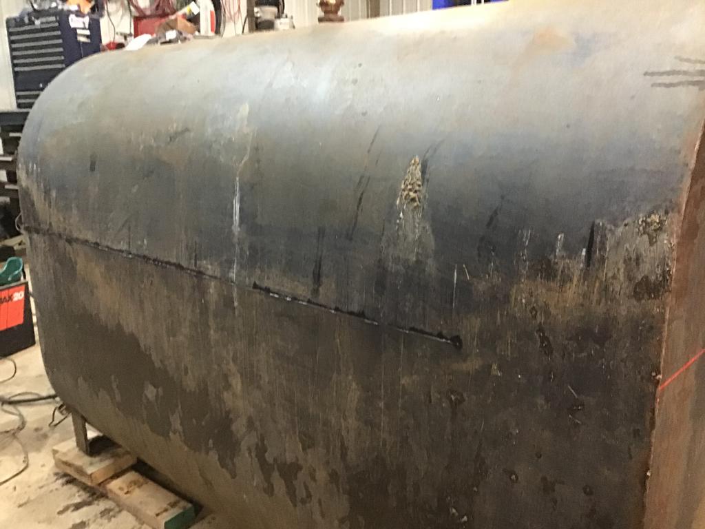

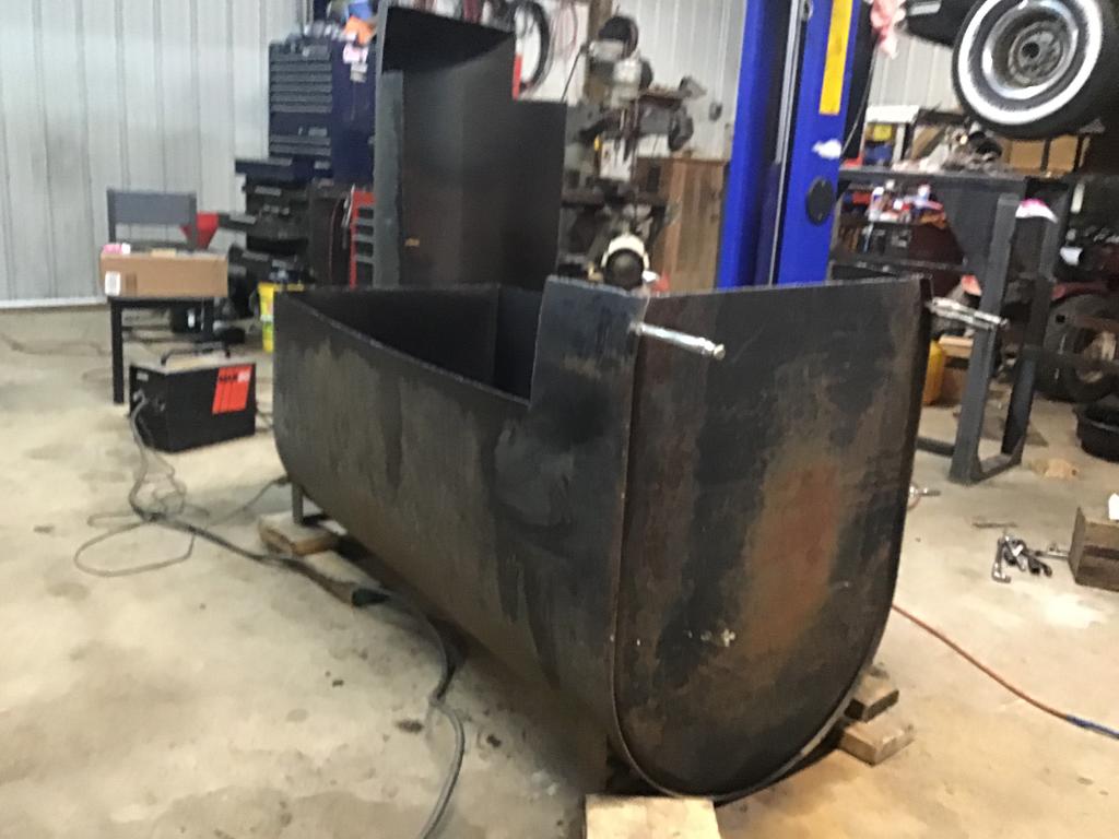

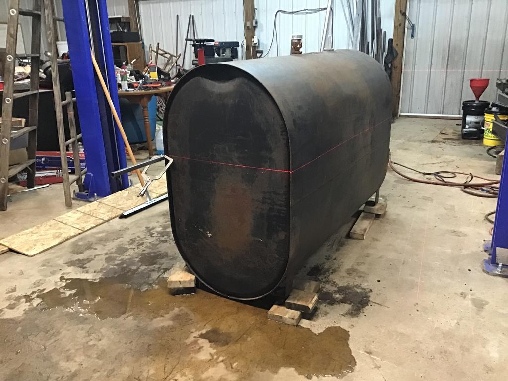

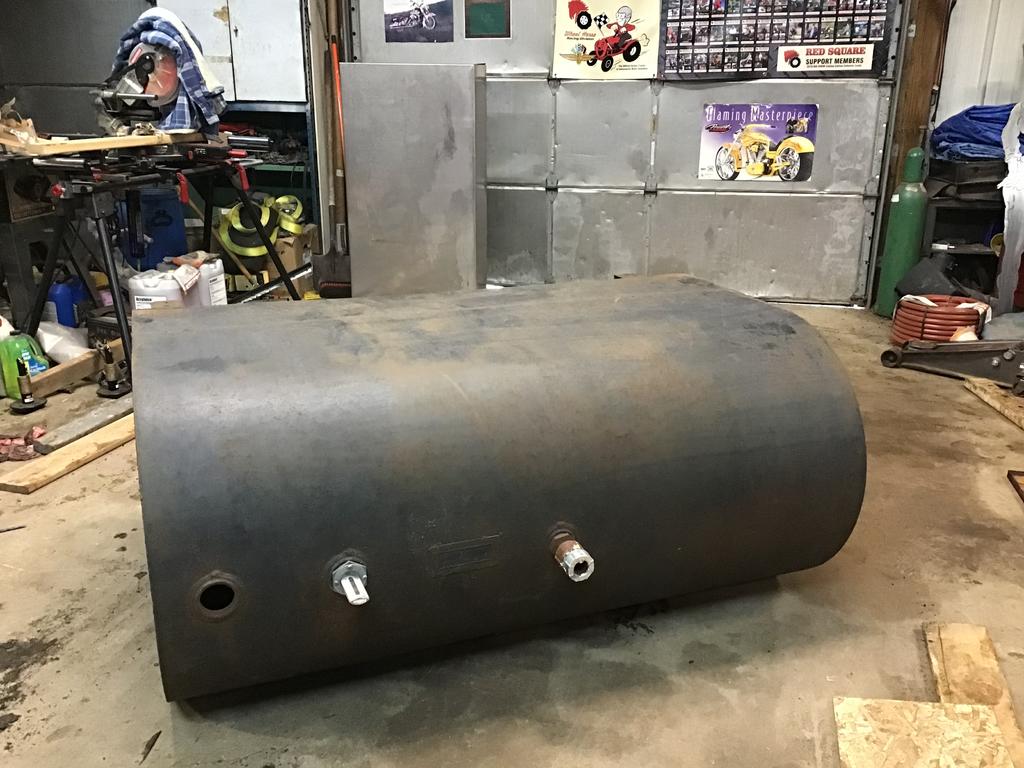

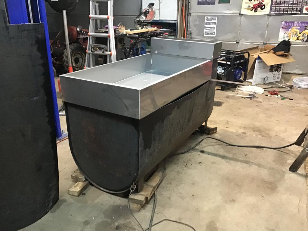

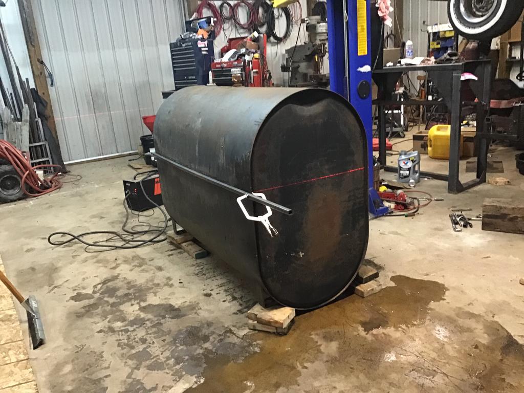

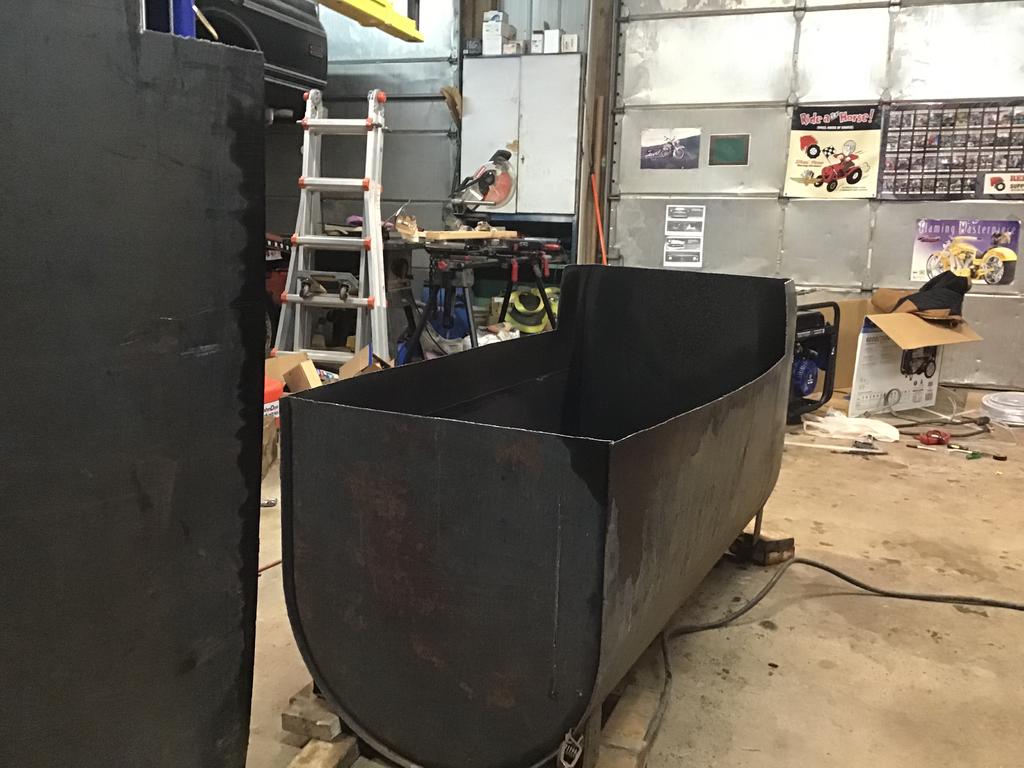

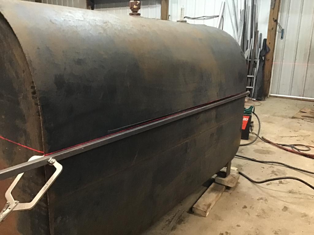

On to fun stuff!  Today’s project: maple syrup machine!  We’ve done it most of the kids’ lives, shy of the last two seasons due to moving, etc.  We’re usually good for about 4 gallons of syrup.  This year, a buddy has 7 acres of maples we plan to sugar off but I sold my last two evaporators preparing for the move.  Now, maple season is knocking on our door and it’s time to get ready.
The fuel oil barrel is a pretty good start of a fire box.  The stainless pan in the background will be baffled instead of doing the poor man’s buffet steam pan transfer method.  Hopefully we will over double our 4 gallon marks of the past, so my buddy and I can split the tastiness.

Some rough cut updates on the maple syrup machine:
