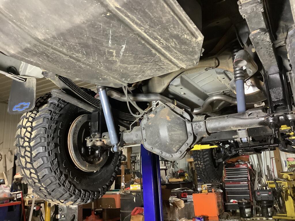

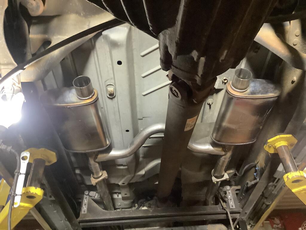

I have about 5’ of tubing on each side run so far, along with O2 sensors installed.  I found a bad donut gasket and ran out of 75/25 gas for the welder last night.  I must’a been working too hard, never took a single picture!  I’m tempted to fire it up sans mufflers this morning… just to see how awesome it can be!

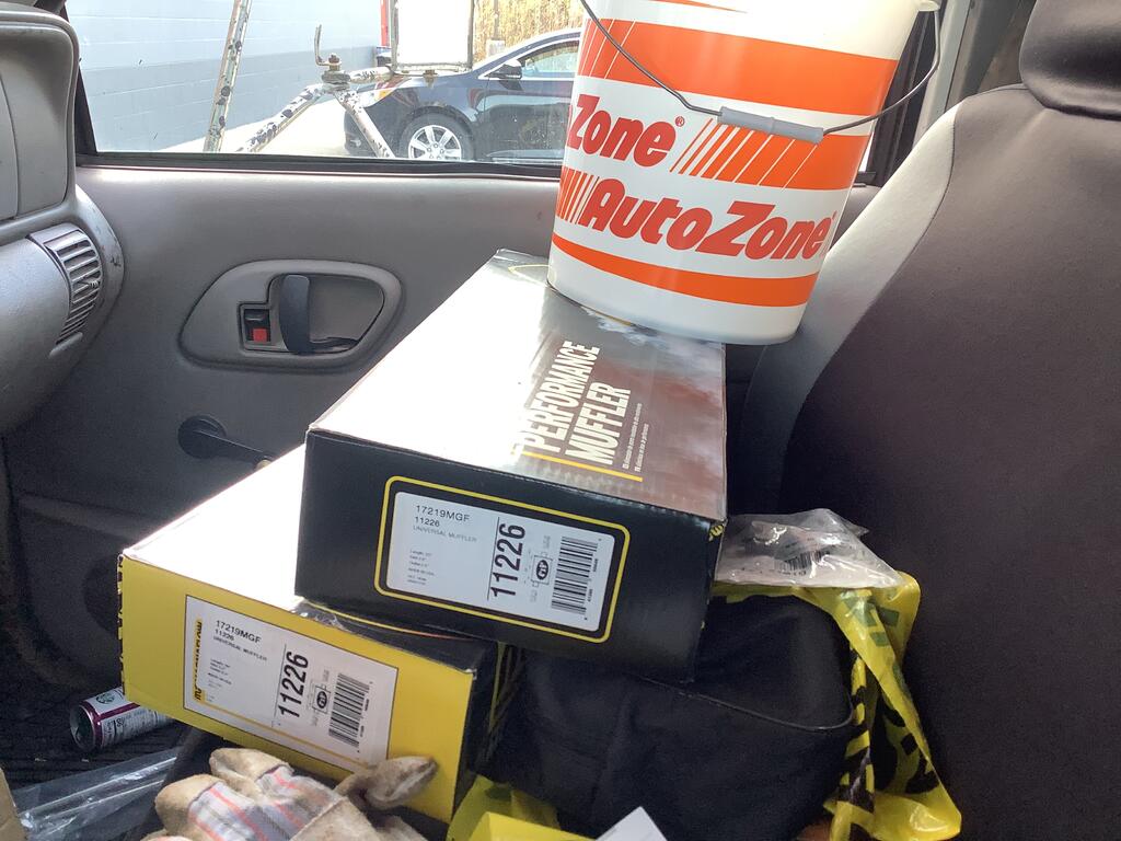

Found some mufflers and a bucket to soak my turkey @Achto!
Achto
Those Magna Flow 2 1/2" should give that truck a nice low tone rumble. :handgestures-thumbupright:
Looking forward to hearing how your turkey turns out.

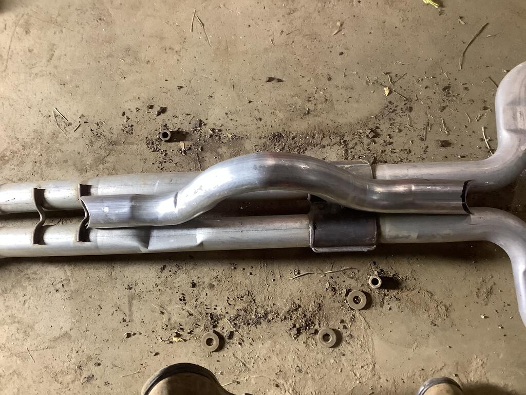

Thanks to some friendly advise from Dan, I made an H pipe and have it mostly welded in.
The stock “new Camaro” exhaust that I brought inside was meant to be used for parts, if needed.  So far, it’s a great tubing holder!
Achto
That "H" pipe cross over should reduce interior noise and also buy you some low end torque (which you'll want to get those big meats rolling) :thumbs2: Fantastic work !!

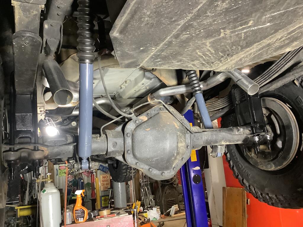

To Do’s getting shorter, truck’s getting louder.  Exhaust is complete.
Achto
Not to be a Sally, but aren't you worried about exhaust coming into the cabin if you get stuck in traffic?
I see Rain Ex on the list. Are you going through the work of applying it to the windshield or just putting the Rain Ex washer fluid in? I run the Rain Ex washer fluid, only have to clean the windshield a few times to get the rain to bead up & roll off.
Edited by Achto
Good point Dan.  There’s plenty of airflow underneath the truck body… or should it go higher?  :lol:  All seriousness though, I don’t see that being an issue on most days, with her 3 mile trip to work each way.  With it being past the axle and at a 45 down, I ASSUME (we all know throw that goes) that the gasses will be well on their way past the bumper.  Now that I’ve figured out how to run the tube bender pretty decent, I can always push the length of tube further out if need be.
