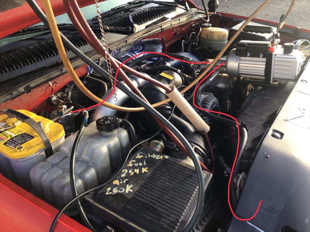

@squonk how do I know what is oil loss and what was residual refrigerant in the system?  When the pump was leaking originally, it had an oily texture to the liquid.  When the system was disconnected, a freezing liquid came out, bubbling on anything it touched.  The pump has been replaced, but I am not sure how much oil came out first.  Just the pump and lines (in red) from the condenser and coil to the pump were replaced.
If you just uncorked it, yes you lost some oil. The compressor should have stated if it had oil in it when it was replaced. If it was a used one, it probably had enough oil in it. If the compressor was dry before installation you need to remove it and add the correct amount of oil to the compressor and turn it by hand to get all the oil thru it. Look at your refrigerant sticker under the hood. It probably says like 8oz oil charge. If the compressor is dry add 4oz to it and 2oz for the lines. If the system takes more or less adjust levels accordingly. This should put you in the ballpark. Evacuating the system with the vacuum pump will not remove any oil.
I more thing. It would probably be a good idea to change your orifice tube. Look at the smaller ac line coming from your fire wall for a connection and a crimped pipe. It may be all the way to the condenser. That's were it will be. If it's original it may be filled with junk.

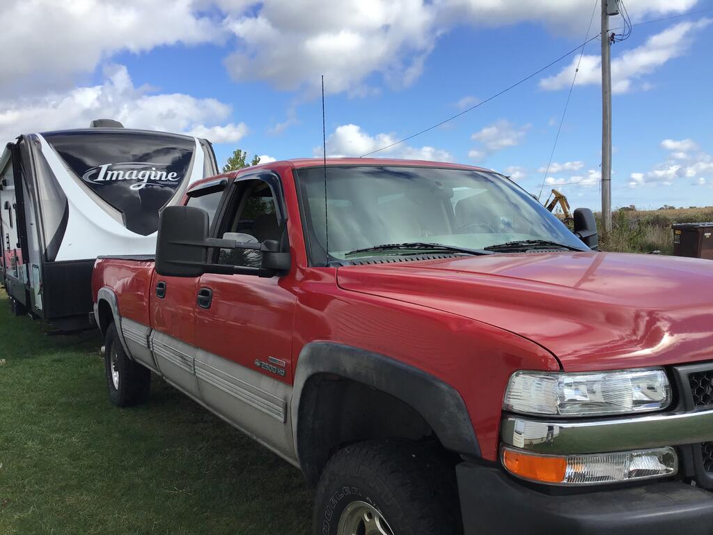

11.28 mpg hauling the camp rig... close to 10k lbs!  That’s about 1 mpg improvement and I’m guessing it’s due to turbocharger and airflow modification!
  • Excellent 6
SylvanLakeWH
That ain’t bad...! Not bad at all...
No issues running? All good?
I was a little low on coolant this morning but it could have been an air bubble.  I’ll watch it :handgestures-thumbupright:

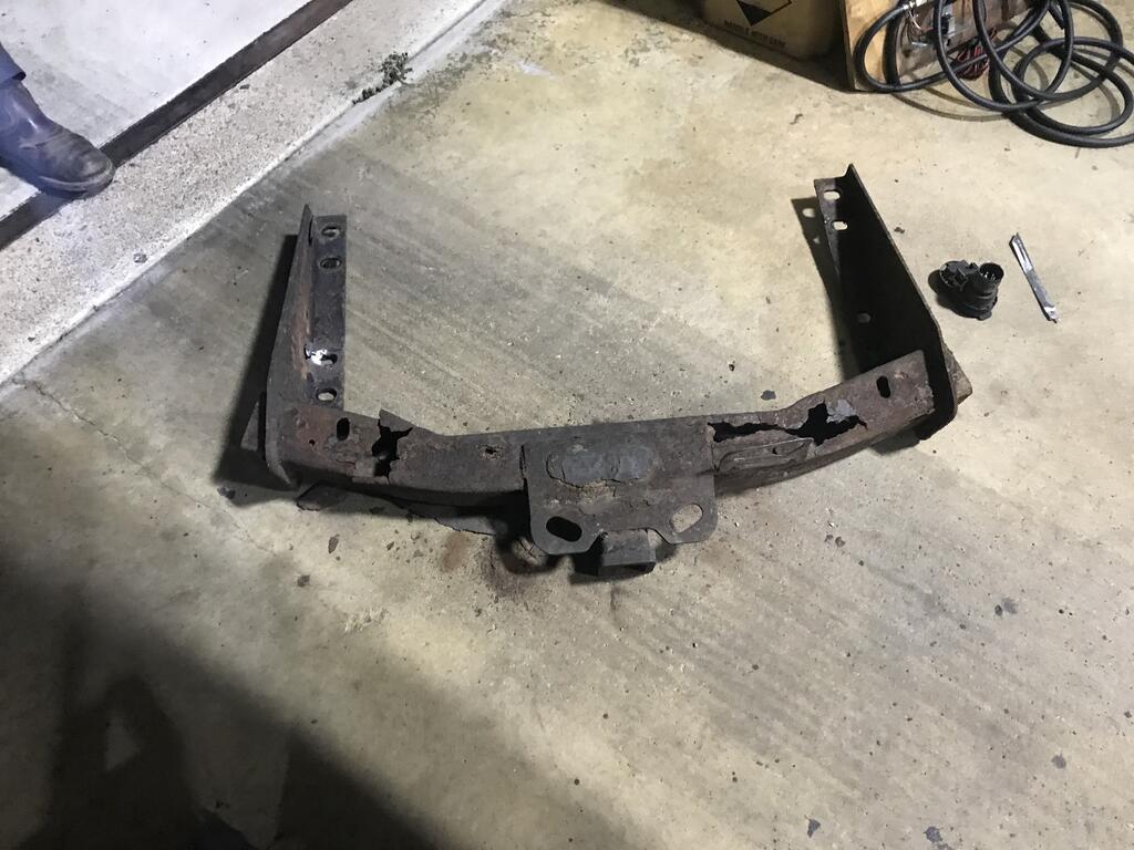

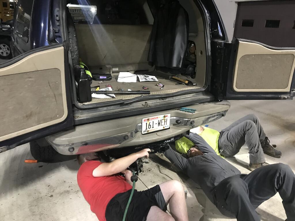

A couple of mechanics from the church we are currently at in Dayton, OH area agreed to install my new trailer hitch on the Excursion!  What a production!
18 years in the salt belt and this factory receiver was JUNK!  Completely rotted on all four sides and removal of the six bolts was challenging but nothing compared to the final two—warning to anyone needing to change their Excursion receiver hitch!
The Feds determined that the Excursion fell under the station wagon category and because of its 44 gallon fuel tank in the back, they didn’t want the vehicle ever driven without the receiver since it was a protection from a rear impact collision.  I guess they figured it would help to keep from an impact explosion on a gasser.  Anyway, two of the bolts have round heads.  We didn’t realize this when we started to take it apart.  The most efficient way to do it would be to drop the fuel tank out, heat those two bolts and spin out with a pipe wrench.  In our case, we used a Sawzall and about 4 blades through the grade 10.9 bolts!
The installation only took about 25 minutes once the old rusty one was out!  Many thanks to those guys for tackling a rusty nasty project👍🏻👏🏻

14 minutes ago, PeacemakerJack said:
That hitch looks fine ! Just needs a little metal, that's all.:lol:
  • Haha 6
PeacemakerJack
:text-yeahthat: I should’ve weighed it Dan—it was probably 25% lighter than the new one!😂
