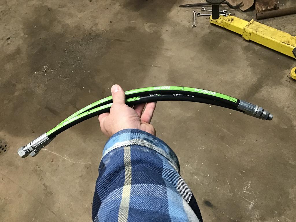

I picked up the new lines, they set me back like 34 bucks.  Not bad in my mind!
Tractorhead
You made it Buddy, i ain‘t doubt.
The price is nice, compared to here.
I have found a hydraulic Store not too far from my Site,
they offer me „designed line“ with my given fittings for 15€ at a meter, each meter up will be 2€ More.
Emergency value was 5€, extremely fair prices as i find.
The best is, i can Wait for my lines, or i ordered by phone and grab it, if i ride along.
Before i thinkin about, to buy myself a hydraulic hose press,
but to compensate that price, i must press a lot of fittings
and after i found that Guy, i waste that idea.

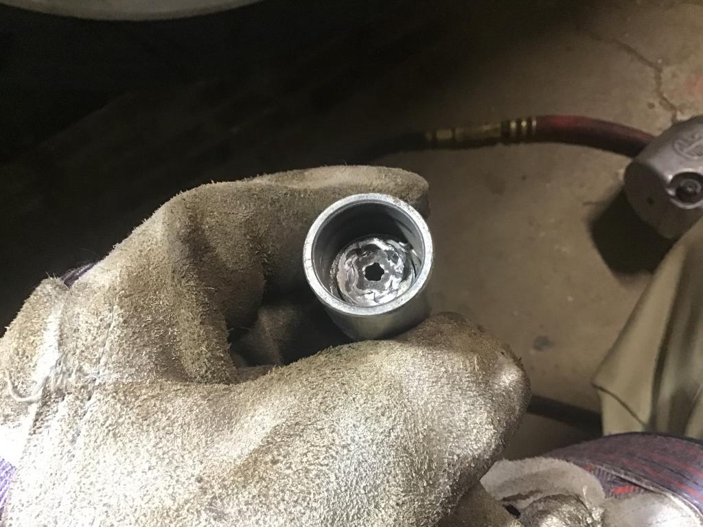

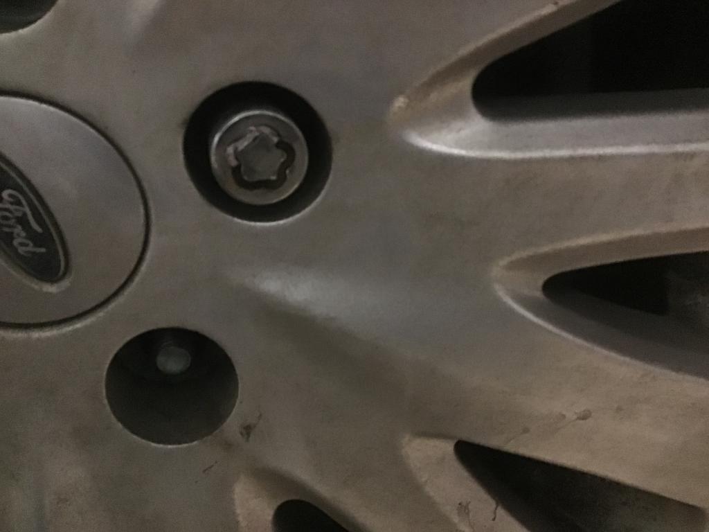

Hey Bryce @Professor1990 have you ever run into this issue?  This safety lug key sheared off on my wife’s bosses car!  I’m trying to figure out what to do to get the wheels off to do a brake job.  The key has a code, I thought maybe I should call McCard and hope the key can be replaced with the serial number?
  • Confused 1
  • Sad 2
ClassicTractorProfessor
@pullstart I have not, however you should be able to order a replacement with that code I would think...main problem we run into is people losing the key
I’ll try that, before beating a perfectly good 12 point over them!

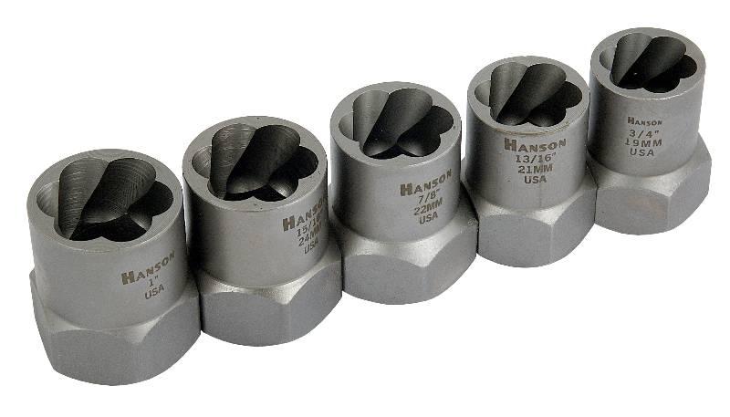

Do you have a set of these? I've had pretty good luck removing them that way...of course is sacrifices the lock...but ive found it's the easiest way to remove them without the key
No, what are they called... where do you get them?  They are rusted enough that a new set isn’t a terrible idea.  Truth be told, I could probably buy a new set of locks locally cheaper than a replacement key plus shipping!
I'm not real sure what the technical name for them is...I call them overshots...just Google damaged but remover and you'll find them...I ordered the set I've got off Amazon, but any place that sells tools should have them or be able to get them for you. Very handy tool that I wouldn't be without
adsm08
Turbo socket, round off socket, they have a couple names.
Advance sells a lock remover that is basically a tapered left-handed die with a square drive on the end. Looks like this:
Mcgaurd may not be able to get a key based off that code, but the dealer can. Also, when dealing with locking lug nuts the lock should be the first one off and the last one on, after all the others are torqued. You already found out why.
Edited by adsm08
  • Thanks 2
@pullstart if you have a connection to a tire shop they'll tell you how to get them or even order a set for you.
I've seen them in the past with 3 teeth in them.
Different sizes in a set like the pic above.

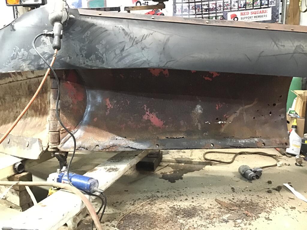

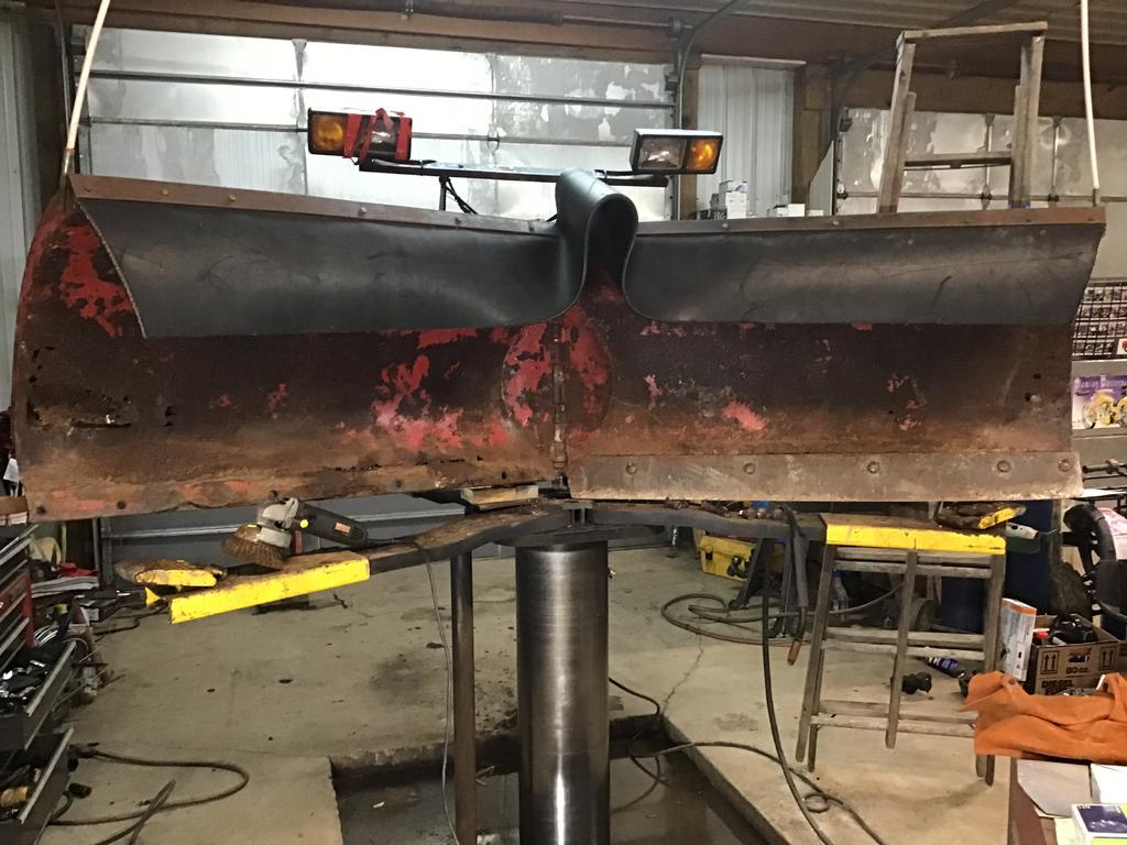

On 11/11/2018 at 10:47 PM, pullstart said:

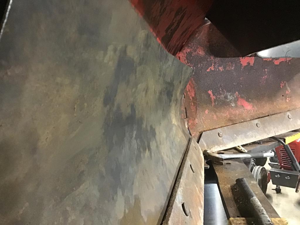

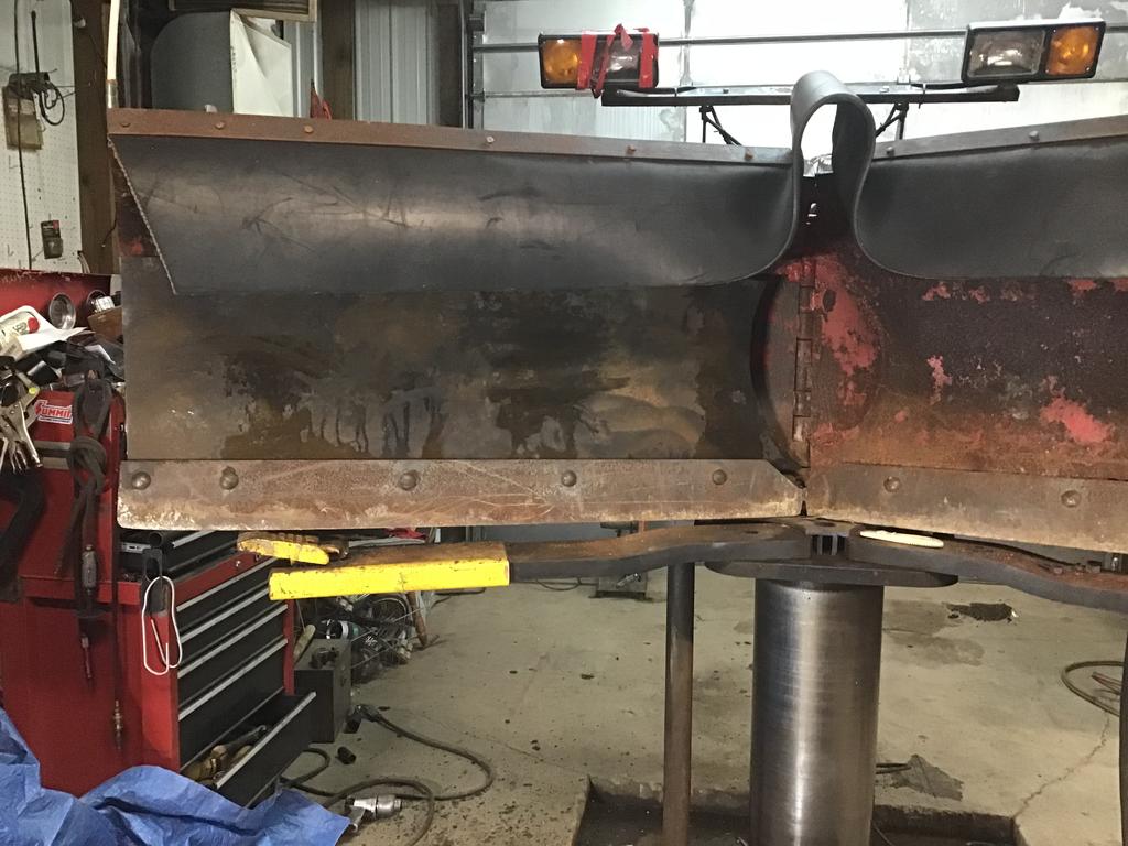

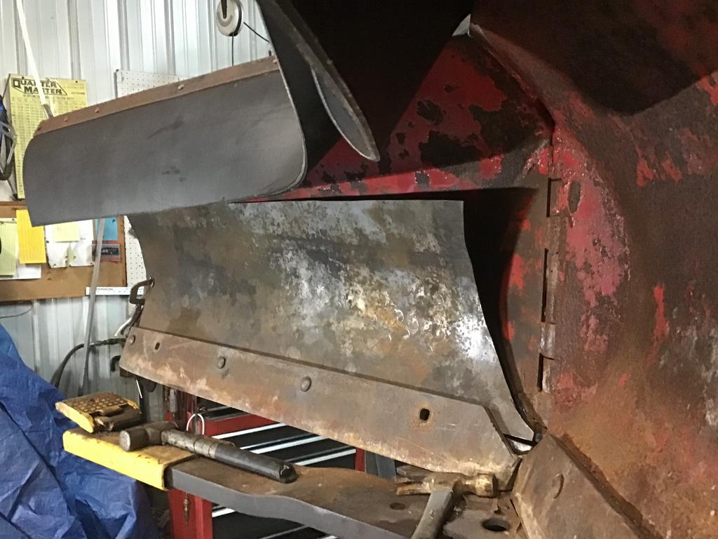

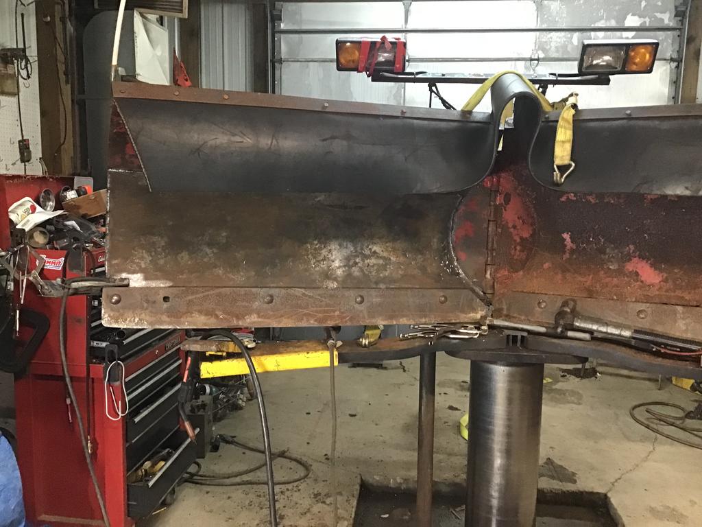

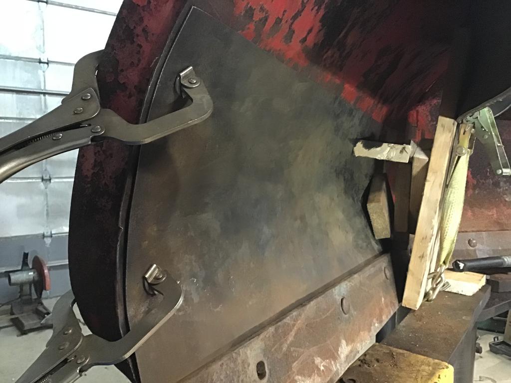

Re-skinned half of my V plow tonight.  The other side will likely come next.  The structure of the plow is intact, but I’m tired of being able to see through the plow in so many spots!  I formed the skin with a 2x4 and a big hammer, then used clamps and 2 by wedges to snug it up.

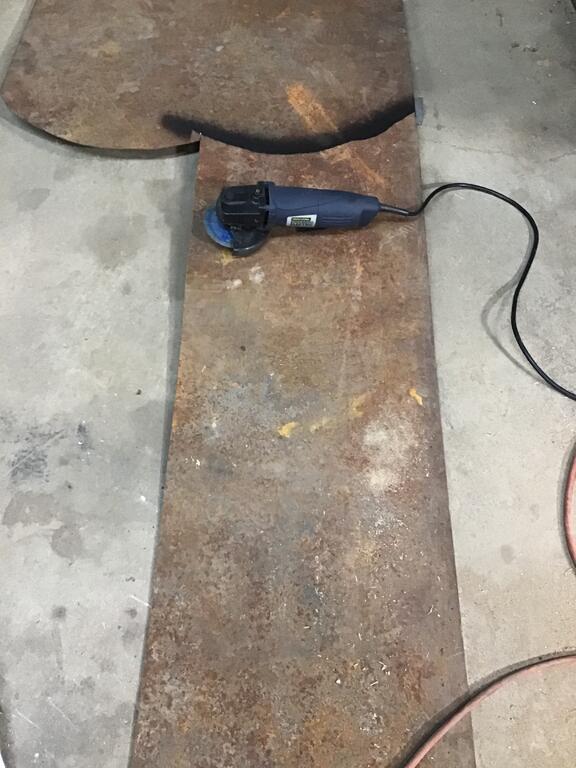

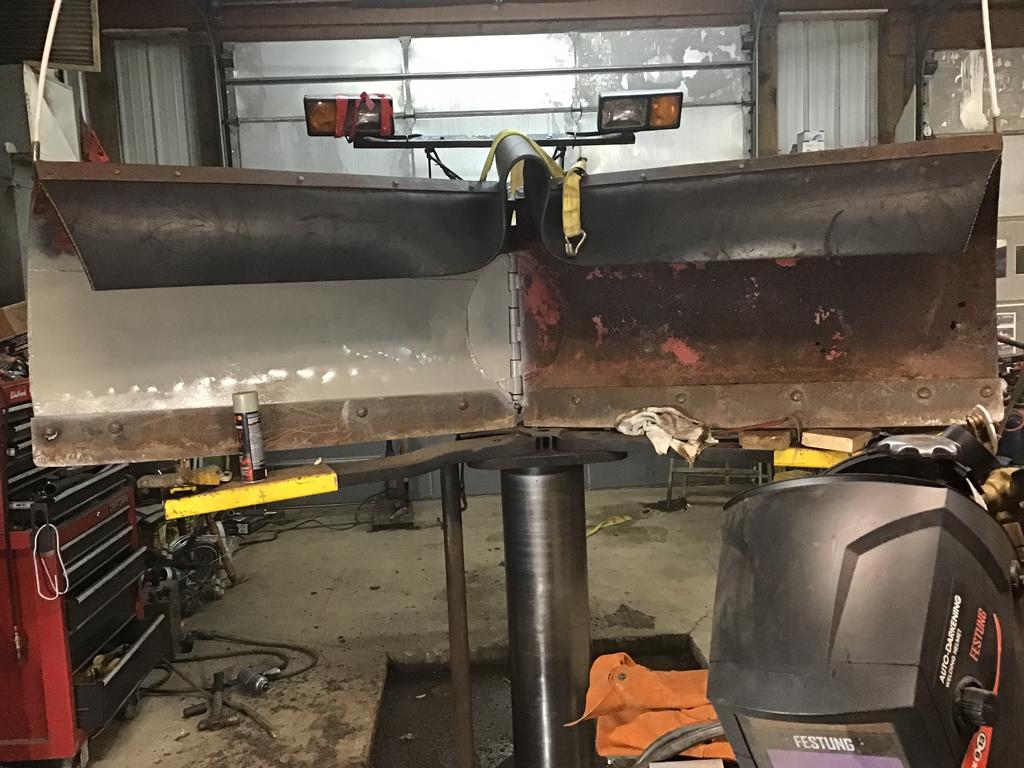

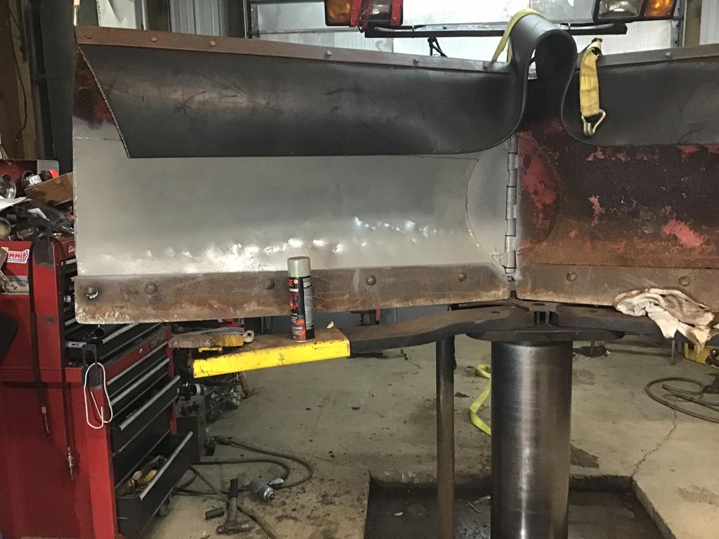

it’s been a little while.  Yep, I’m doing the other side, just in time to sell the truck!  I’ll wire wheel the plow, prime and paint it before getting it on the truck and out to the road.
Got my PPE on!  Shorts and boots man!
  • Heart 1
It’s 90 and humid today.  Perfect weather for a leather jacket and welding hood!  The shop has A/C but it is still probably 82 in there maybe?
