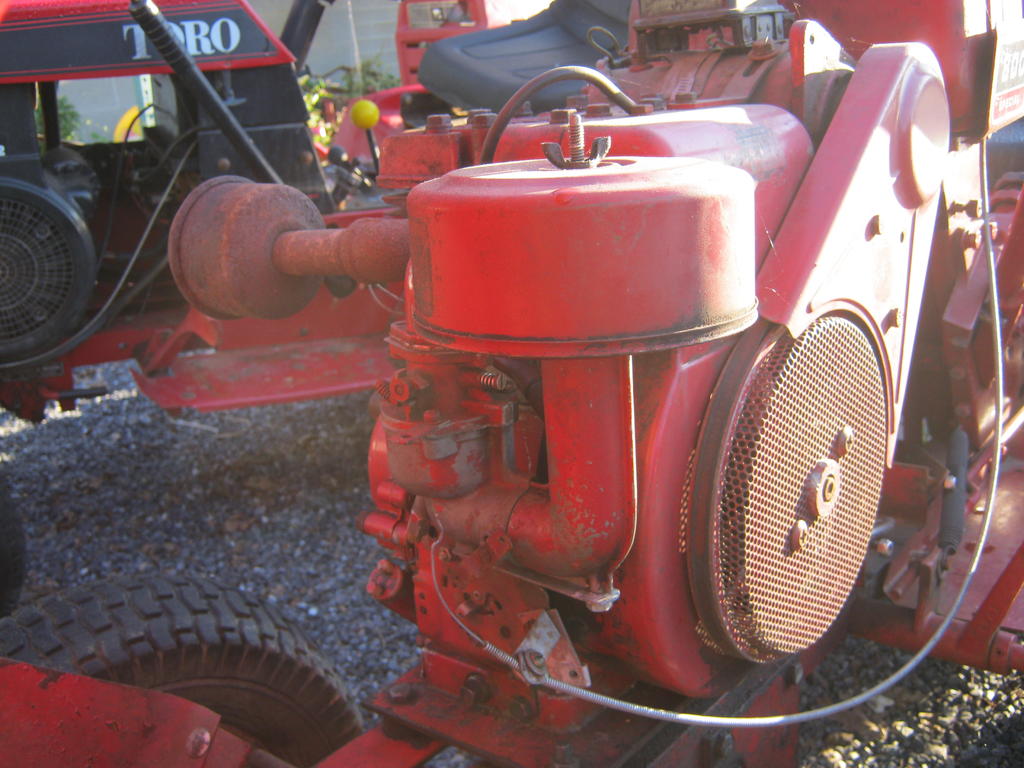

This is not my engine but this is the air filter assembly I'm going to use.
Given the fact that the air filter is nearly even with the top of the engine, and the fact that the air filter sticks out past the side of the engine, I may have to do some creative piping in order to set this up. I won't be able to put any pics of that up for a few days but I'll certainly post them here.
