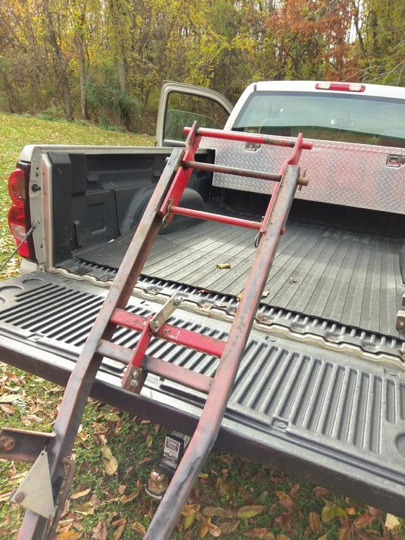

Hello all,
Would a snowplow on a B80 work on a 520h?  I have the chance to purchase the plow for my 520h....but its being used on a b80 and want to make sure it will work.

You will need the extension if your 520 has the swept forward axle...
1990 and newer...This is what it looks like.

If your 520-H is an '88 or '89 (motion lever between your legs instead of on the steering column) it will be fine. You may need to change the sector lever.
