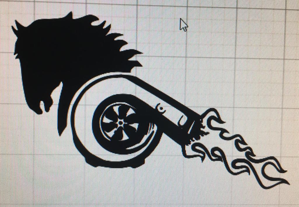

I was working on a couple of cup decals and threw it together

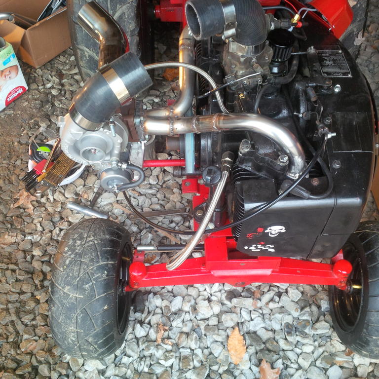

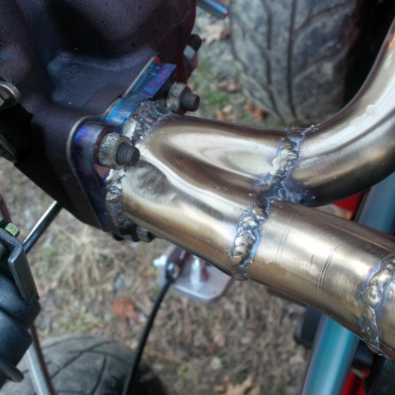

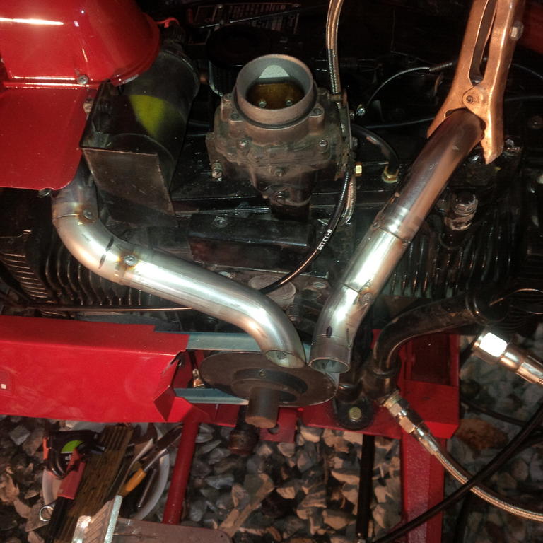

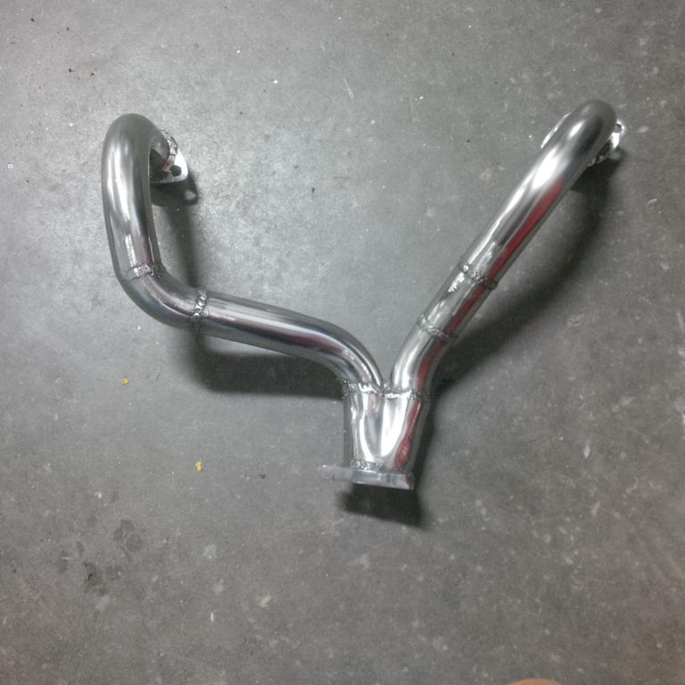

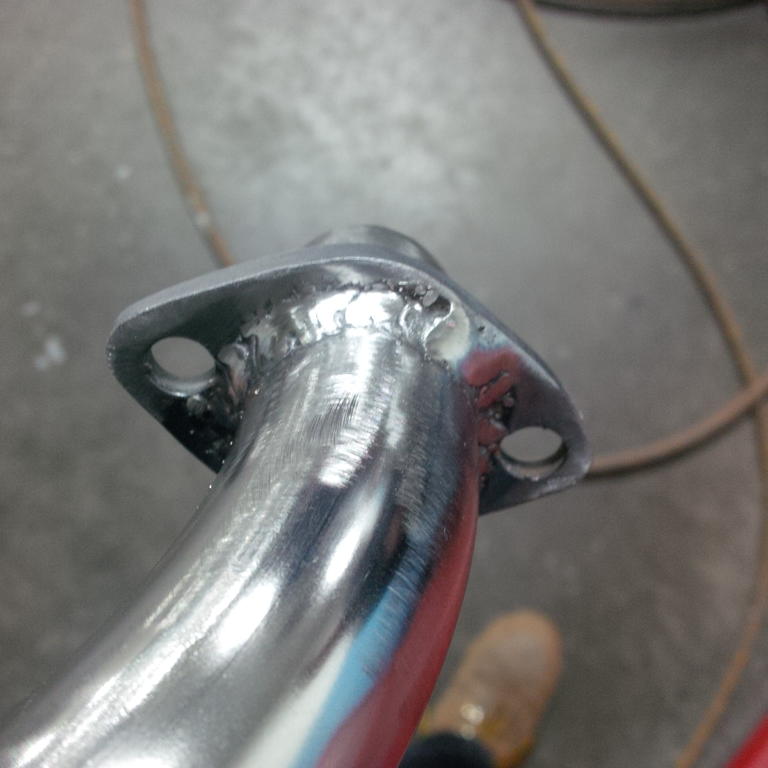

fast88pu

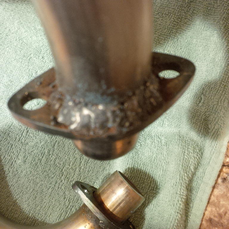

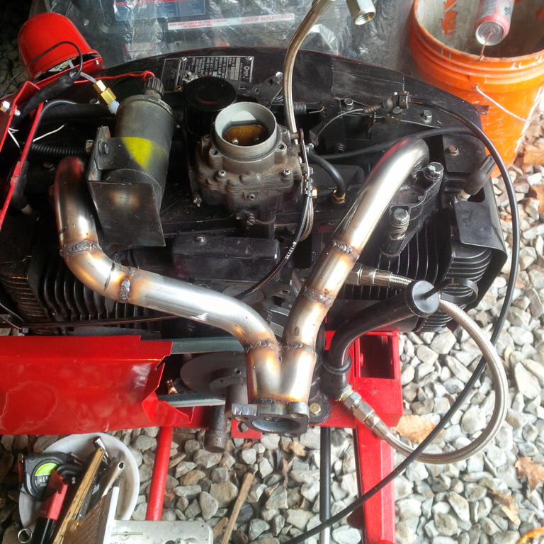

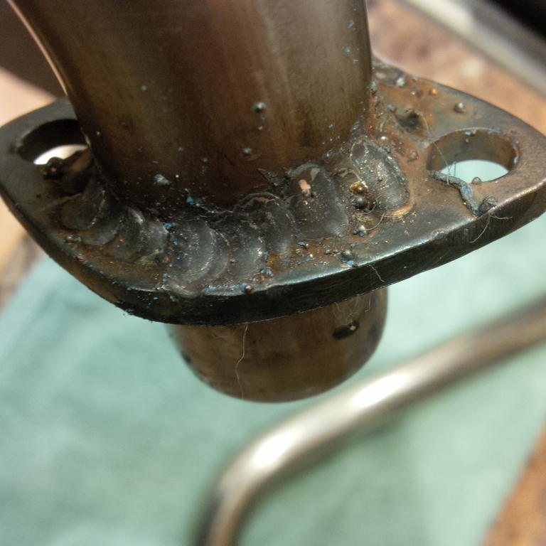

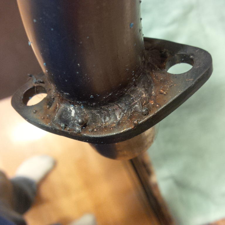

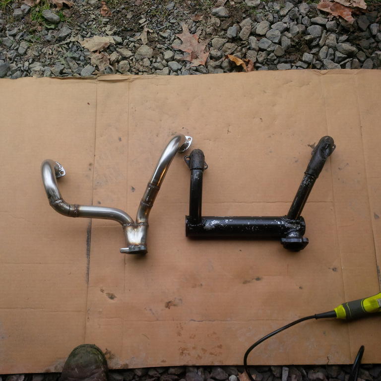

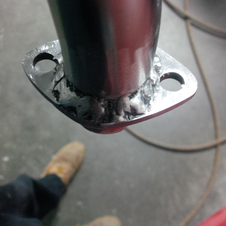

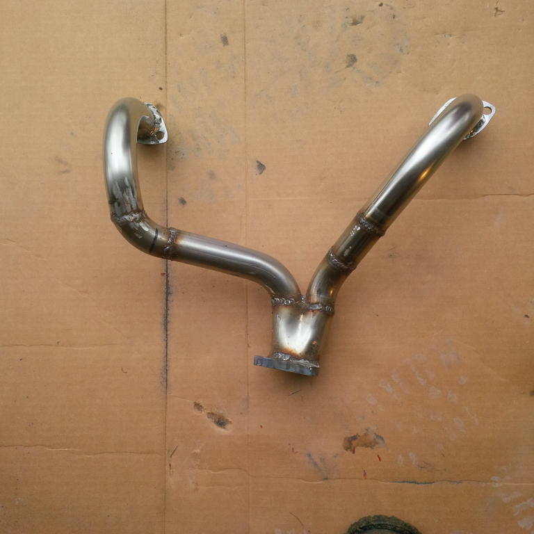

Had some fun welding today. 1st time welding stainless steel. NEW exhaust manifold is all made. 100% 304 stainless now. Just have to Polish it up now. And a old vs new manifold photo.
  • Excellent 3
How many horsepowers will that add?   :auto-layrubber:  Or was design #1 like a capacitor keeping extra boost energy on tap?  :D
fast88pu
Lol. Bout 3.99 hp
fast88pu

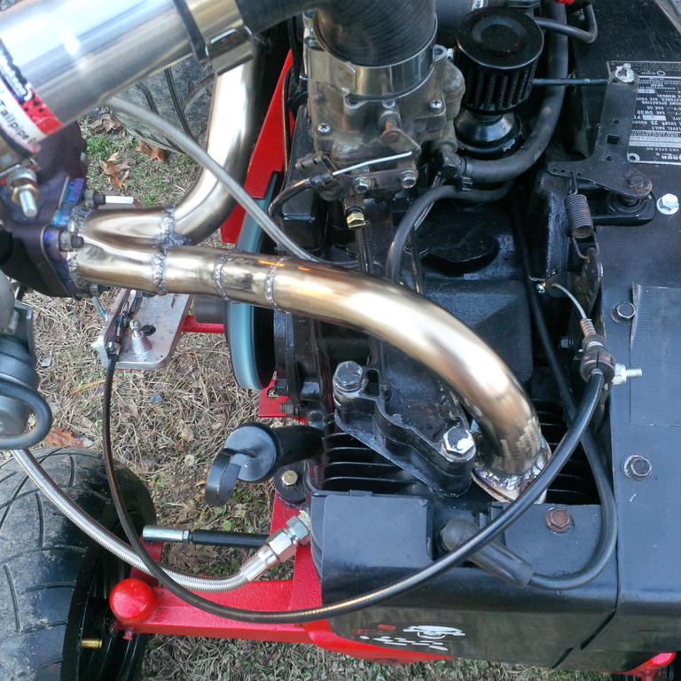

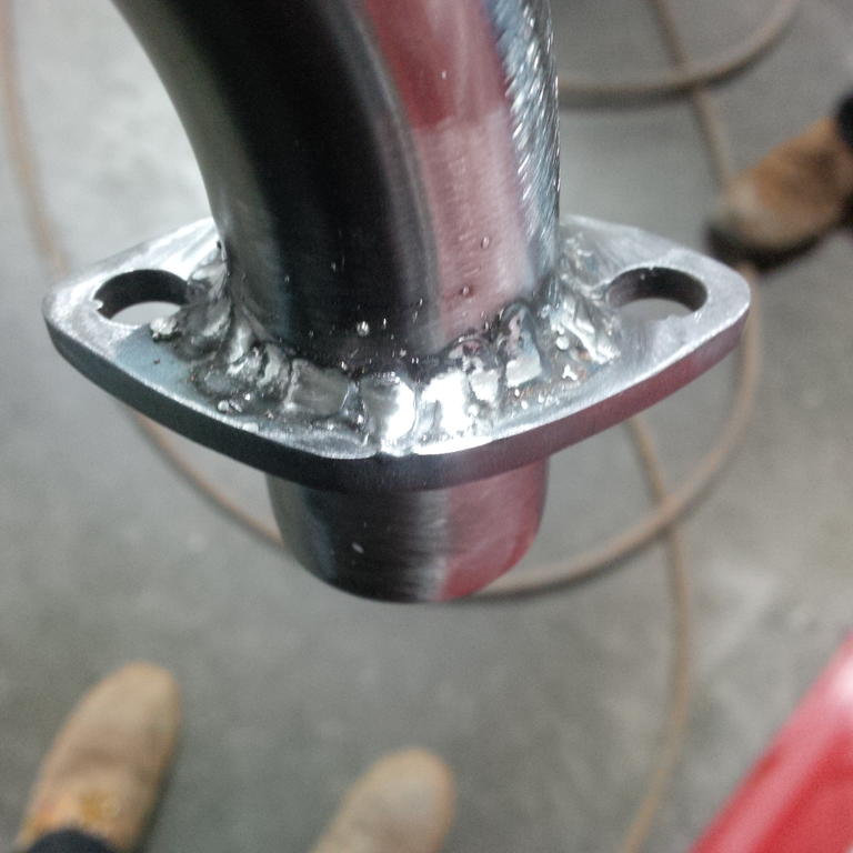

All polished up now
  • Excellent 3

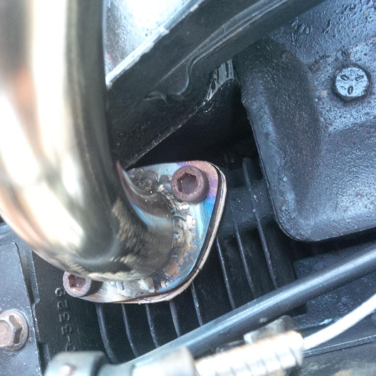

fast88pu
NEW header is all mounted an it turning blue and gold

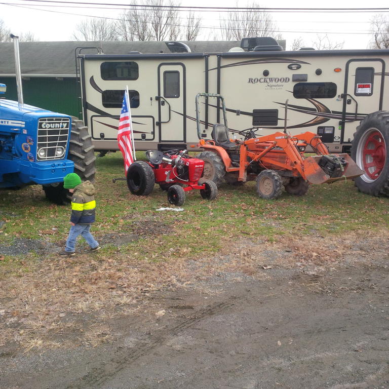

This past weekend I ran my towns local tractor parade with it. I was asked lots of questions about it and had a lot of interest in it by all ages.
  • Excellent 3

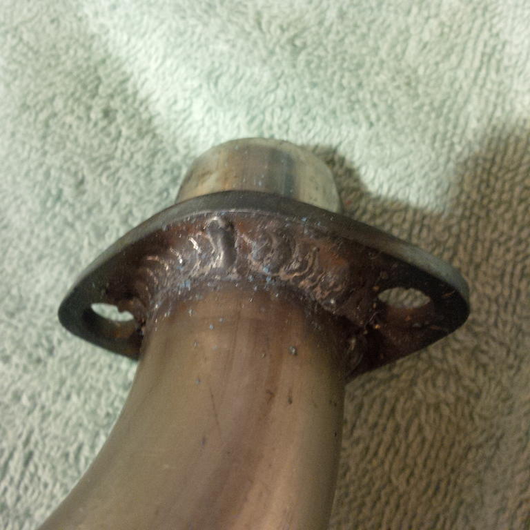

Tractorhead
It seems to me, you did it Wig welded?
How was your experiences in Stainless steel welding after that?
Found it hard or was it more simple in compare to Aluminum WIG welding?
Looks pretty good!
fast88pu
Looks pretty good!
That is all mig welded with 308 wire. It takes a lot of heat and I didn't use the tri blend of gas on it so harder yet. Now I have a tig welder for next time I weld stainless. Aluminum is much harder to weld because of spool gun use.
Tractorhead
Ah ok,
i thought you did it Wig welding.
i try WIG last time on Aluminum, in my experience i found it's more complicated than Mig,
but the result looks massive better.
So Wig just needs more training to get clean seam.
Thanks for your info.
fast88pu
2 hours ago, Tractorhead said:
Ah ok,
The original plan was to tig it but the rods didn't show up in time for me. So that will be next time.
Stefan, I believe there may be a translation barrier here...
TIG for us is Tungsten Inert Gas, it has a hand held torch with the shielding gas and an electrode, with hand held filler rod.
MIG is Metal Inert Gas, it has the hand held gun with wire feed filler, sometimes also with flux core (shielded and gasless) wire.
what is WIG, I’m assuming that’s our TIG?
fast88pu
Tig and wig are the same
Got it, I had never heard that!

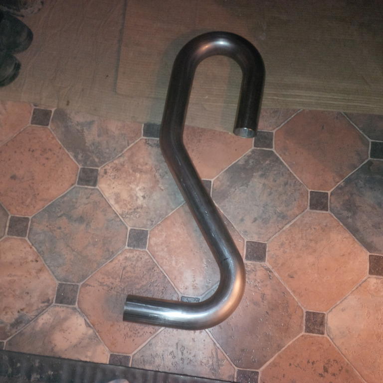

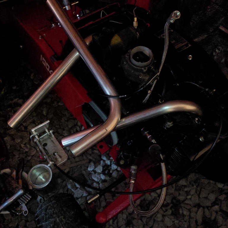

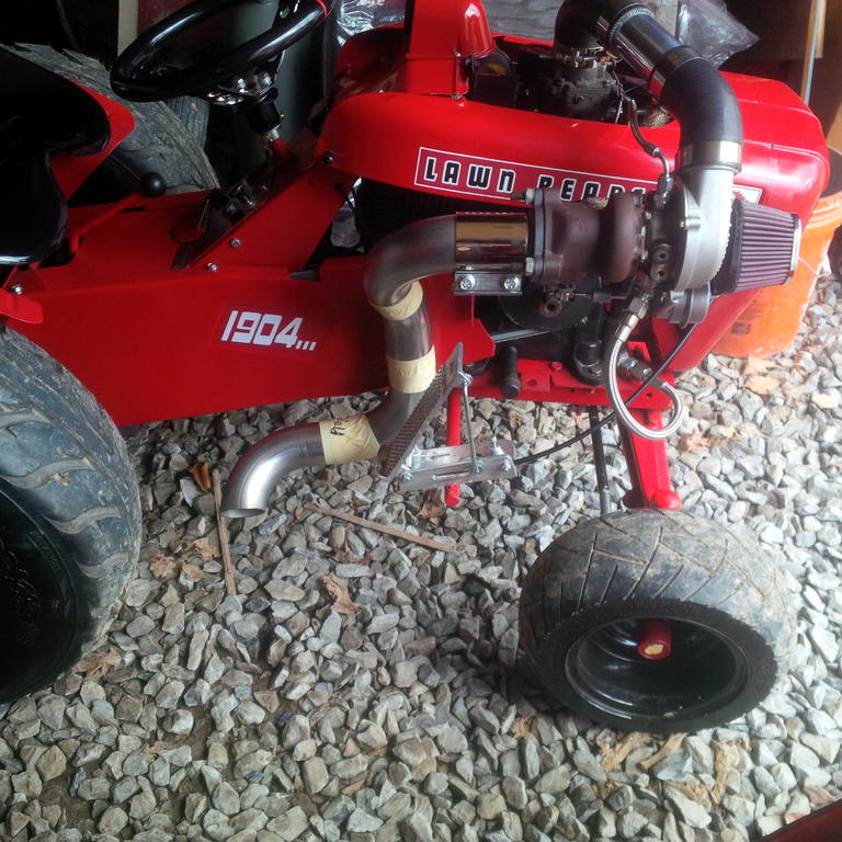

fast88pu

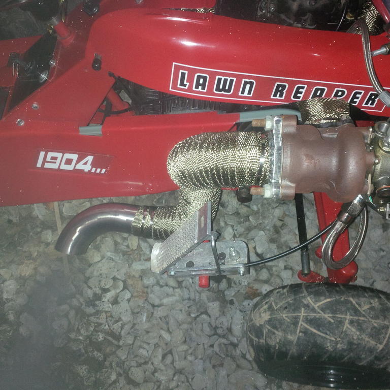

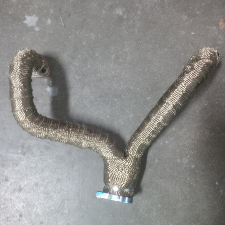

Header is all warped up now to hold heat in

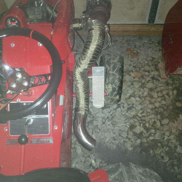

fast88pu

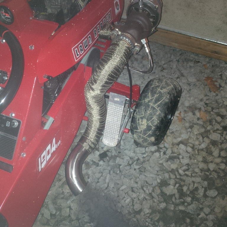

I finally got a chance to play with my tig welder and make my exhaust. 2.5" 304 stainless with header wrap on it for heat. Lots of stuff to try snaking 2.5" pipe around and out of the way.
  • Excellent 4
