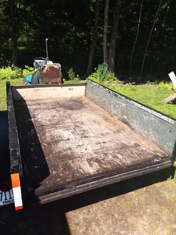

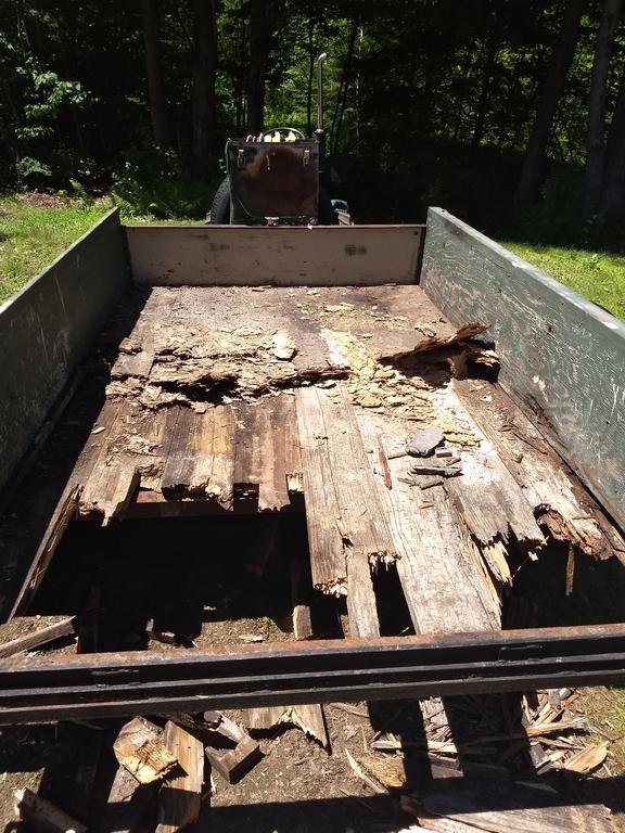

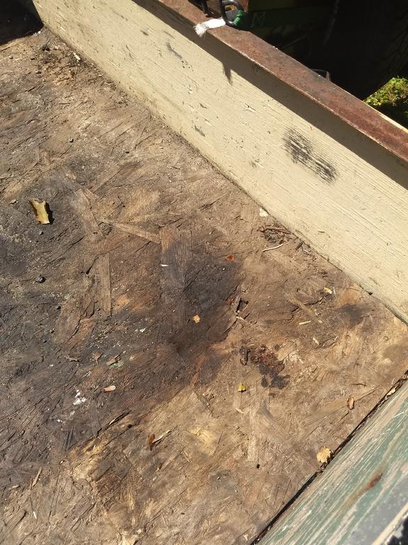

ebinmaine 70,725 #1 Posted July 4, 2018 We bought this trailer a couple years ago knowing it needed a little help. As you can see there is a layer of very badly swollen and rotted 1in thick OSB on top of the original 2 by 8 pressure-treated boards which are also rotted. There used to be three-foot-tall OSB sides as well. We are going to replace the decking and leave the sides open. Today Trina and her mom ripped all the wood off. It's only in the low 90's in the shade. 6 Share this post Link to post Share on other sites

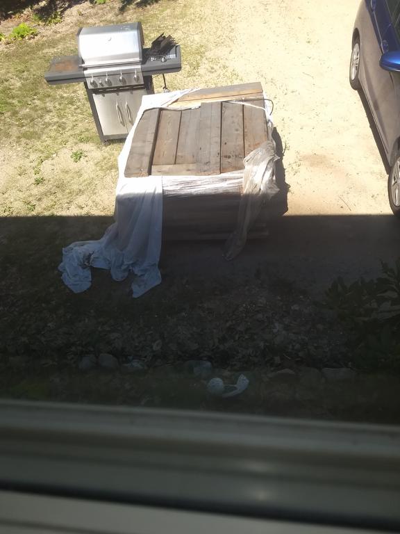

ebinmaine 70,725 #4 Posted July 4, 2018 1 hour ago, dclarke said: Those 5x8 trailers sure are handy to have around. What are you using for decking, Eric? We were reorganizing the warehouse at work and took down a whole bunch of cantilever racks that used four foot long 2 by 8 for the shelving. They were going to just put them in the wood recycling so I took it home without really having any particular purpose in mind. Ended up getting a 4-foot square pallet probably stacked 3 feet high. We've used some of the boards for other things already. We're going to use those as the decking of the trailer. I've thought about coating them with something but I can't come up with any good answers. This doesn't last very long. That is slippery. This Is too expensive. That doesn't work...... So we are just going to leave them plain. Should be able to get at least 4 to 6 years out of it if I can keep it well-ventilated and drying. 1 Share this post Link to post Share on other sites

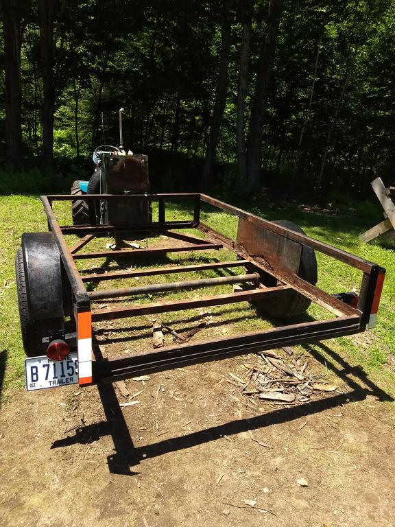

ebinmaine 70,725 #10 Posted July 8, 2018 6 hours ago, Lee1977 said: install the boards Will do Lee. Thanks ! My Honey spent a bunch of time yesterday wire brushing and painting. She's ready to choose the boards this morning. Share this post Link to post Share on other sites
