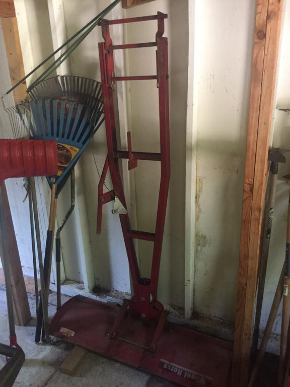

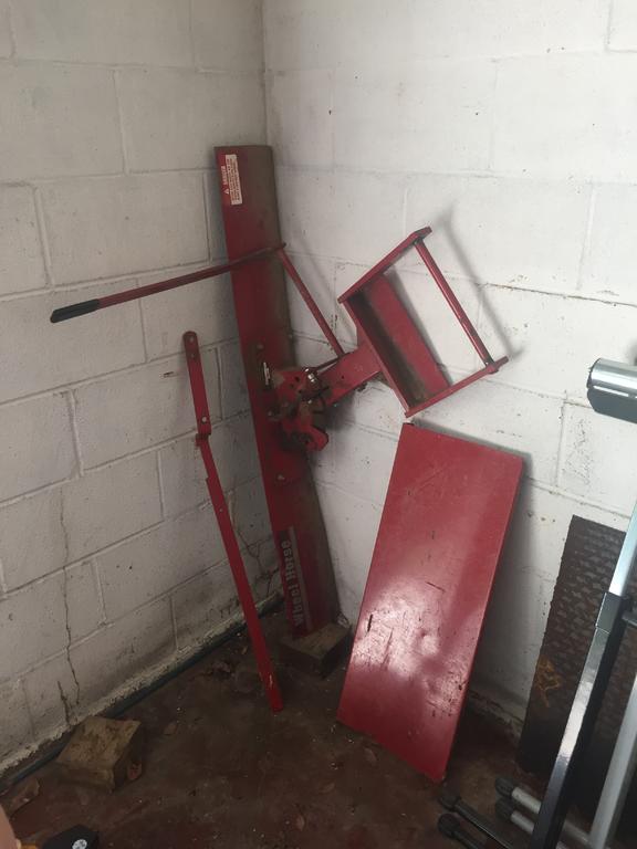

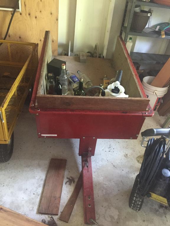

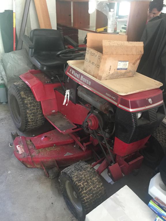

maxxsam 1 #1 Posted July 3, 2018 I have an opportunity to buy an 88 520-HC. I see a lot of 520-H, what is the difference with an HC? Is there anything in particular with this machine I should be looking for? I believe the hours are pretty low. I don’t know much about it. There are several implements that come with it, snow plow, looks like a grading blade, and a trailer. Any input would be greatly appreciated. 1 Share this post Link to post Share on other sites
lynnmor 7,554 #2 Posted July 3, 2018 (edited) The C was the commercial version. The gearing allowed faster speed, it had the better seat support and swept front axle a couple years earlier, a different air cleaner, and less frills like the shiny muffler cover. Newer 520H has the control levers next to the steering wheel instead of on the console, there are some that prefer one over the other. So basically it is the same tractor as a newer 520H, but it goes a little faster. Edited July 3, 2018 by lynnmor 3 Share this post Link to post Share on other sites
Skipper 1,789 #3 Posted July 3, 2018 It will go 17,5% faster. H goes 6.4 mph, HC goes 7.5 mph. 2 Share this post Link to post Share on other sites

maxxsam 1 #5 Posted July 3, 2018 Thank you all, anything I should be looking for that might be specific to this model? Share this post Link to post Share on other sites
lynnmor 7,554 #6 Posted July 3, 2018 7 minutes ago, maxxsam said: Thank you all, anything I should be looking for that might be specific to this model? Make sure that all electrical systems work correctly. Listen carefully to the engine for unusual noises and exhaust note, the weak part of the engine is the intake valve seats coming loose. Guess what I am doing today?!! Share this post Link to post Share on other sites
