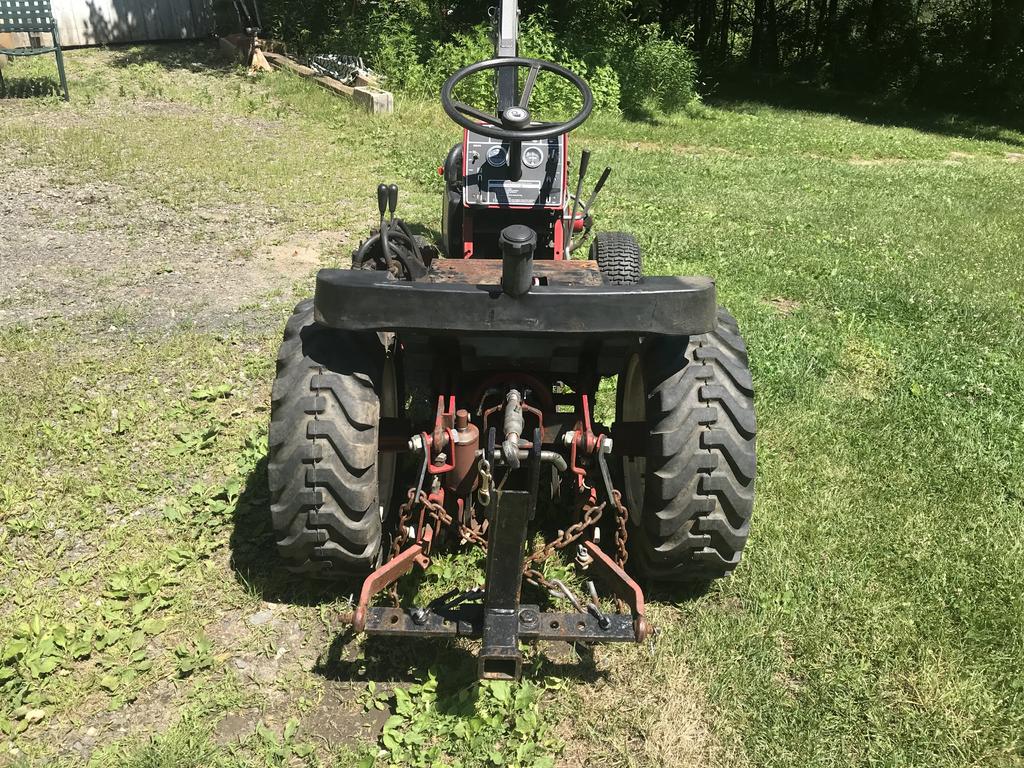

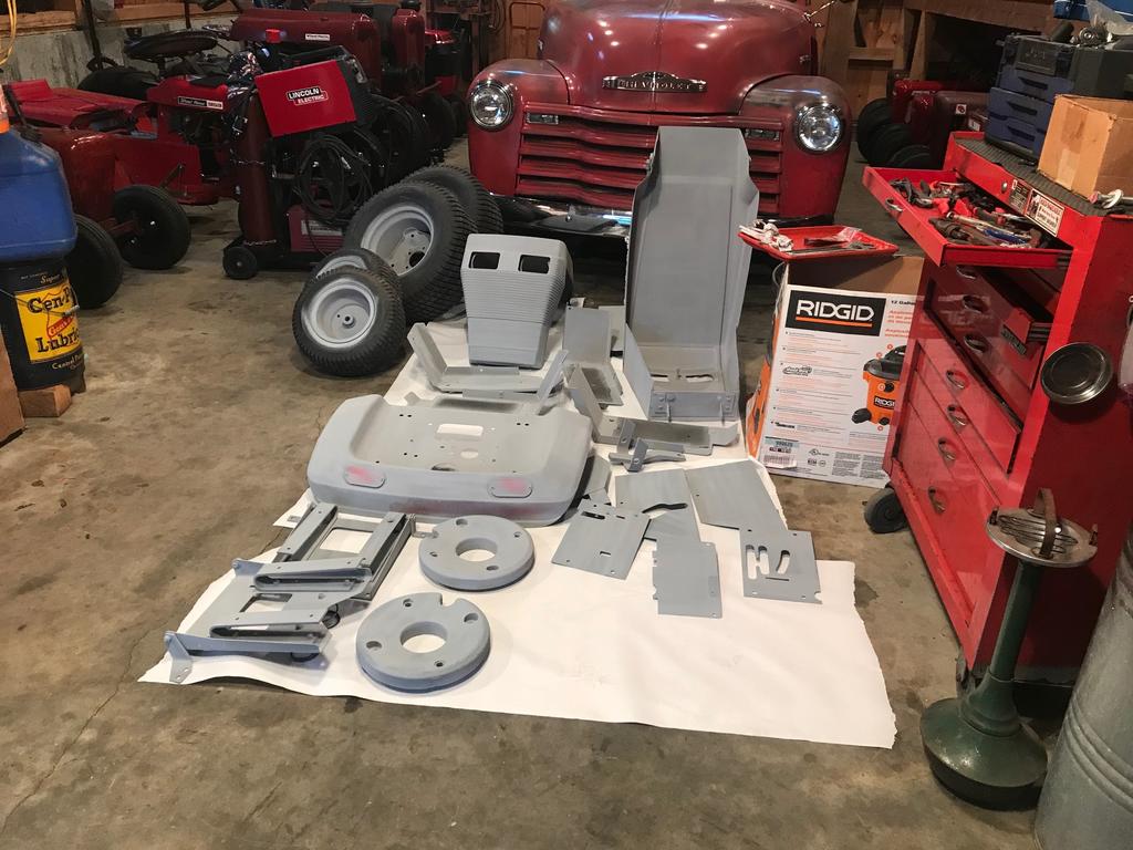

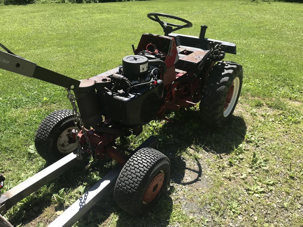

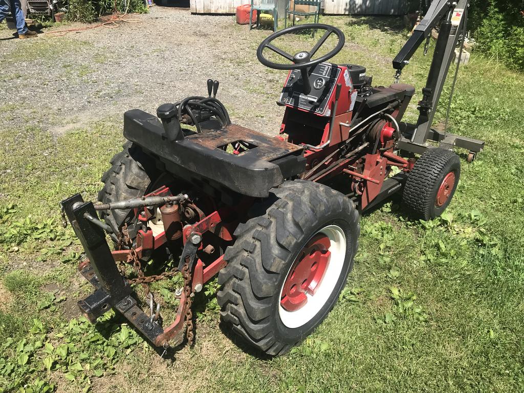

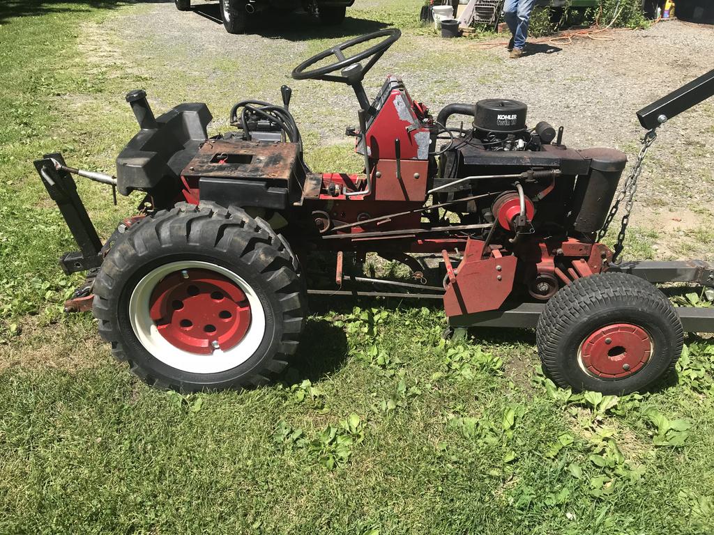

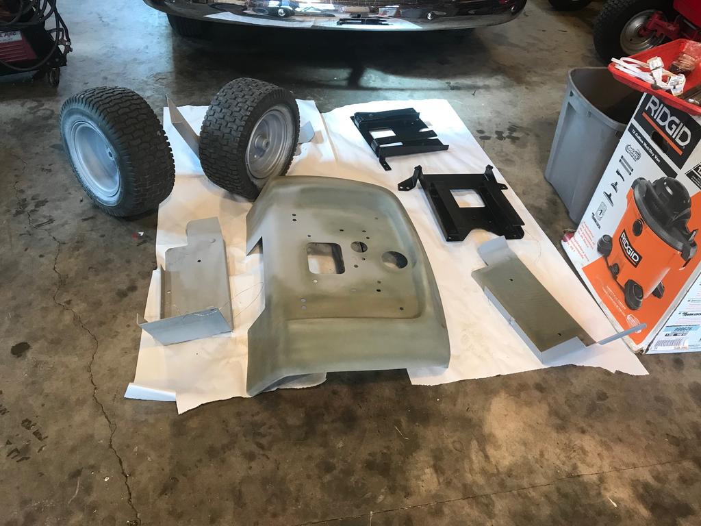

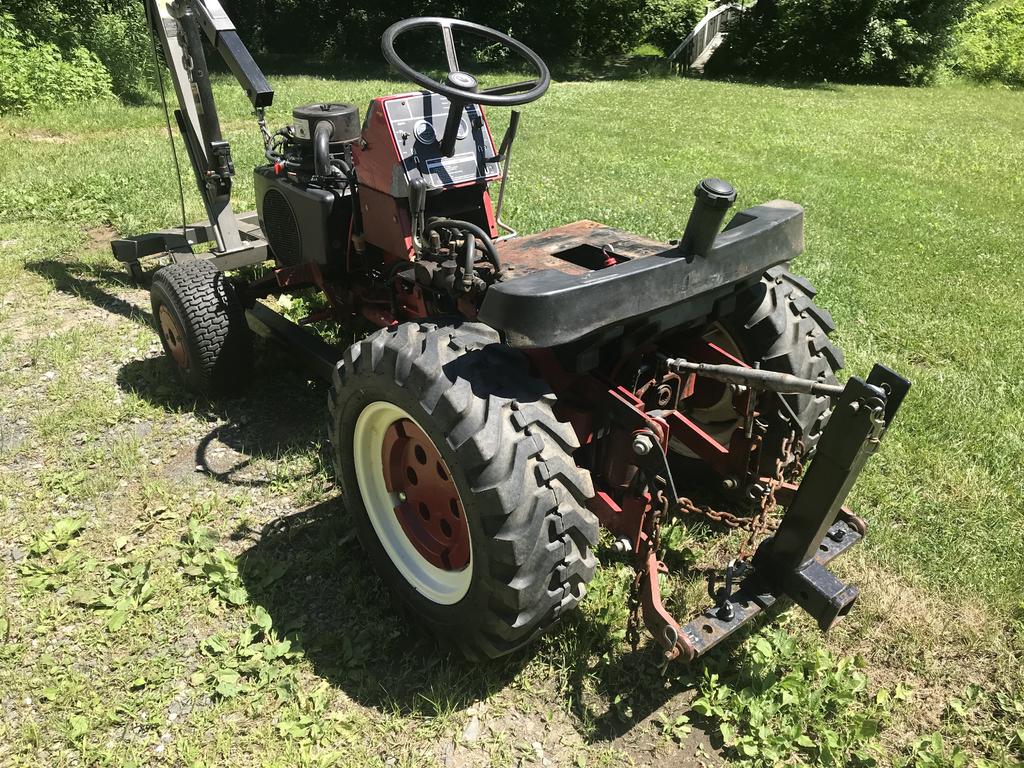

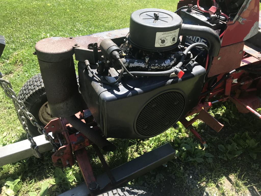

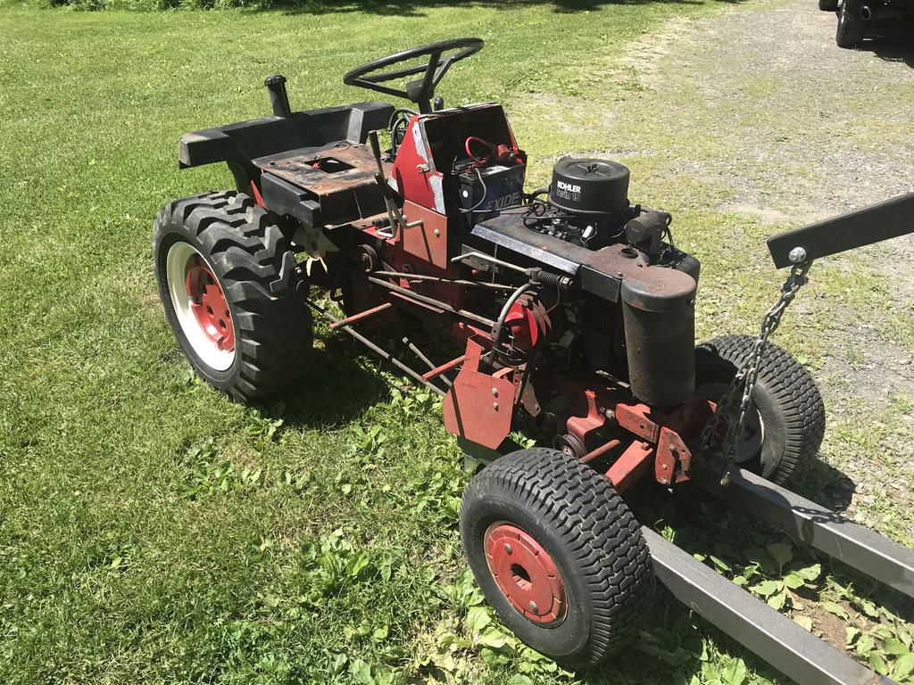

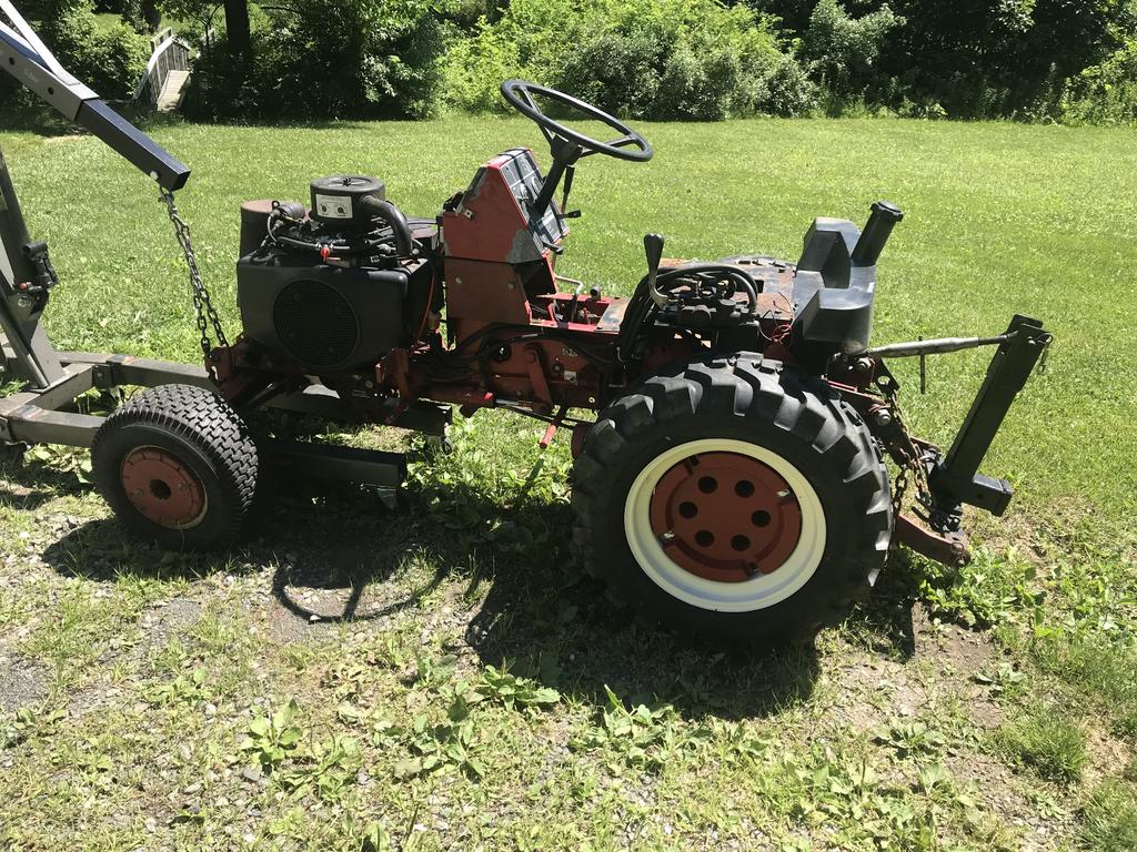

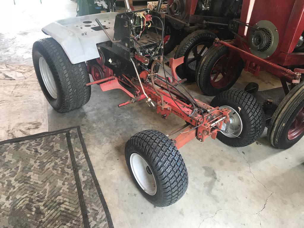

Some pictures of he C being disassembled. I put this one off due to the headache of the three point and rear pto on it.
I need ti find the link link to the member here making the rear fender pans...

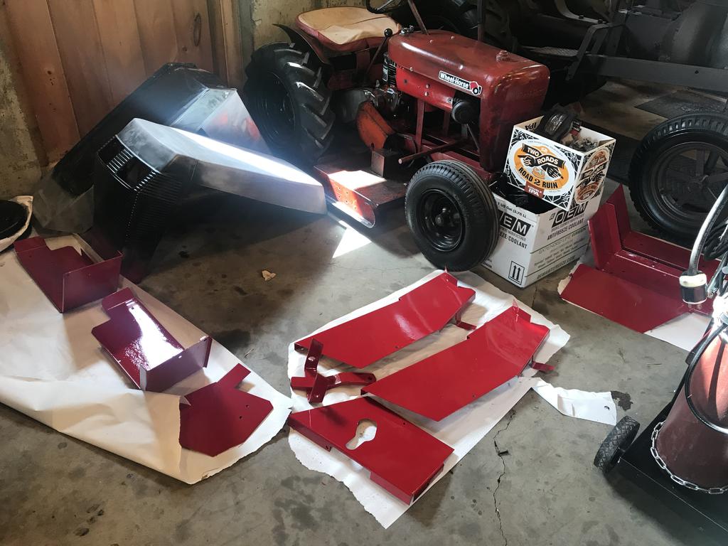

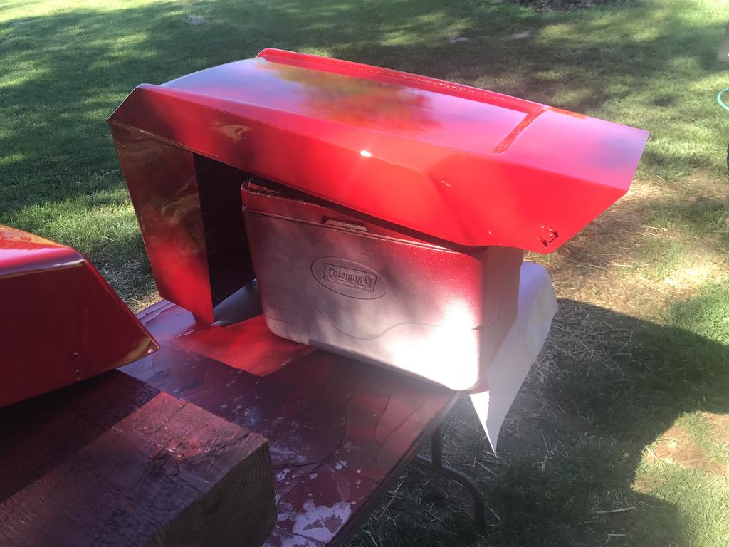

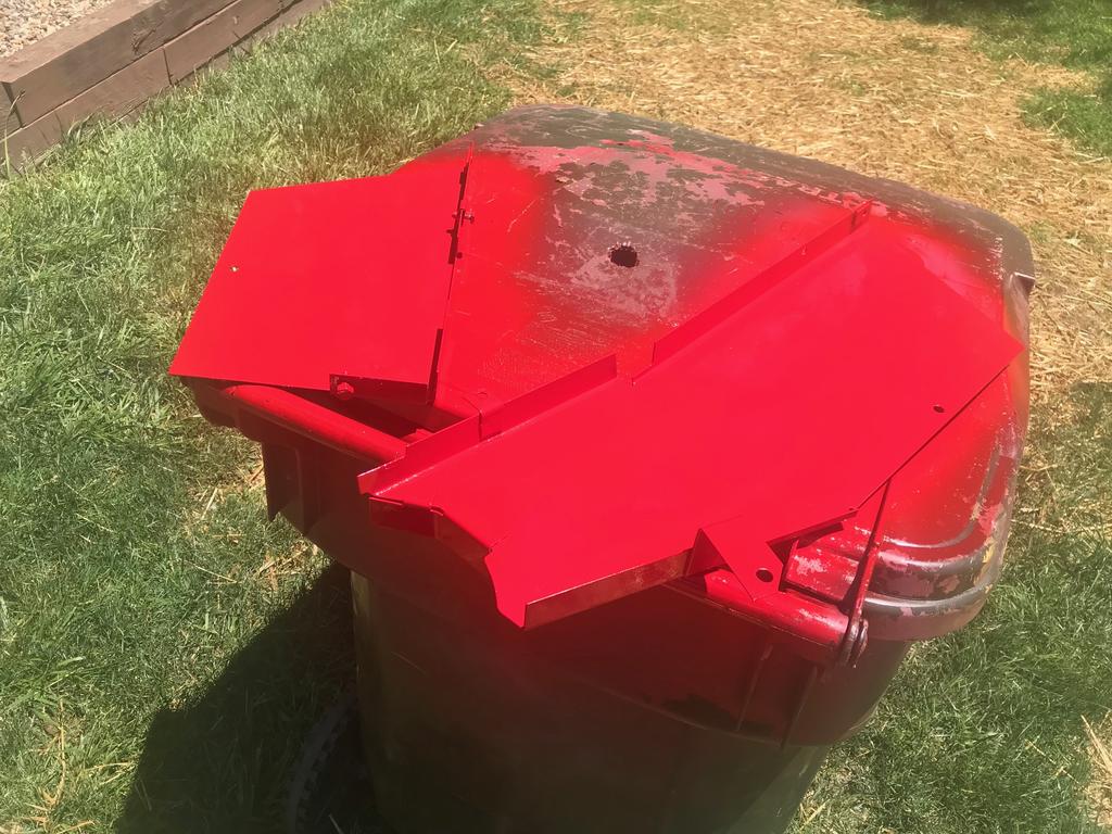

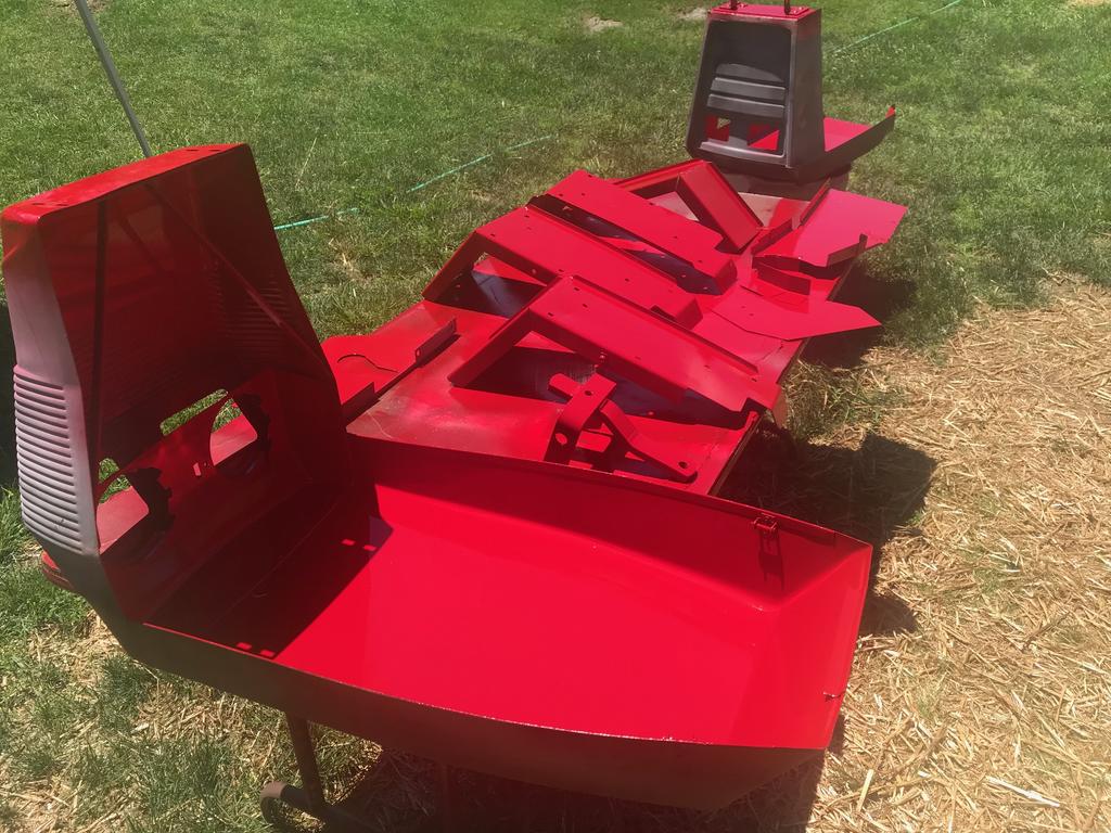

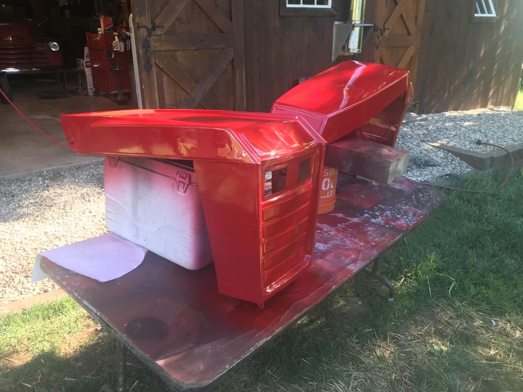

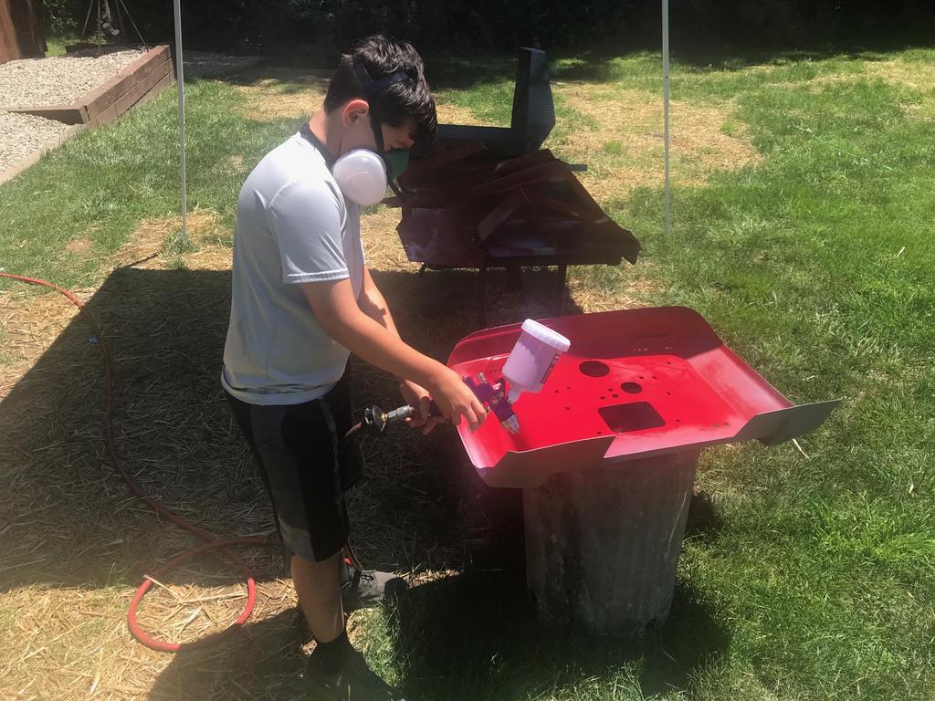

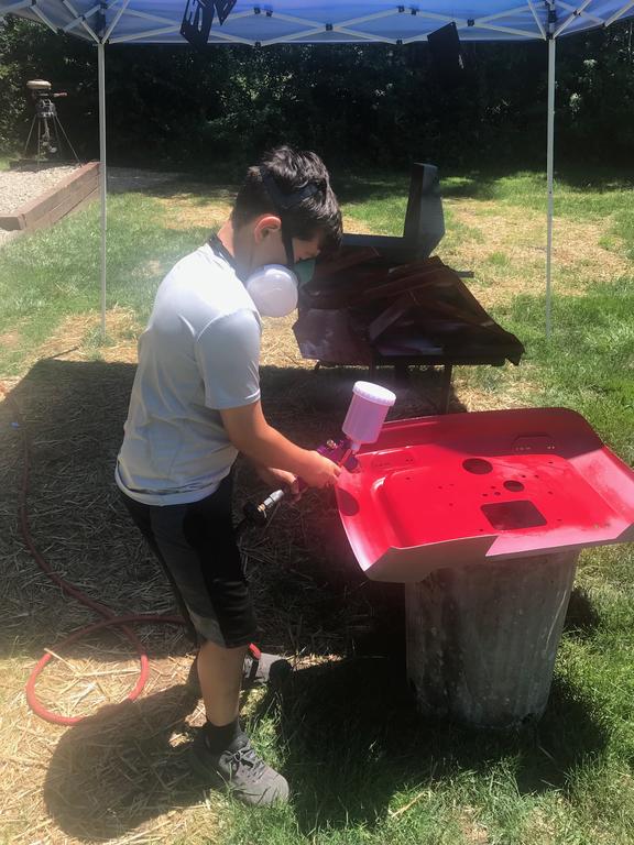

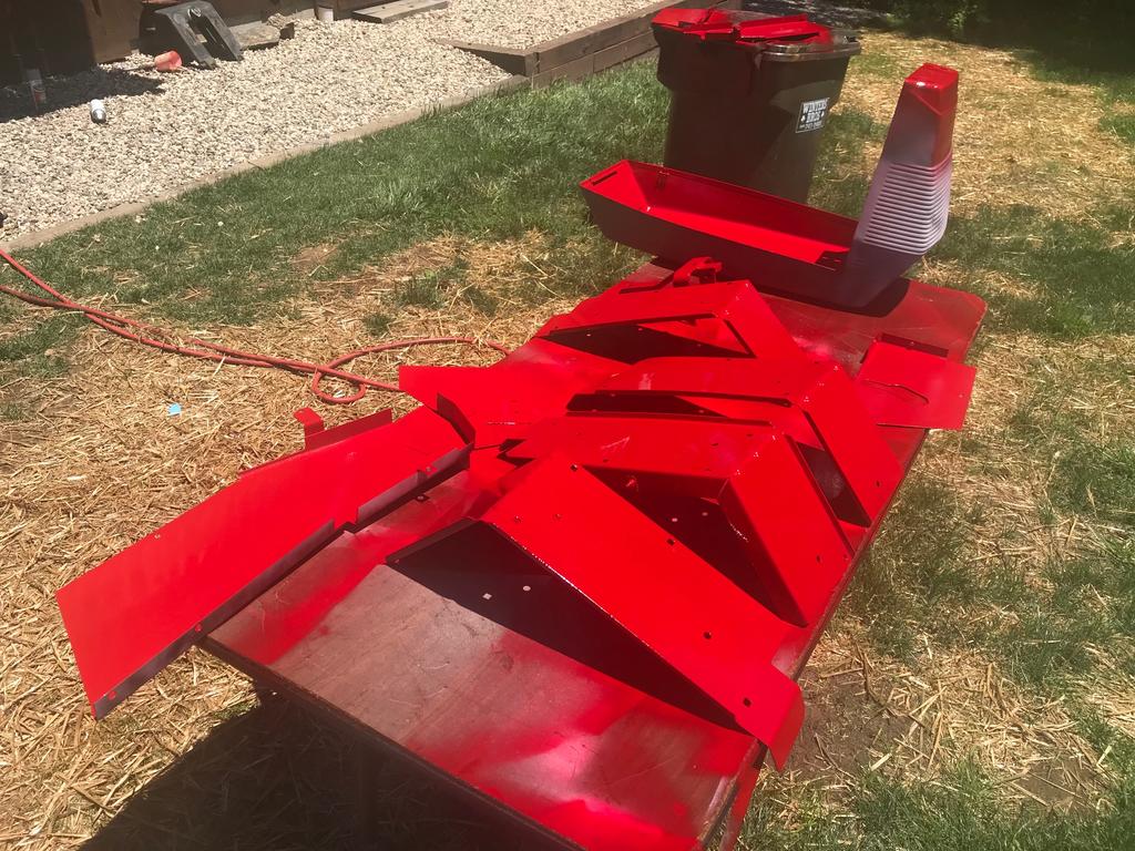

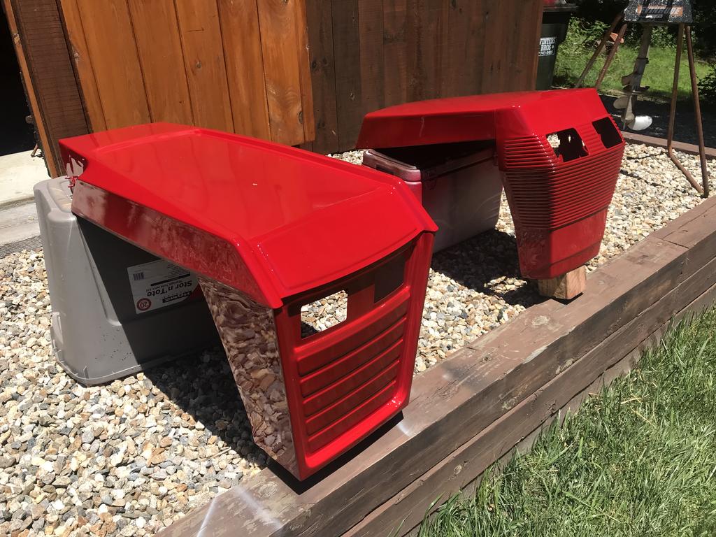

More progress today. I found a local auto paint store sells ready mixed auto paint and it is a really good match (at least the chip was).
  • Like 7
WVHillbilly520H
You do know "Victory Red" is a Chevrolet name for the their red paint from late 80s-90s.
stevebo
I have heard. I matched it up to my 420 and it is almost an exact match.

I love seeing that young wheel horse restorer “in-training” laying down that sharp red liquid and having fun doing it!:text-bravo:

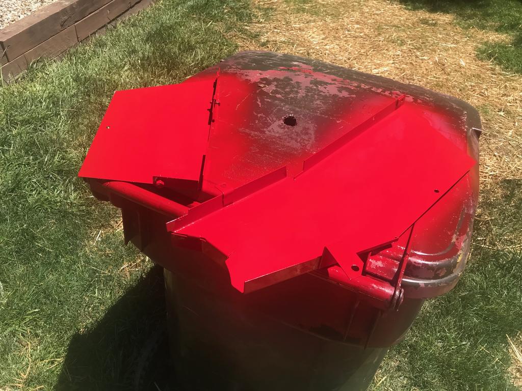

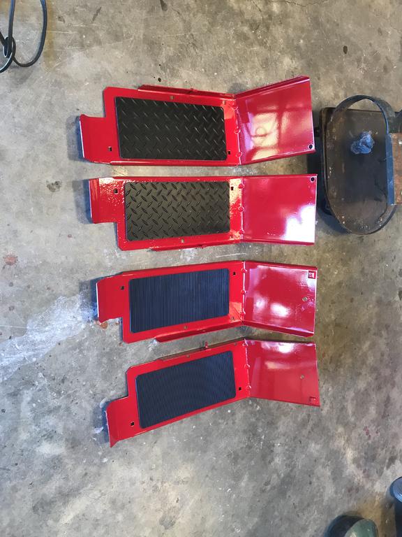

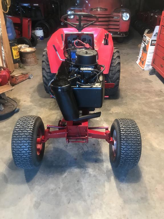

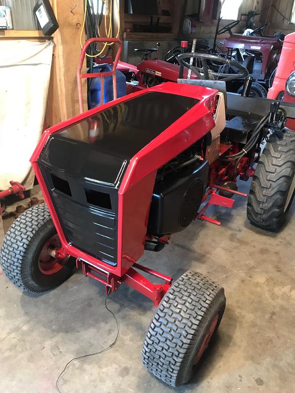

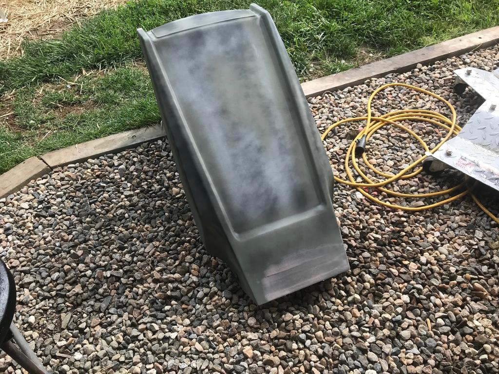

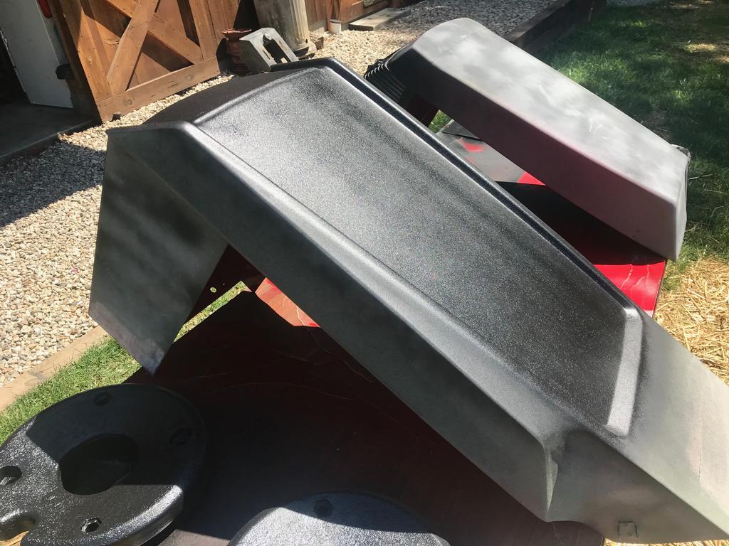

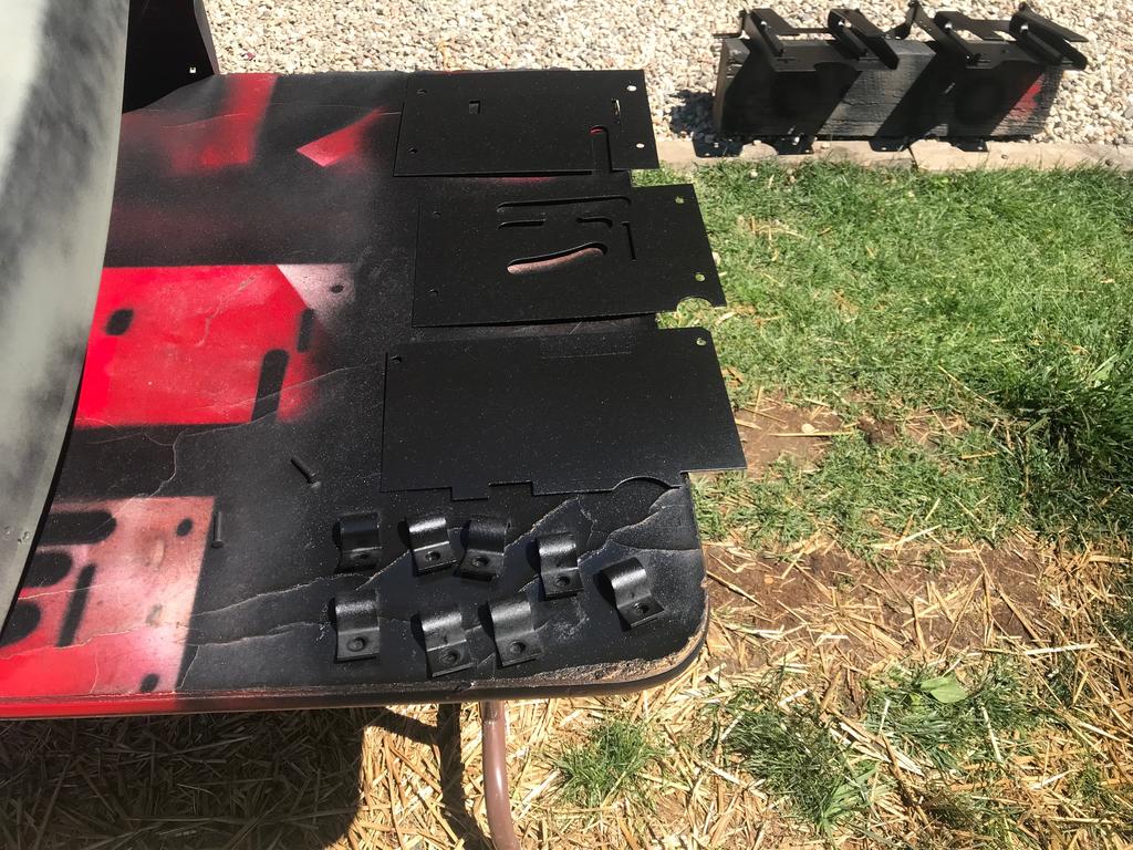

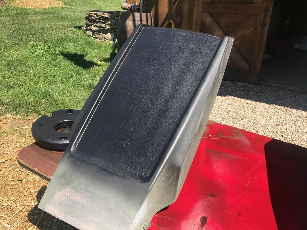

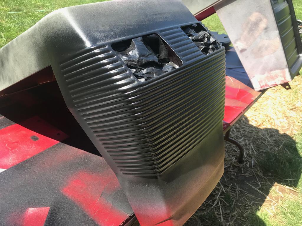

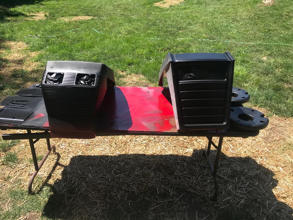

Got the black on the hoods and other misc parts. Used Duplicolor ready mix jet black from autozone. It is laquer and when sprayed had a textured finish. I like that and was looking for that but the can said nothing about textured??
Sarge
That textured finish is most likely from the paint flashing off too fast - looks like it never had a chance to level itself out. Might have to use a higher heat range reducer depending upon the makeup of the paint itself. Lacquer can flash off really quickly and cause cracking problems - there are additive chemicals that can help with that as well.
Sarge
stevebo
Thanks Sarge. This is open and spray... went on that way
Sarge
Any time I shoot paint in the sun it automatically gets mixed with high temp reducer - makes a world of difference in gloss and buffing work.

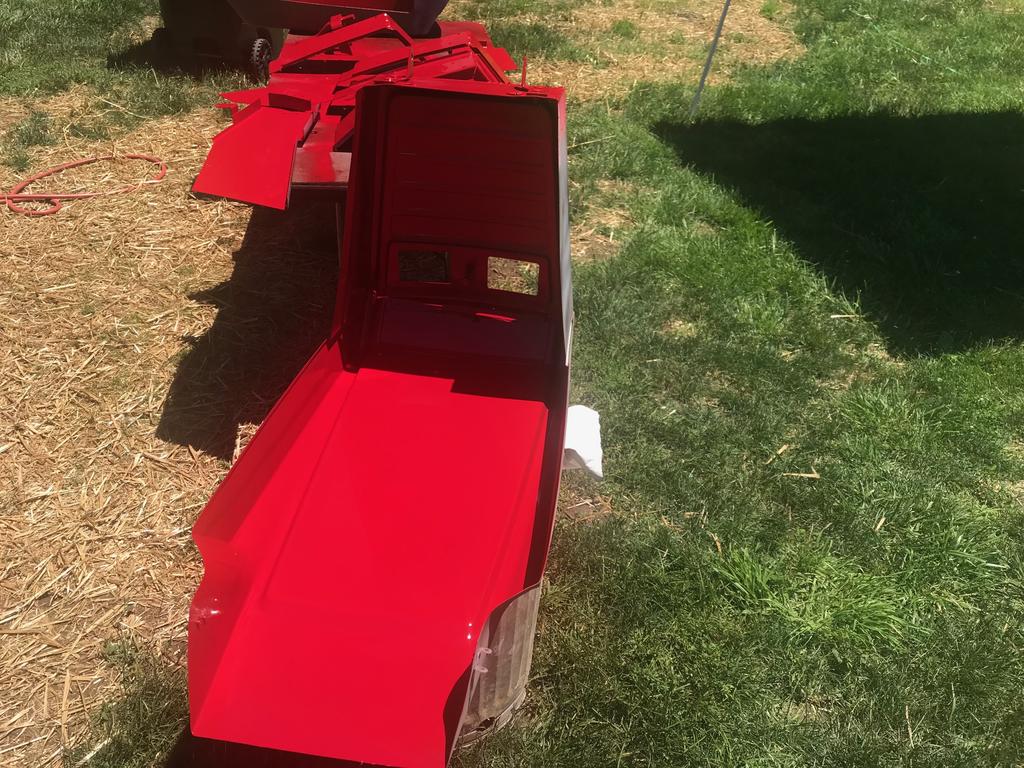

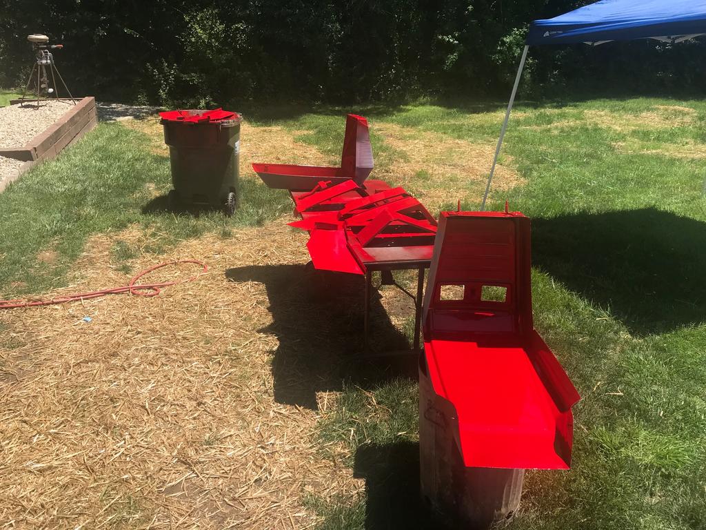

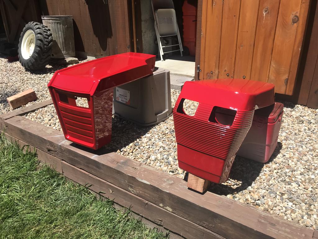

A bit more done
  • Excellent 5
Looking great!!

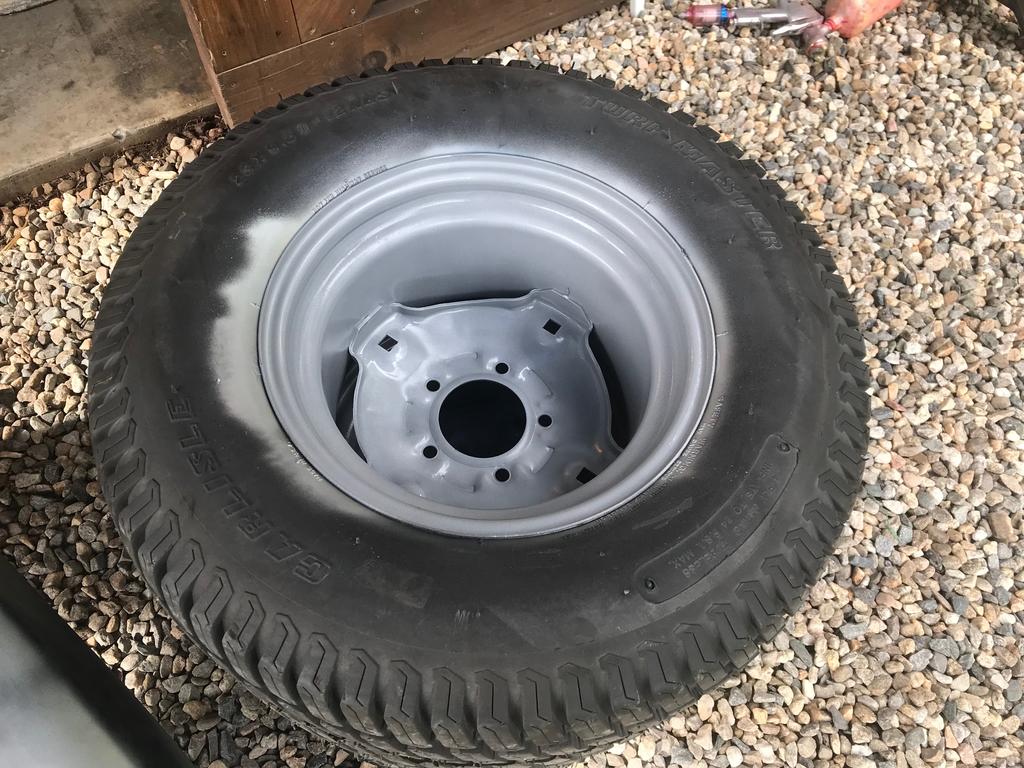

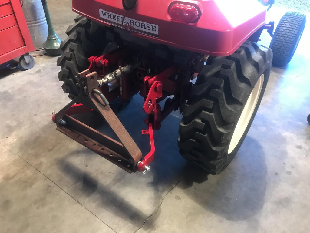

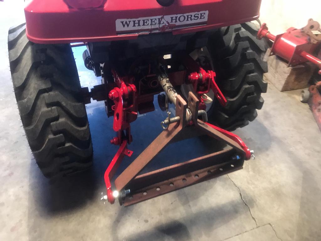

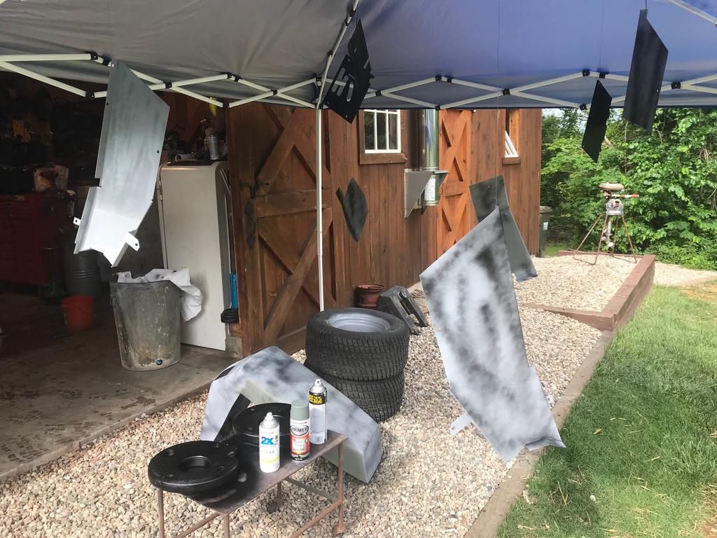

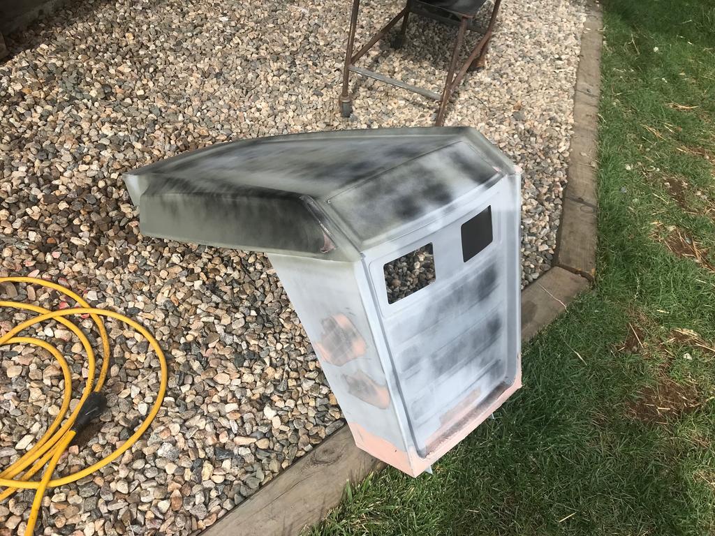

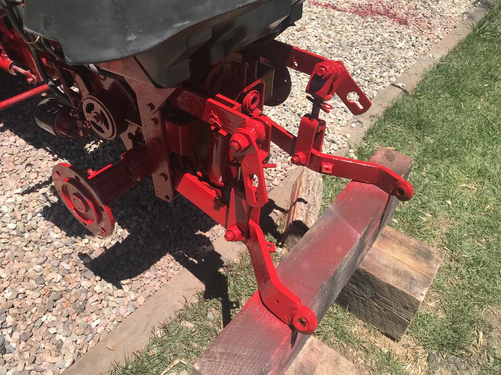

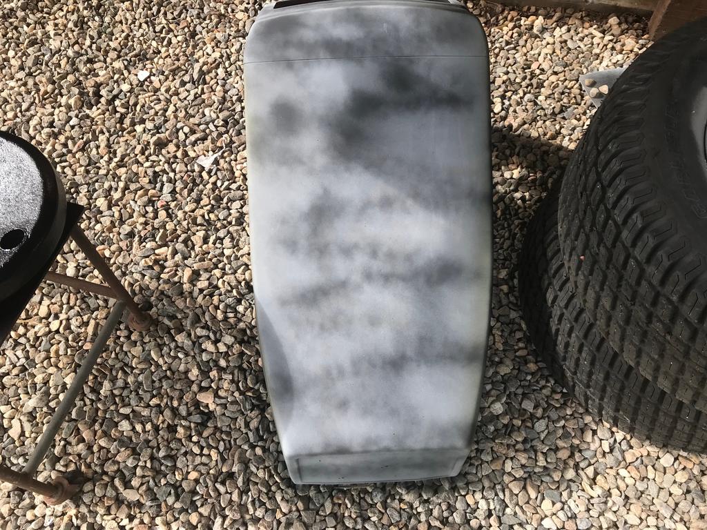

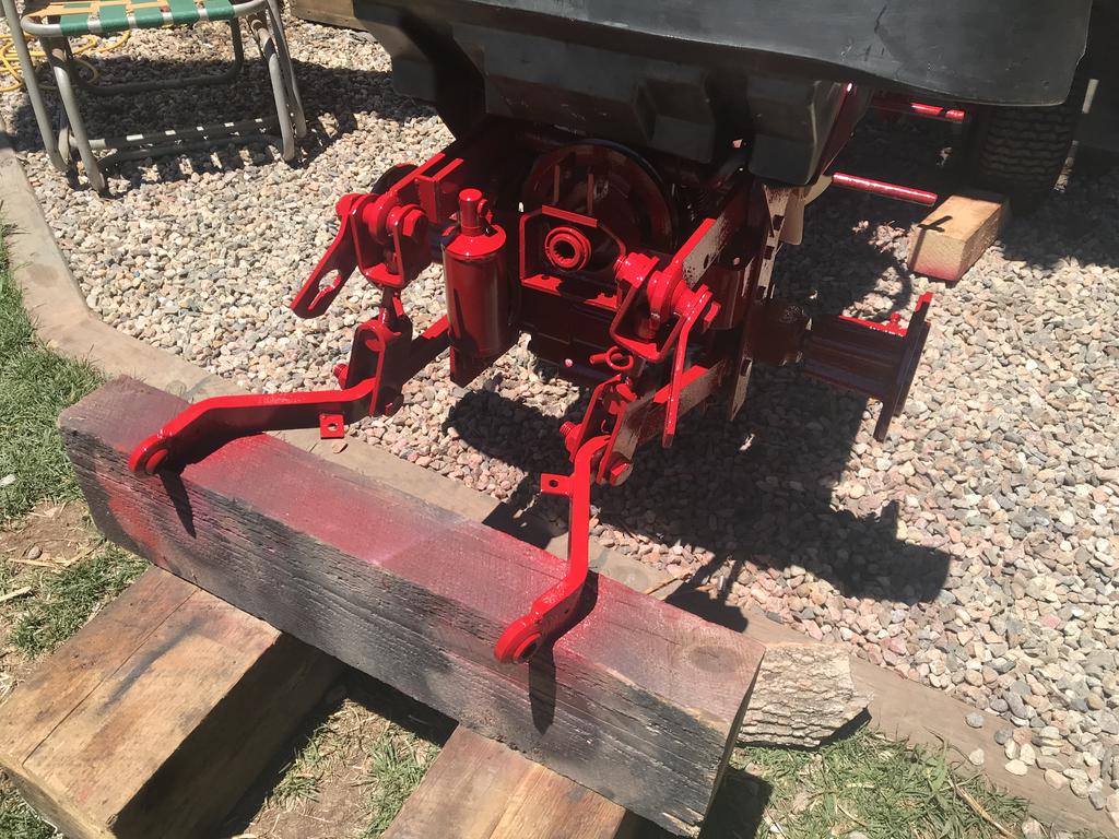

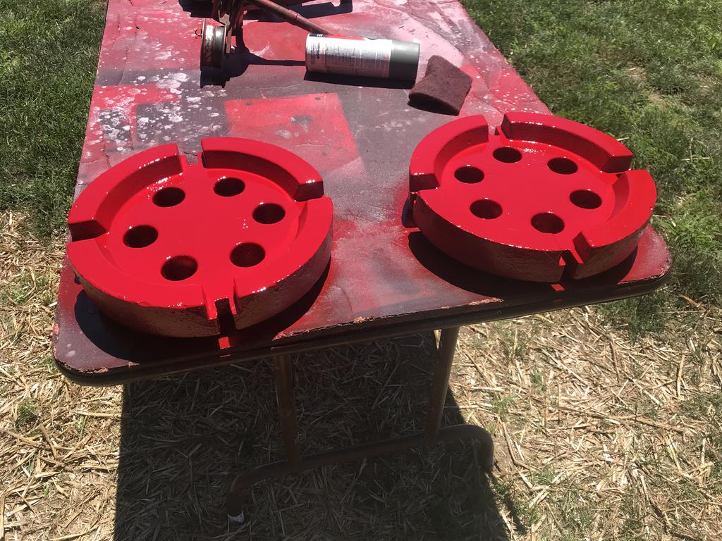

I have no interest in taking apart the 3 point and rear pto set up to really clean up the parts. I used pressure washer and got it real clean, primed with self etching primer and went to town. This is a worker and not a show machine. It is cleaning up real nice though
  • Like 6

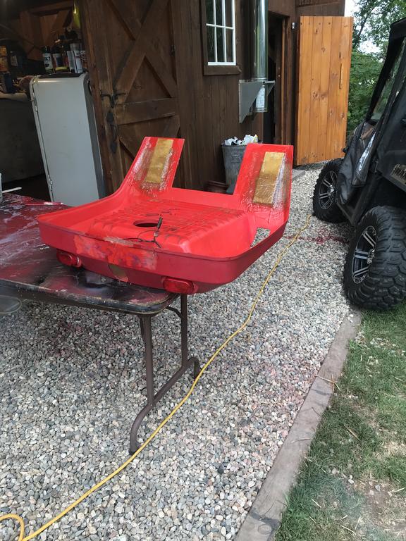

Got a little more done
  • Like 6

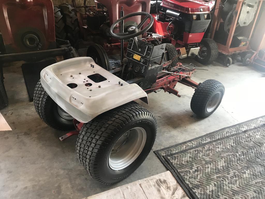

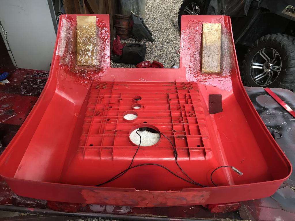

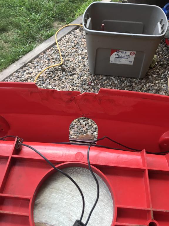

:rolleyes:  Want your good plastic fender back?   :confusion-shrug:
19richie66
Steve, that looks fantastic!
stevebo
Nope. This one will be better and oem. Have to beef up the legs and she will be fine.
