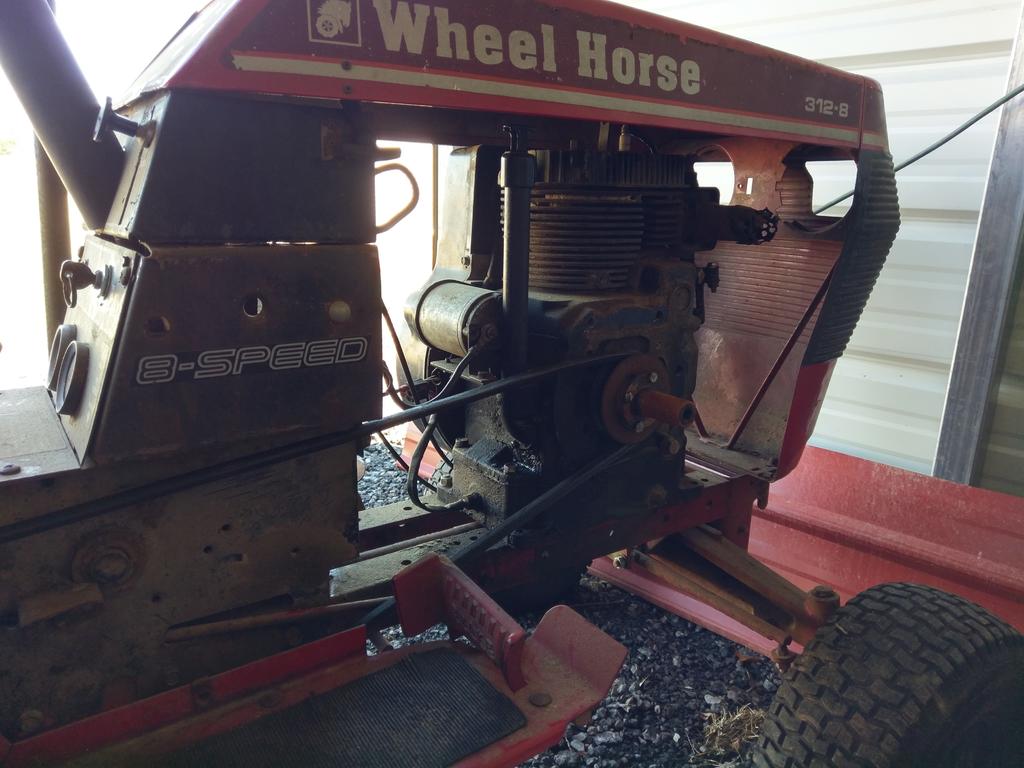

A couple months ago i got a WH 312-8 from my wife's cousin. I have mowed with it numerous times and i always had problems making it up my hill. I changed both drive belt and deck belt (he had 1/2'' on them) and put proper belts on from Toro dealer. I also replaced the spring on my clutch pedal (it does not have piston to slow it down). Now my 312-8 will only go up hill in low gears and will not go in 2 or 3 hi at all. 1st gear in hi will move but not up hill.  My drive belt stops moving sometimes when trying hi gear. Please help this newbie!
Skipper
Can you take a picture of how you routed that new belt? It sounds like belt slipping, and I think you either routed it wrong, or you got the wrong length.
It should be routed like in this picture, and the belt should be a 5/8
If this does not help, and you can confirm the input axle is indeed turning, but tractor not mowing, then check if the axle in the wheel hub is turning inside the hub.

Make sure you have the right size belt and it is routed properly the belt shouldn't stop moving unless the engine stalls an 8 speed should either spin stall or climb if the belt is right
That is a hydro belt routing...I believe the OP has an 8 speed
Edited by pfrederi
Skipper
Sorry, yes you are right. Picture replaced with 8 speed config
Edited by Skipper

Ed Kennell
2 hours ago, DerrickH said:
  My drive belt stops moving  when trying hi gear.
You have found the problem.   Power is not getting from the engine to the transmission.         Can we assume the drive pulley and the PTO are turning properly  and the belt is slipping on the drive pulley?
If so, you have the incorrect belt or the tensioner idler pulley is not applying proper tension to the belt.

DerrickH
Thank you for all the replies and greetings!  Yes i do have the 5/8 belt #7473. i will check my belt guide at the engine pulley when i get home.  I think the belt tensioner pulley is not keeping proper tension, which is why i changed the spring but that didnt seem to help completely.
Ed Kennell
Check the 1/8" roll pin that pins the clutch lever on the left side of the tractor  to  cross over shaft that activates the clutch tensioner pulley.
Mark the end of the shaft and lever, then press and release the clutch pedal and check if the shaft and lever move together.
  • Like 1

DerrickH
Thank you for all your help! It was the roll pin Ed suggested. Put a pin in and now it runs like a champ!
