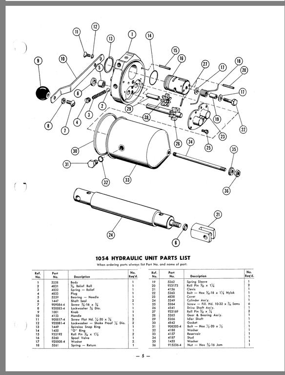

UncleJerm76 103 #1 Posted June 26, 2018 Need help locating the Hydraulic Lift Pump Manual/Diagram that came on the 1054. I found the HY-2 and HY-3 manuals but they are both for the old style pumps. The 1054 pump is the one that came with the redesigned return spring as well as the needle bearing upgrade to the drive gear shaft & brass bearing upgrade to the second idler gear. It also has a fill plug in the middle of the reservoir and the control lever bolted to the pump (instead of screwing in). Share this post Link to post Share on other sites
UncleJerm76 103 #3 Posted June 26, 2018 Yup that's the one! Is that manual on this site anywhere? Share this post Link to post Share on other sites
wheelhorseman 3,242 #4 Posted June 26, 2018 15 minutes ago, UncleJerm76 said: Yup that's the one! Is that manual on this site anywhere? Yes go to the manual section and download the manual with the IPL for the 1054 1 2 Share this post Link to post Share on other sites
UncleJerm76 103 #5 Posted June 26, 2018 Perfect, Thanks Lowell. I didn't realize it was bundled inside the 1054 manual, I should have thought to look there! 1 Share this post Link to post Share on other sites
