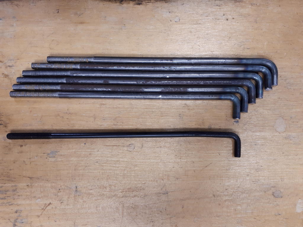

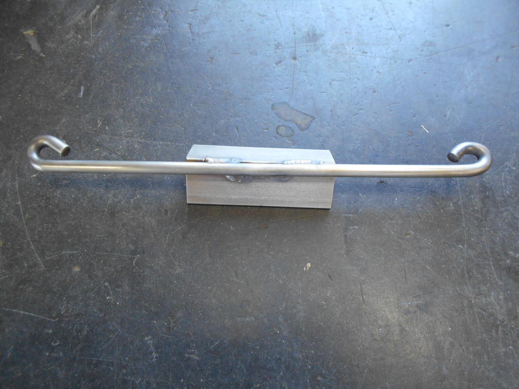

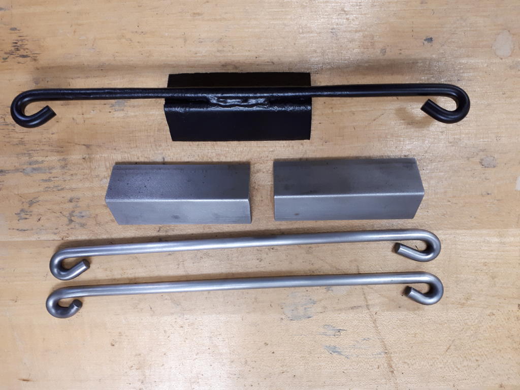

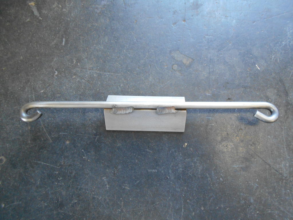

cleat 7,030 #1 Posted June 25, 2018 I have a couple of machines missing the proper battery hold down. So I decided to make my own out of stainless (of course). Hook rods are cold rolled steel. I threaded the hook rods then heated and bent them. They have been bead blasted and first coat of paint applied. Battery hod down rods are heated and bent. Angle has been cut. Just need to weld and polish them and job done. Here are the plans. Wheel Horse battery hold down.pdf Here are a couple of pics with the factory piece also shown. I will post more when the job is done ! Cleat Wheel Horse battery hold down.pdf 7 1 Share this post Link to post Share on other sites

cleat 7,030 #9 Posted July 21, 2018 Finally got them done. Here is a pic of one. Cleat 1 2 2 Share this post Link to post Share on other sites
