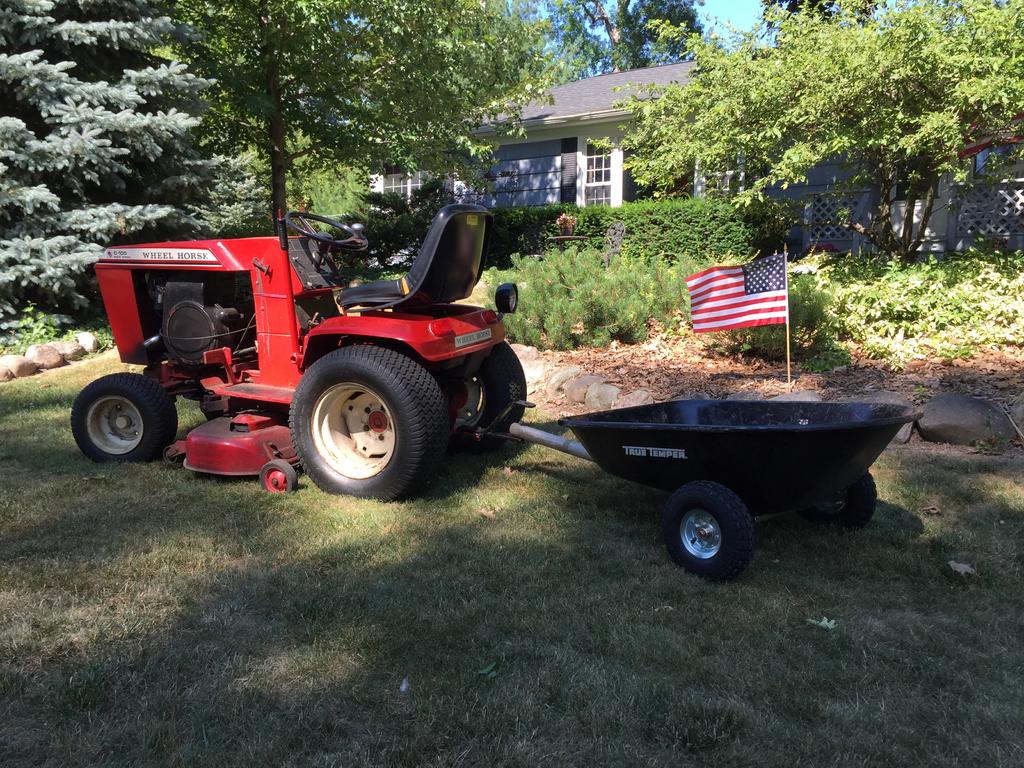

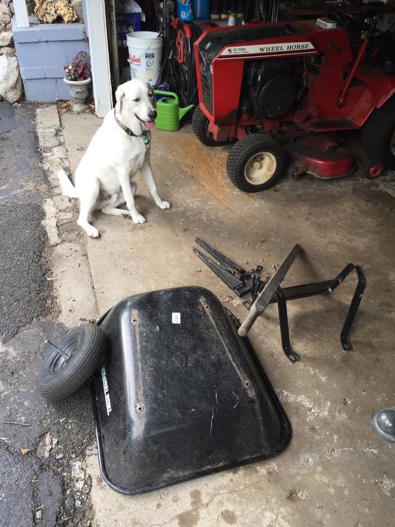

SylvanLakeWH 26,886 #1 Posted June 22, 2018 Picked this wheel barrow from neighbor's trash last week. One broken handle apparently meant it was "trash"... Tore down and will be converting to a Wheel Horse style dump cart. Still in design phase...Trying to do it with only materials on hand in my garage "stockpile" of junk spare parts and other necessities...in other words - FREE. (One exception - I will be painting it red and getting some graphics for it...) Will post progress as I go along... Oh - my helper's name is Denali. Great shop dog! 5 Share this post Link to post Share on other sites

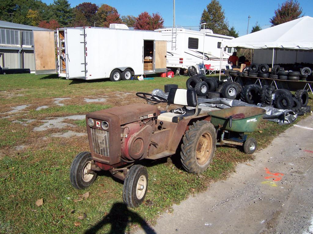

tarcoleo 119 #4 Posted June 22, 2018 I pay too much on stuff at flea markets with this rig. 2 2 Share this post Link to post Share on other sites

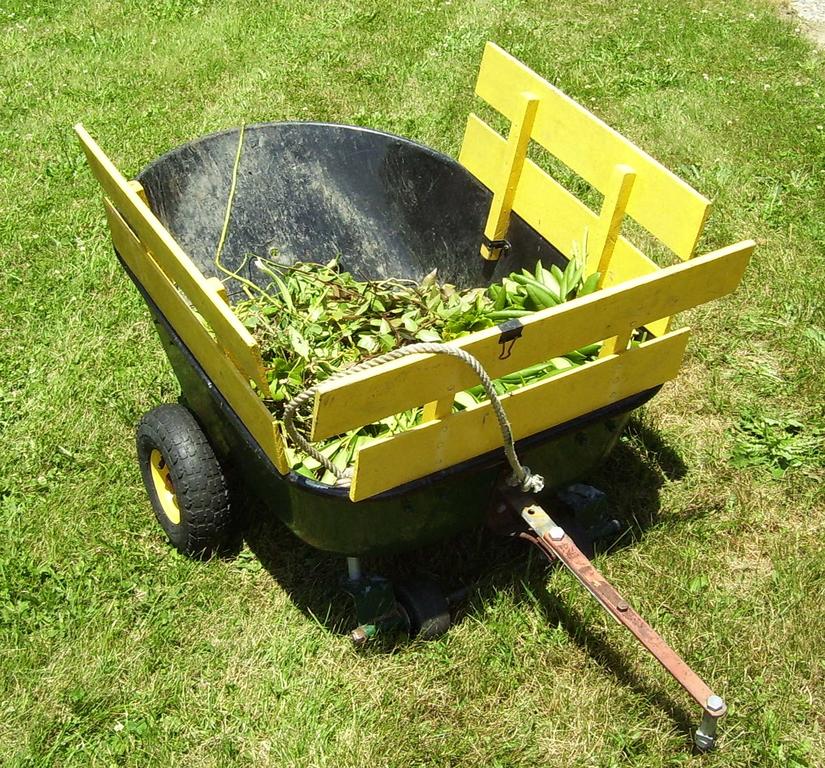

tarcoleo 119 #6 Posted June 23, 2018 (edited) Eric- All you need to convert the barrow to a trailer is a visit to Harbour Freight for wheels, a 5/8" rod, U-bolts, shaft collars, and steel for a tow bar. Not seen in my photo are two small wheels towards the front so that the rig can also be pulled along by hand without a prime mover. When attached to a PM, the small wheels clear the ground. Edited June 23, 2018 by tarcoleo 1 1 Share this post Link to post Share on other sites

tarcoleo 119 #8 Posted June 23, 2018 (edited) Hey Digger66, The rig is light enough to be able to dump contents without special provision. BTW, you could use small hose clamps to secure the wheels to the axle instead of shaft collars. This wagon is really utilitarian for odd yard jobs. Edited June 23, 2018 by tarcoleo 1 Share this post Link to post Share on other sites

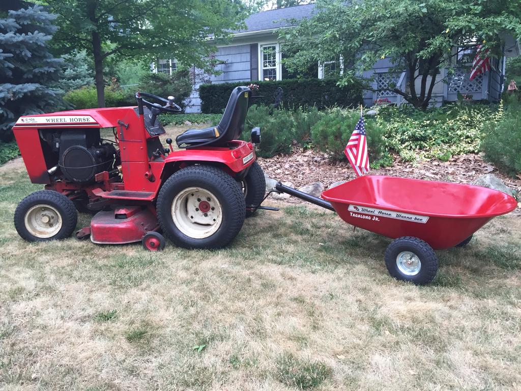

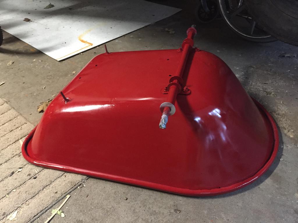

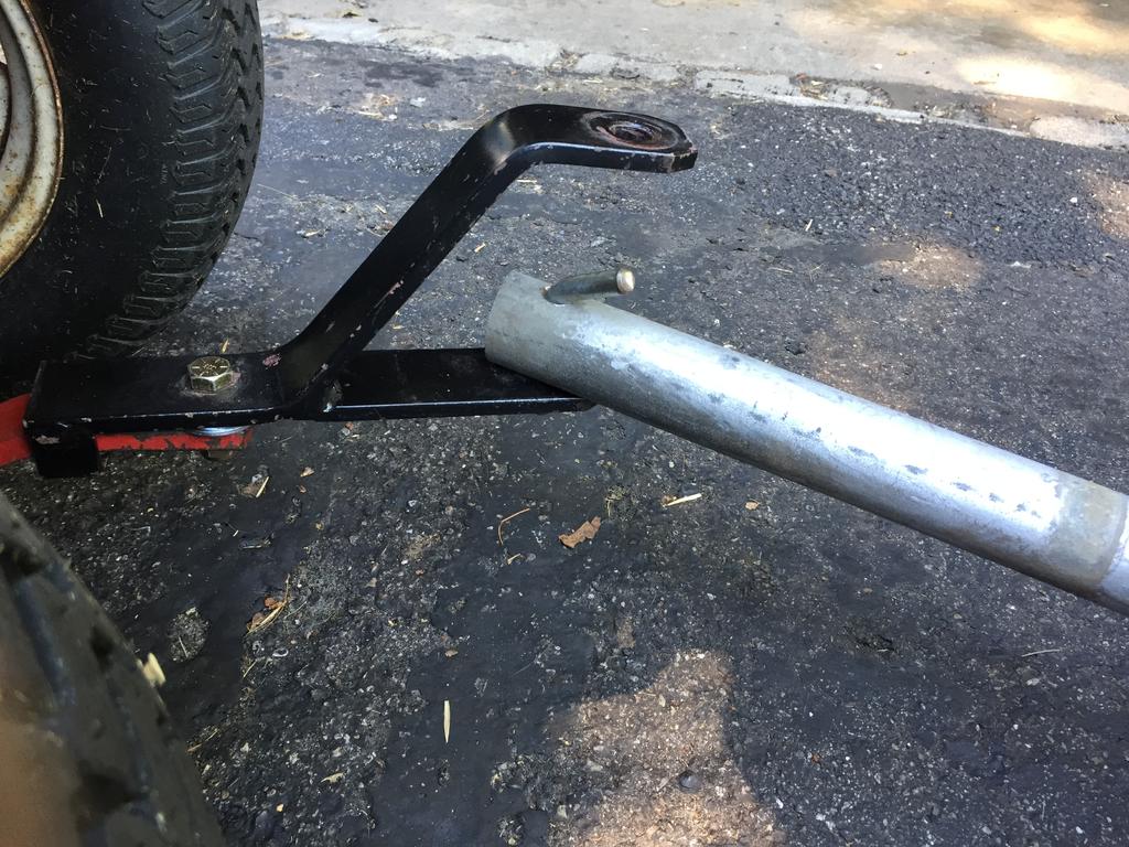

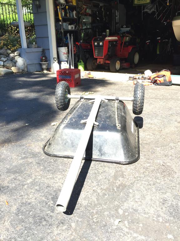

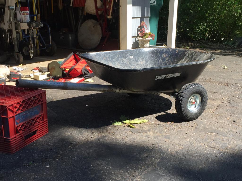

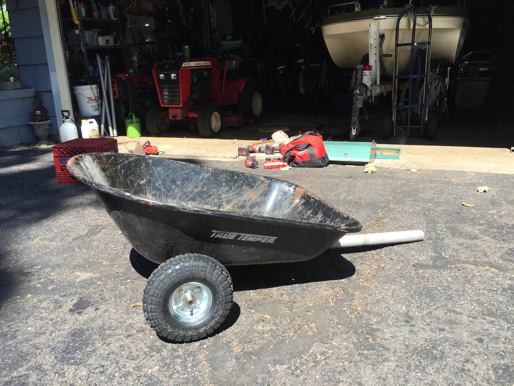

SylvanLakeWH 26,886 #9 Posted July 9, 2018 Got a lot accomplished today! Done with the build. Paint may be a while and some special decals are on order from @Vinylguy. Will post paint and decal progress in the future. In the mean-time it is functional and does everything I meant for it to do. Only cost was the tires, axle, 2 shaft collars and decals. Around $50 total. Old wheel barrow, stuff in the garage and a fence I am removing provided everything else. Decided not do a "dump" design. With this design I simply pull the pin and tip. Allows a much better dump of material - more like a wheel barrow - then re pin to the hitch...simple and no moving parts to break or be the "weak link"... 2 1 Share this post Link to post Share on other sites

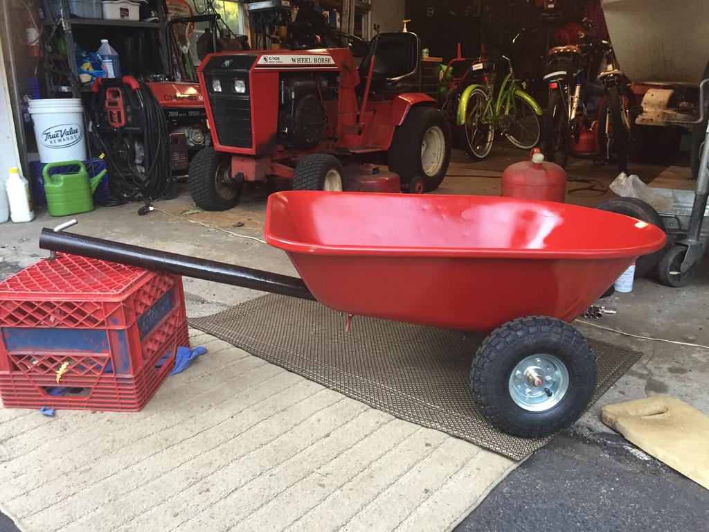

SylvanLakeWH 26,886 #11 Posted July 13, 2018 Progress today - Primed and first coat of Regal Red... Hope to finish paint tomorrow and put her all together so I can put the decals on when they get here - they shipped today! Expect them Monday! Thank You to RS vendor REDOYOURHORSE.com!!! 1 3 Share this post Link to post Share on other sites

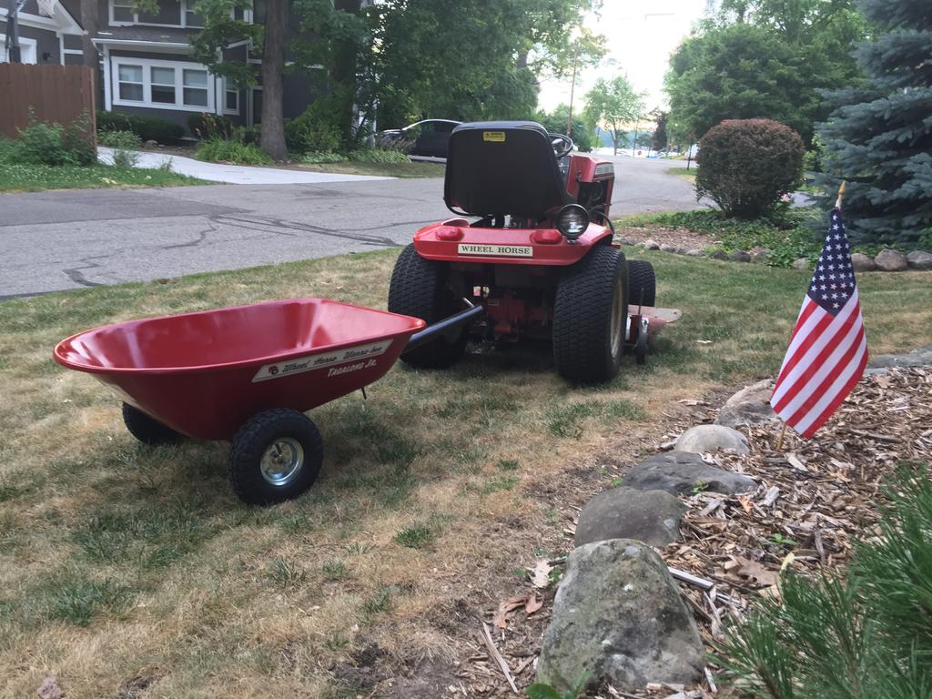

SylvanLakeWH 26,886 #12 Posted July 14, 2018 Done with everything except the decals! They come Monday! I'm happy with it! 3 3 Share this post Link to post Share on other sites

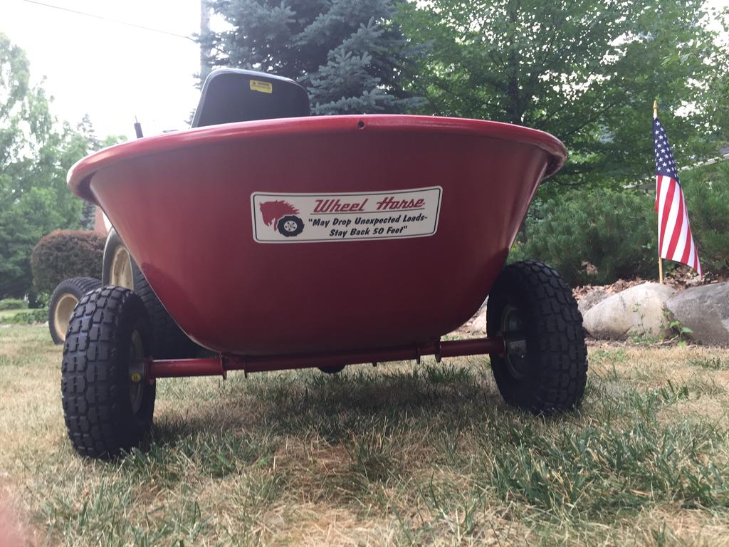

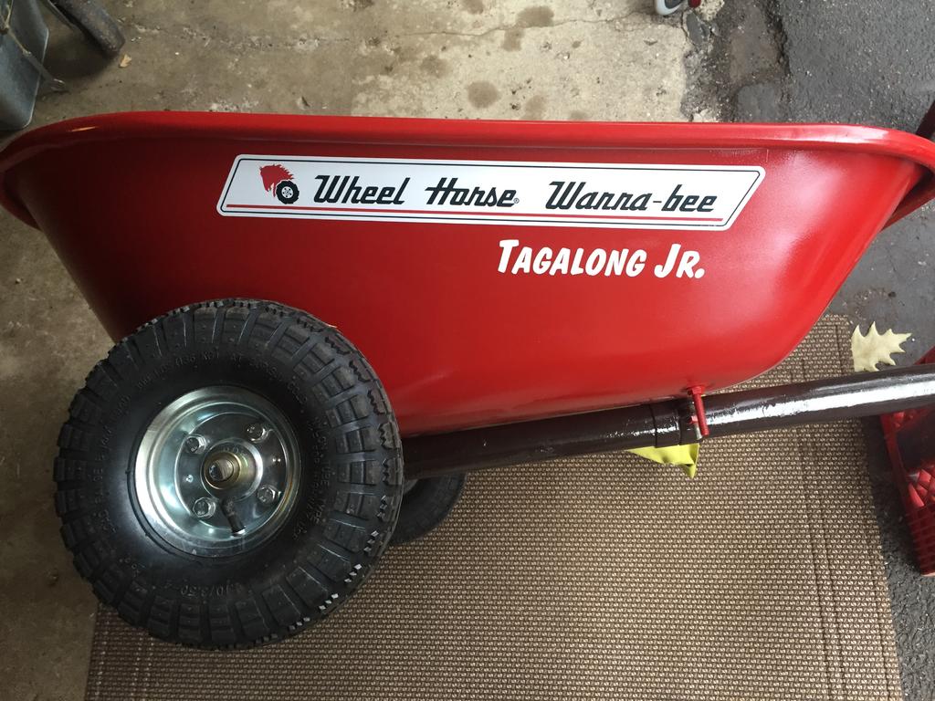

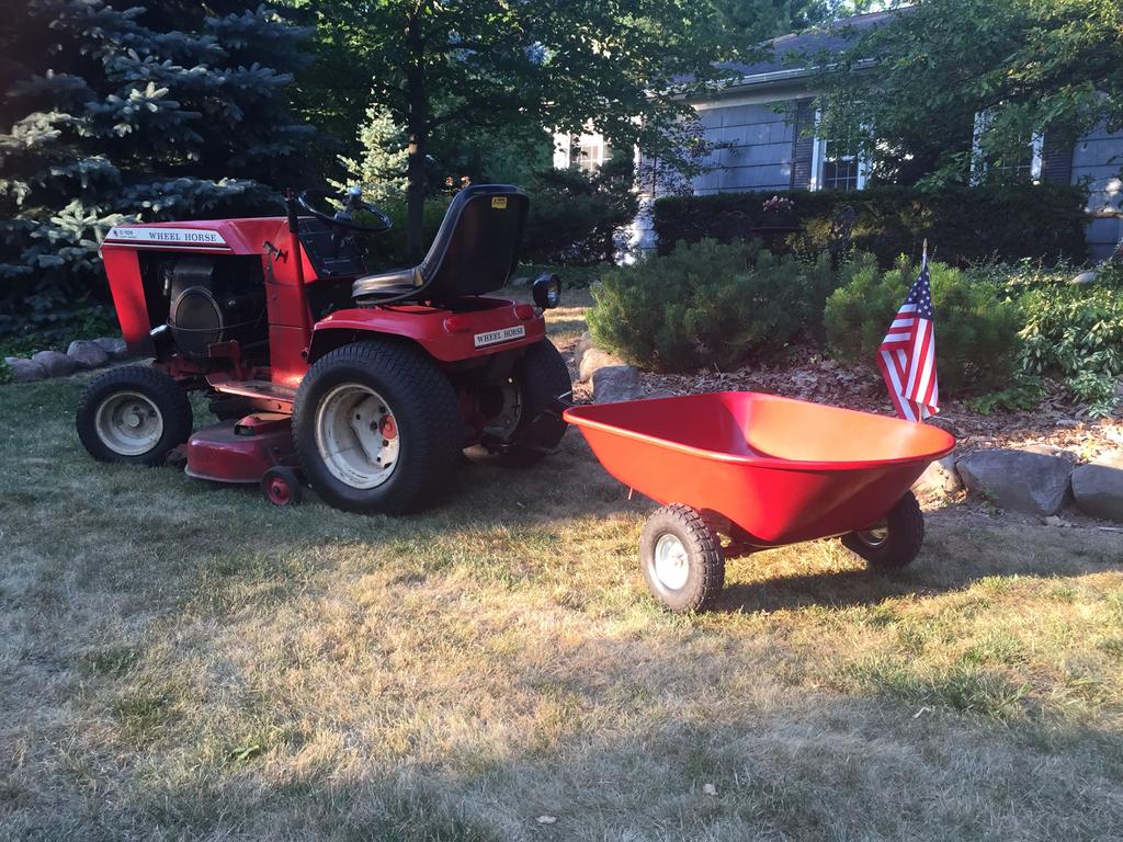

SylvanLakeWH 26,886 #13 Posted July 15, 2018 DONE!!! Decals came early! Thank you @Vinylguy!!! They are perfect! I am quite happy with it on all levels - rides perfect and I think it looks great! Thanks for following along! 2 5 1 Share this post Link to post Share on other sites
