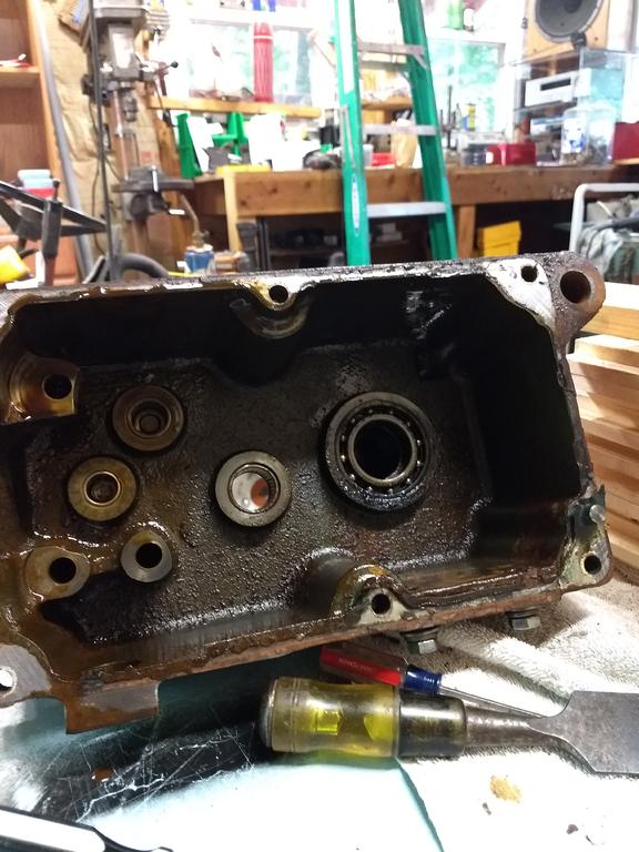

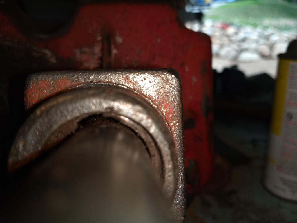

Below you will see a pic of a needle bearing and the end of the shaft on my honey's 657.
I know I need to split the case and put in a needle bearing.
My concern is that in the housing you can see a broken spot right at the top on the inside of the channel where the seal sits.
There's a small piece of the casting missing.
I'm not too concerned about the seal sitting okay because the rest of it seems to be in decent condition.
I'm wondering if that little missing piece is super important or not that big of a deal.
If it is a huge concern I will put an 8-speed in my b80 and give her the 4-speed out of that tractor.

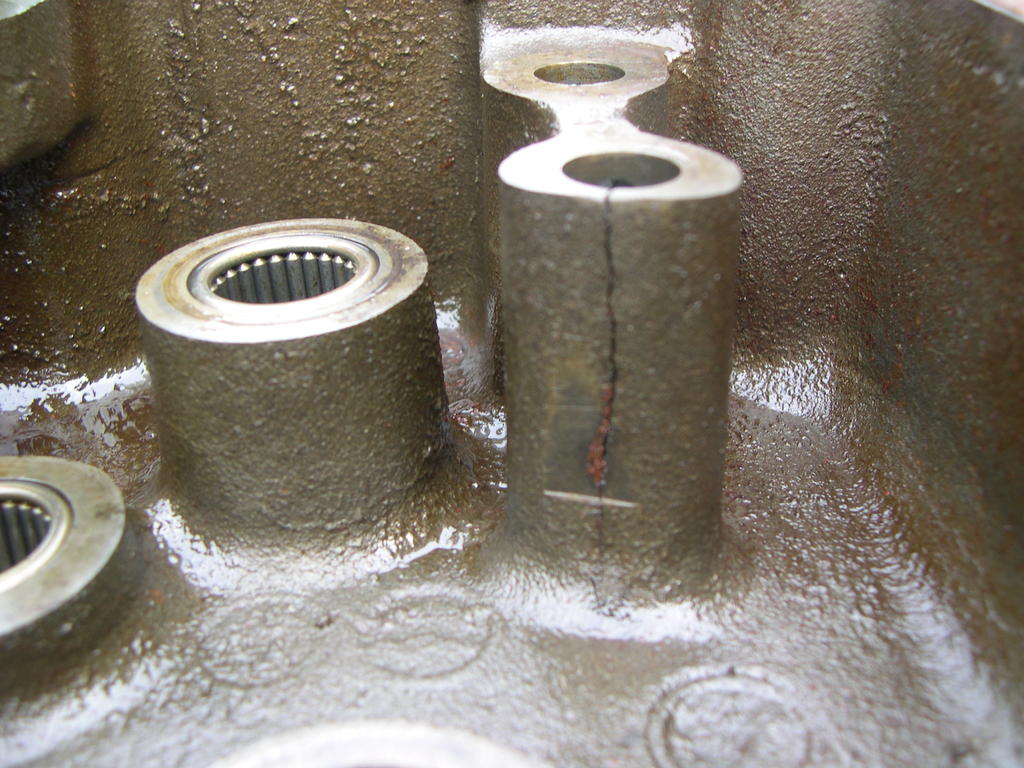

It probably will be fine but I do have a 5053 case that has a hairline crack where the shift rails go. I think I'm looking at the left case half in your picture. I don't remember which half had the crack on mine but I could check tomorrow. You'd be welcome to it if you could get it at the big show. :)

The missing piece looks to be too close to the shaft to be the casting. Maybe the outside shell of the bearing?
Garry
Garry
That could very well be Garry.
Not having ever had one of these apart I figured I had better consult the :wh: experts and see.

I think you're on to something Garry. In any case...........:rolleyes: if you want it you're welcome to it. I just need to know right away. Two engines loaded and secured today and final loading tomorrow. Here's a picture of the crack.
I'm sure that could be repaired but is probably serviceable as is since it's a low stress area. Again, I'm not sure what half it is tonight. I also think I removed all the bearings. Just let me know if you want it and have a pony express relay driver.
Garry
that's what I see, I had the same thing on my 854, this winter I will split it and change it out
stevasaurus
Garry is correct...it is what is left of the bearing race.  If your transmission is clean...Open it, pull out the differential, tap out the bearing shell. Tap in the new bearing, and slide back in the differential and close it up.  boom-sha-ka-la-ka  :occasion-xmas:
Bearing...KOYO # B-1616
Seal...SKF # 9815
Case Gasket (from TORO)...WH # 3912

You know, if that is the left side (and it looks like it), you just need to open the case.  That is the side you pull off to get inside.  If you do decide to pull everything out and clean it out good use this thread with the videos.  This one is close to what you have.  :occasion-xmas:

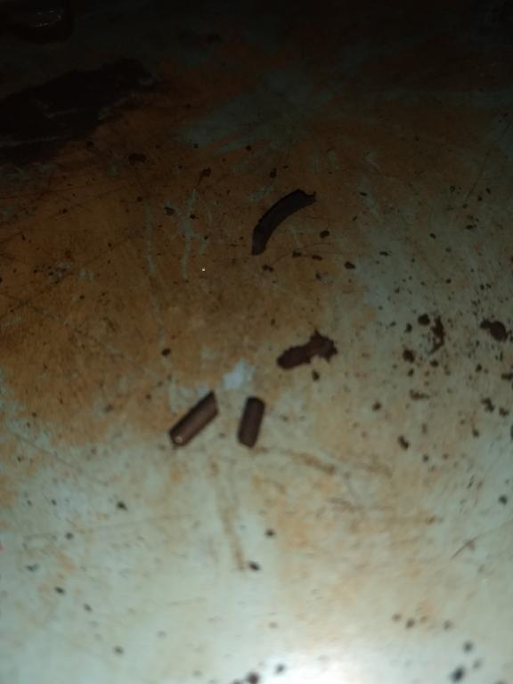

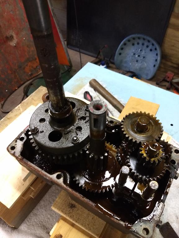

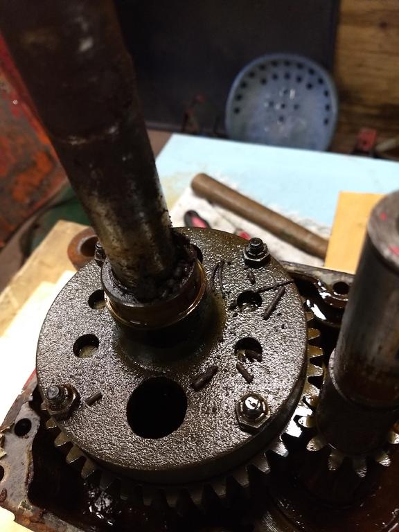

Here's how it came apart. Not clean by any means but certainly not the dirtiest one I've ever seen on pictures.
There are pieces of roller bearing throughout that arm and mixed in with the big ball bearing that the differential rides in. That bearing feels okay so I'm hoping I can clean it up and not have to spend the 45 bucks or whatever that that is.

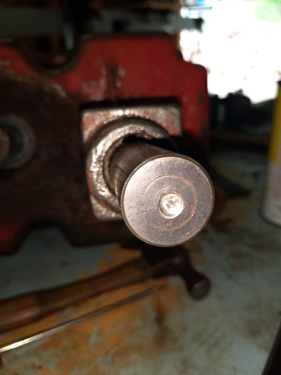

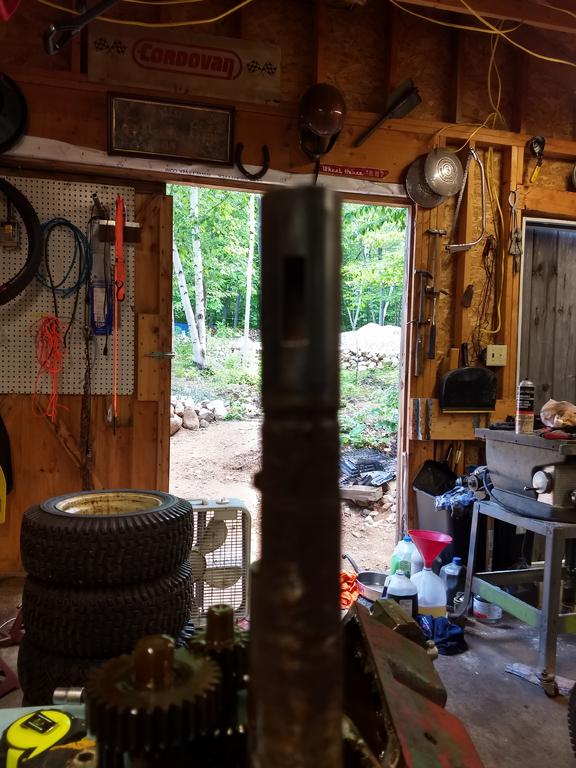

My current question for you -does the shaft normally have that slight Groove you can see?
Edit -shaft is a bit fuzzy but look just about even with the Stonewall.
I don't have another shaft and this one will just have to go back together the way it is after I clean it up but I'm wondering if that's a normal thing?

Well I've got it all torn apart and some cleaned up and will be working on it more today.
I wire brushed the bad shaft and it's got quite a nasty spot where the bad bearing was riding.
It'll have to do for now... Trina won't be pulling much weight with this Tractor so it should get her through a season or two.
When I get past a few other projects I'll disassemble the 4 speed from the B80 and see if that shaft is better. As previously stated that Tractor is getting an 8.
@Racinbob thanks for the offer of the case!  Should be fine.
Now I'll need to figure out the shaft instead.....

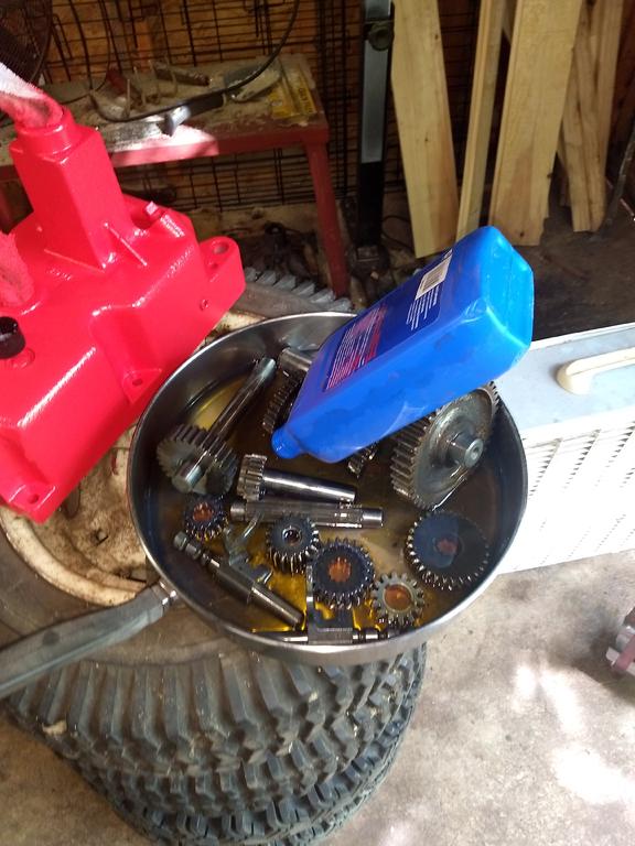

Spent a few minutes with a pretty strong mix of Zep purple Power getting after the gears this morning.
Left them to sit in and oil bath until I get to reassembly.
