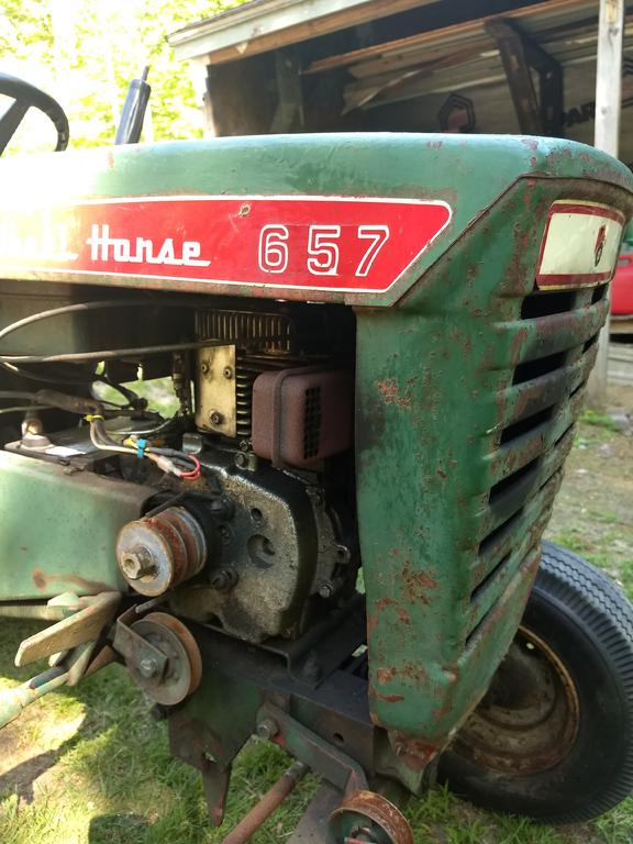

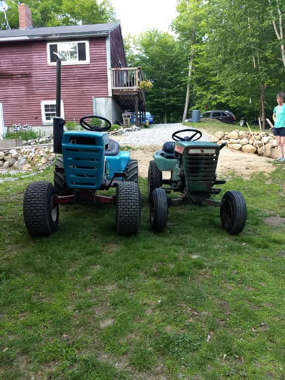

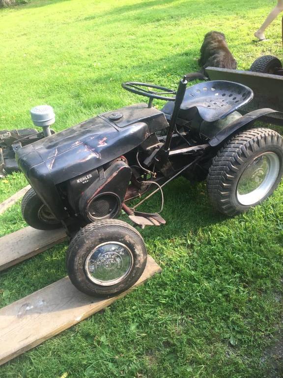

As stated in another section my honey went and bought herself a 657 a few days ago. Sunday afternoon to be exact.
Runs and drives quite well and had a very serious and non negotiable issue.
It's Oliver green with Ford gray wheels.
Other than that the work should be minimal standard stuff.
Well of course she started tearing right into the disassembling of the lucky little tractor.
We started to show the daily work being done to it and then realized we should really start a new thread in the proper location.

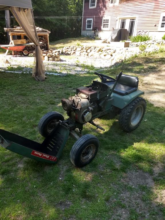

So here's a few before pics as a reminder.

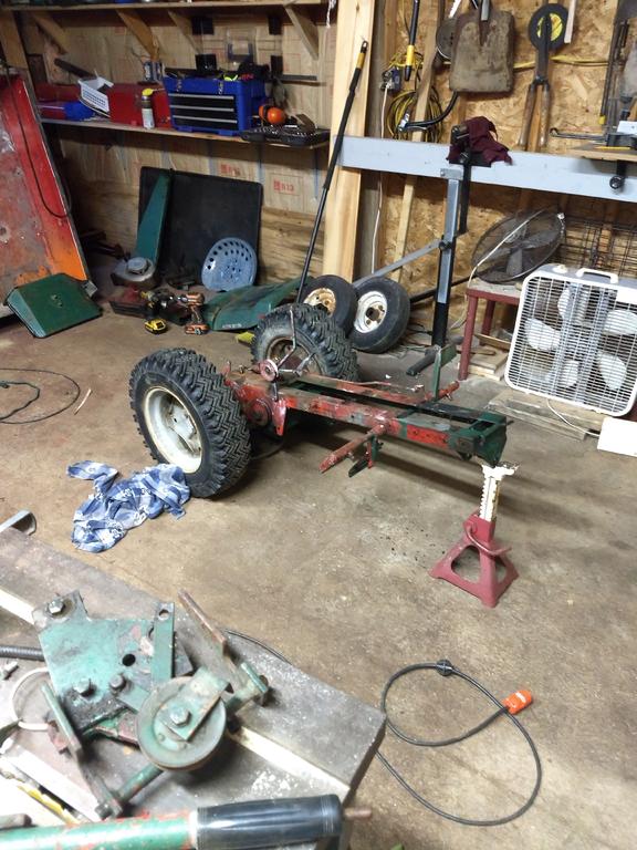

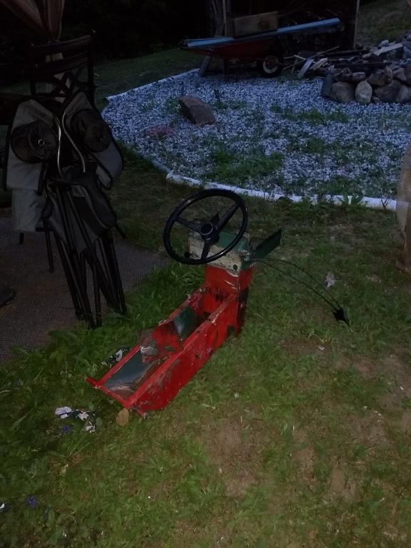

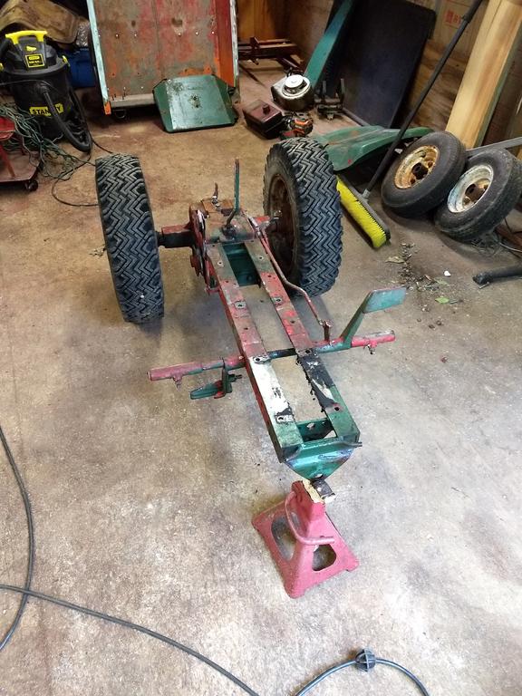

Here's the end of Sunday results.
And a pic from Monday nights work.

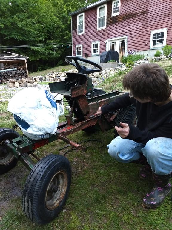

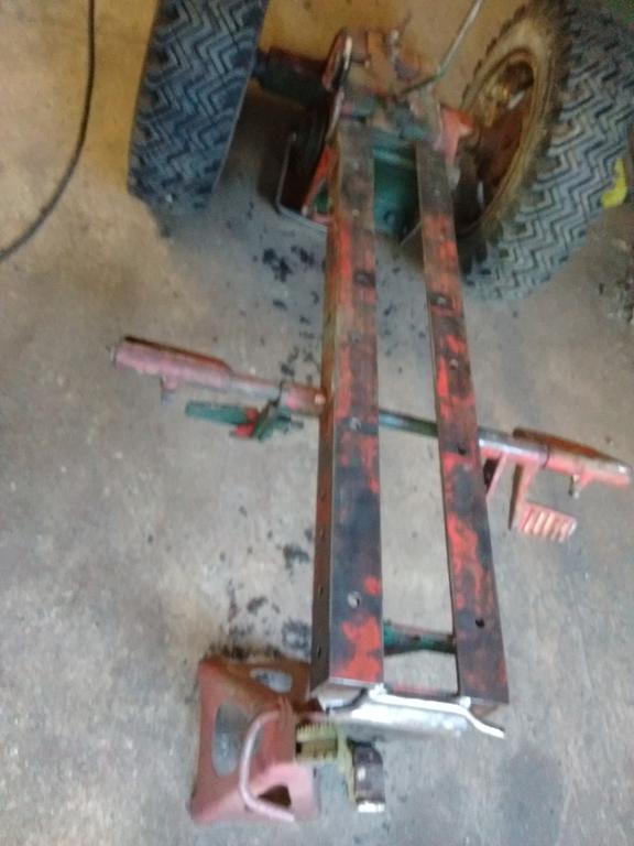

After this was taken she found some spray on paint stripper and emptied the can on it.
We left it on for 24 hours or so.
And found red paint!!

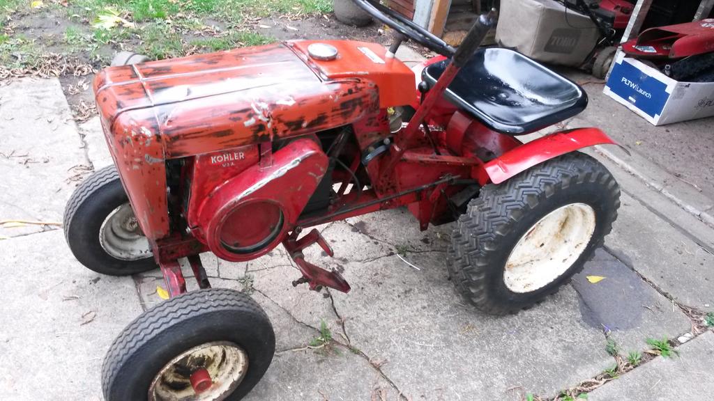

It's amazing what is hiding under those odd paint jobs we come across. Heres some pics for motivation on saving the original paint. This was a 701 I did. Lots of paint stripper and wet sanding.

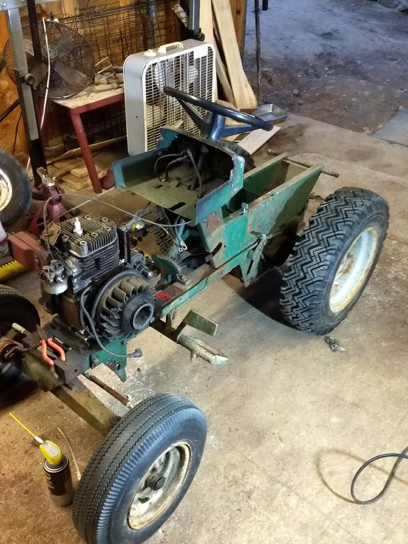

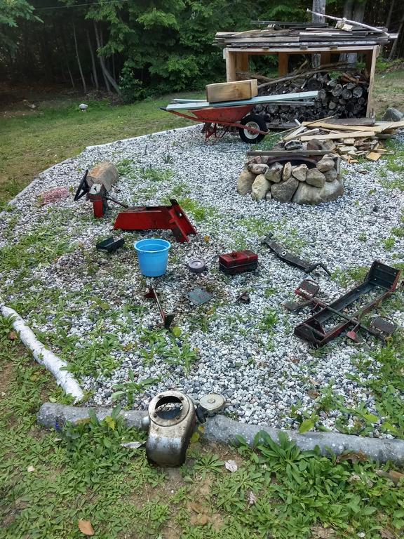

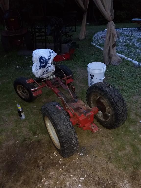

Status update!!
Tore off the engine.
Removed front axle assembly.
Began demudification of transmission internals.
  • Like 5
  • Excellent 2

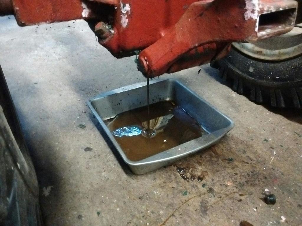

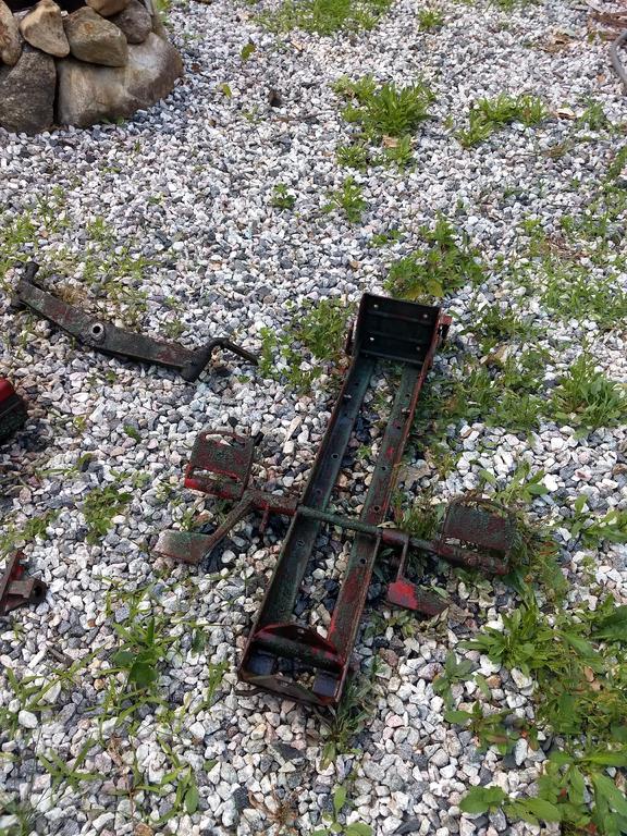

ebinmaine

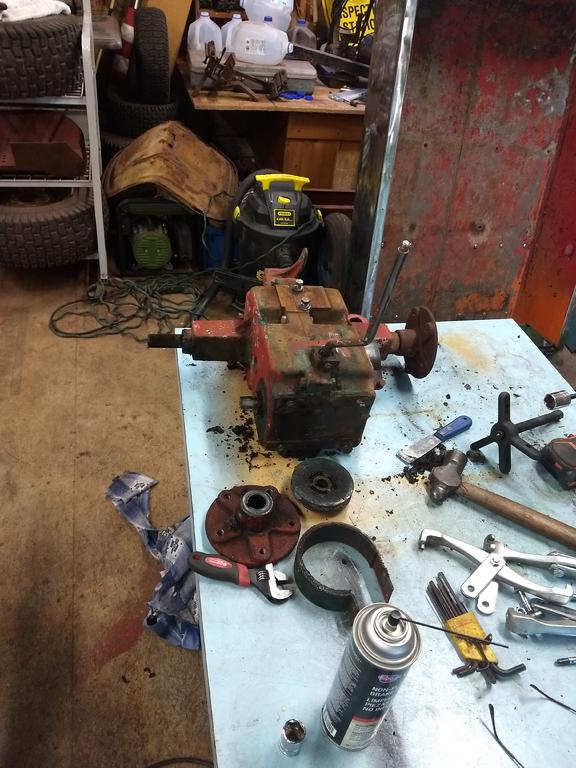

Note the transmission drainage in the last post.
After sitting for 22 hours that pan is almost full.

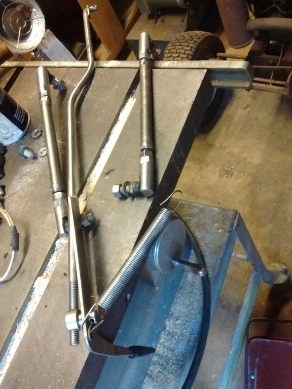

Tonight's Leisure Time was spent cleaning up a few pieces. Removing 50 plus years of rust and somebody's poor green paint decision from the past.
Brake linkage before:
And after, with tie rods for bonus viewing:

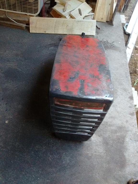

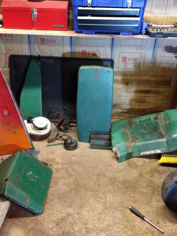

Worked on the hood
Scraped a bit of muck off the frame and started wire brushing

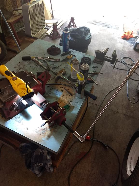

ebinmaine

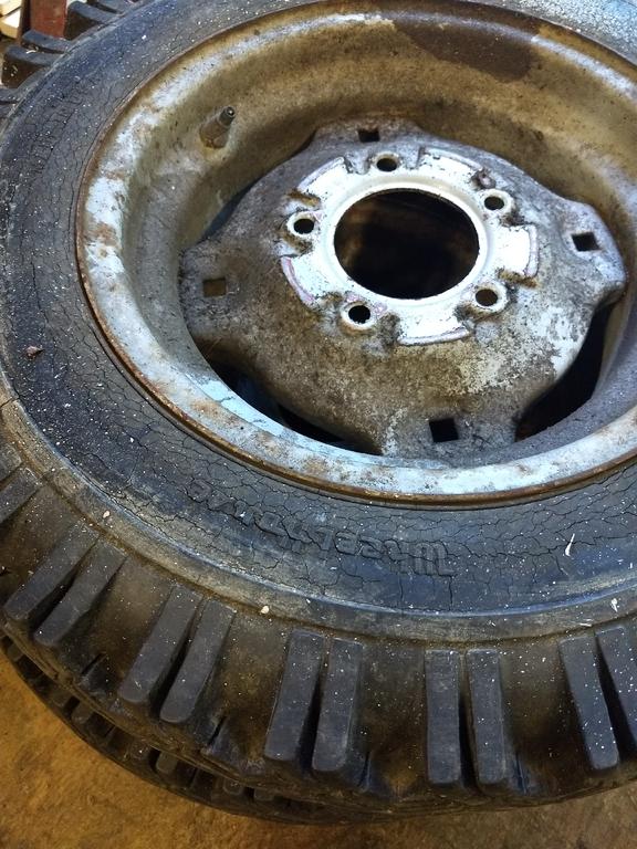

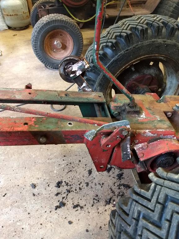

And tonight!!!
More disassembling and cleaning.
Real live :wh: tires!!!
This hub was a little loose and the seal had been leaking for a looooong time so it came off with near zero effort.
Same for the input pulley.
The other hub I'm gonna set up one of the 5 bolt pullers using another hub.
Tried tonight but my bolts were a bit short.
Here's a pile of parts being soaked in paint remover.

No new pics from yesterday but I did get a couple seals out of the transmission.

ebinmaine

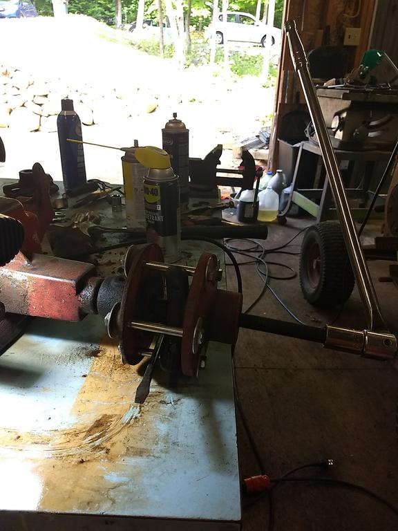

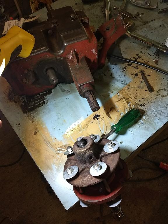

Today I spent quite a bit of time working on the transmission. Got a lot more paint off of it. Removed the shifter. Dog Point screw looks great. Wire brushed up a bunch of nuts and bolts that attach to it. Got the brake pulley off. Then...
I set up the five Bolt hub removal tool.
Heat it. Oil it. Repeat. Repeat. Repeat.
Tighten up the bolts a little.
Just kept at it for about 3 1/2 hours between other things.
Quite a few times I was leaning down on that 25 in breaker bar hard enough that it was lifting the whole of the transmission.
That thing fought me tooth and nail and every other way to do it all the way out to the very end of the Hub shaft.
In the end.... I WON !!!!!
