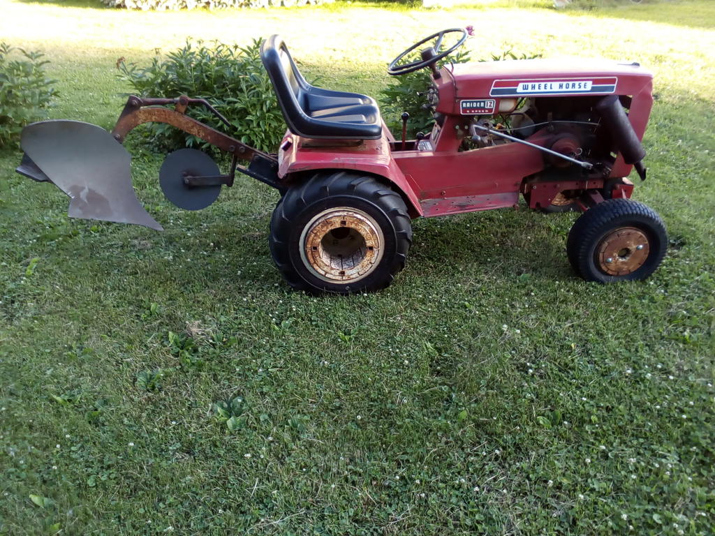

I have this 12 inch moldboard plow and needed to extend the hitch. Put an electric lift on my 72 Raider 12 and the motor
on it sits across the back of the transmission right in the way of the pl;ow using the slot hitch. With some mockup I saw
that if extended 3 1/2 inches it would clear. Went to a local Amish welding shop to see about getting the steel and have
him weld it up. I was pleasantly surprised he charged me a whole 10 dollars to do this. Figured the steel would be more
than that!  Would have been ok with more.
Achto
Have any pictures?
Howie

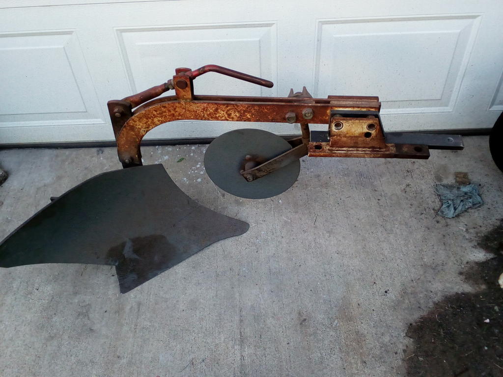

Howie
Let's try another one.IMG_20180613_201604.jpg.88760f9d45f490626529b2d74d89ccfc.jpg
Howie
That is with the original hitch in front of the new one.
Well done sir
:handgestures-thumbupright:
Tankman
Many years ago, did the same add on for turning the earth.
Only problem I had, the Horse reared up until I added weights, Duh! :rolleyes:
Also made a front bumper for suitcase weights. :handgestures-thumbupright:
My sons loved the Horse so much, we had to round up a few more. Of course we did!
