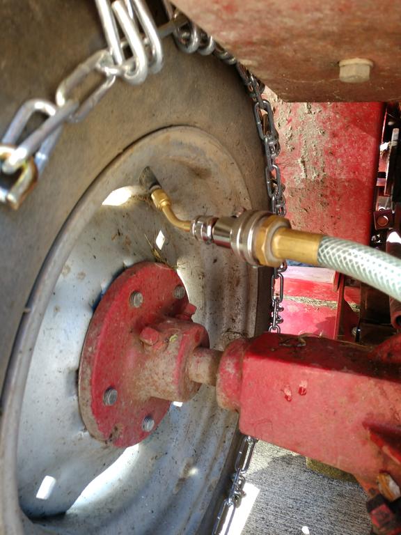

I ended up with tire chains and filled the tires front and rear. I used a single pulley and anchor system to reduce the load on the tractor and just finished pulling (tractor on a long upward 15 degree slope) two cord worth of oak up a 70 degree slope. I had to use rope to get down to the timber, hitched the drag line to it, and man did that tractor pull it right up the hill at half throttle in Low 1. It easily pulled 15 foot long 18" diameter logs up to the bucking area. Without the chains, liquid and the help from all of you, I wouldn't have been able to do it. I have two more trees to pull from the same hill. These machines are amazing! They don't make anything like them today that are affordable for the home lumberjack.

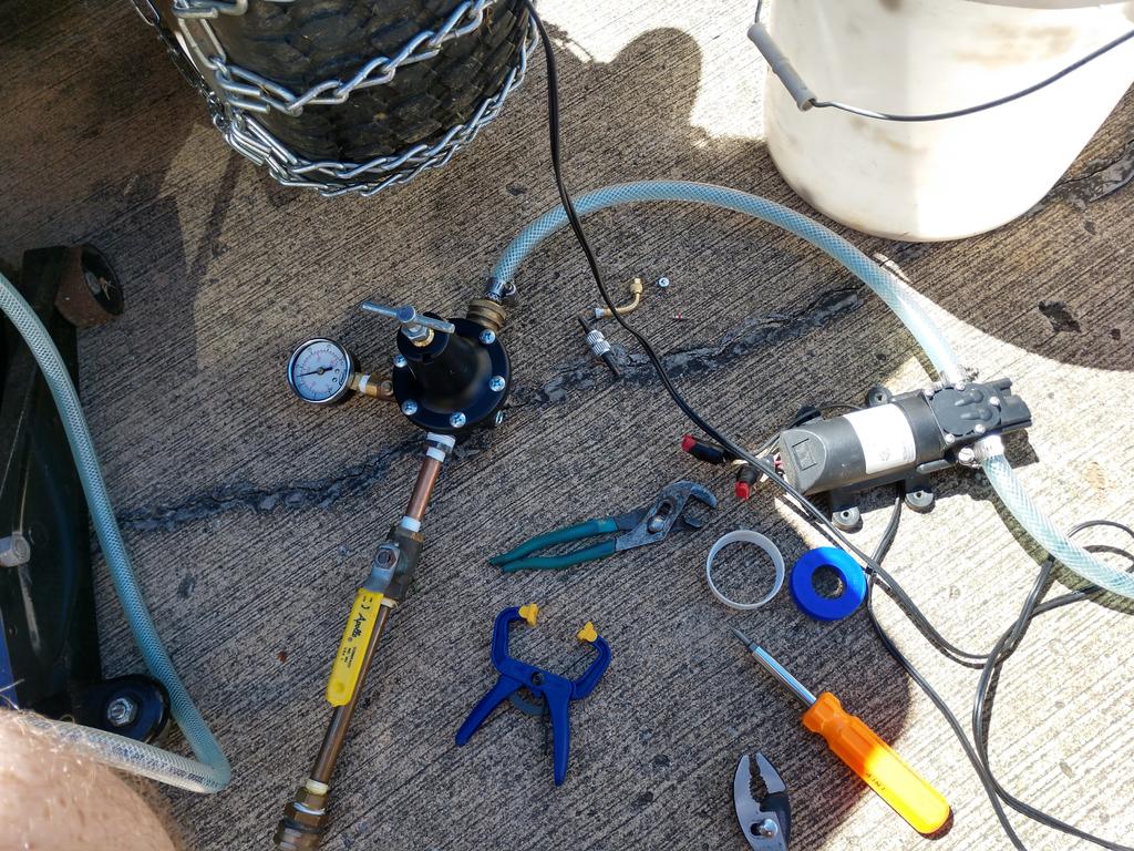

Oh by the way - I've seen it mentioned people get 6 gallons in the rear. I have 23 x 8.5-12 tires and using an rv pump, a special regulator, the air bleeder/Schrader adapter, and an assortment of angled valve stem adapters - I was able to to get 7 gallons each by pressurizing the liquid to 12psi. Two and a half gallons in each front tire. I used the angle adapters mostly to depress the valve stems on the tires instead of remove them. The regulator allowed me to automatically cut the flow off at 12 psi. I'm a plumber so this is all stuff I had laying around except for the liquid/air adapter.

I ran two valve stems on the wheels I used and no tubes with RV antifreeze - nearly 7.5 gallons per rear tire. That resulted in nearly blowing out my lower back when I lifted the 1st one off the bench - it also had the 50lb cast iron weight bolted into it. 145lbs each rear, no spinning, lol...
You have to block the wheel up at just the right angle to really fill them up at maximum, but be aware your frame/rear axle will probably suffer as a result.
