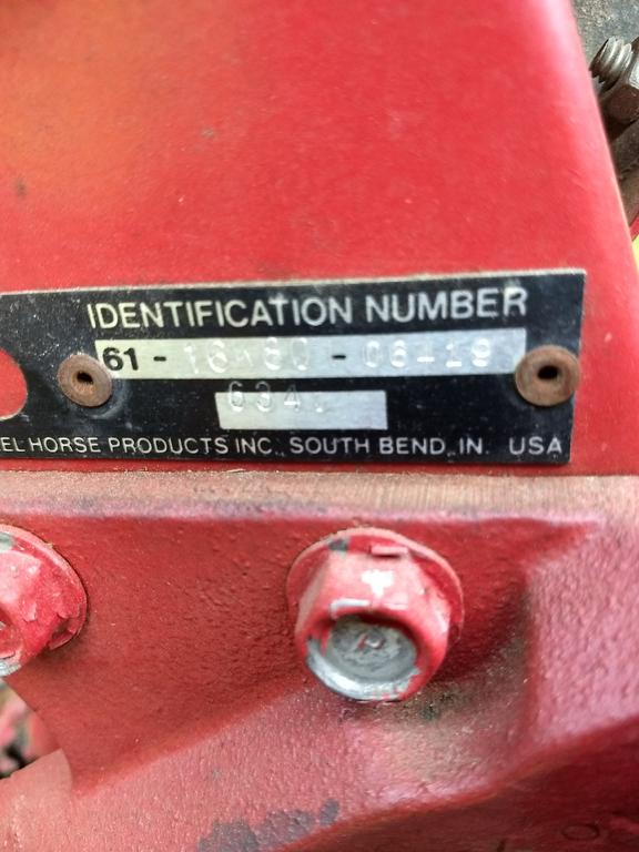

Would someone be so kind as to identify the tractor tag in the picture?

rmaynard
1976 C-160 8-speed

2 minutes ago, rmaynard said:
1976 C-160 8-speed
Thank you Bob!
If you have this tag would you mind typing out the numbers. Can't read them all.
Click on the picture. Entered what I think I see.

Sparky
61-16K801 1976 C Series Garden Tractor C-160 8-Speed Kohler K341S-71128A 16.
