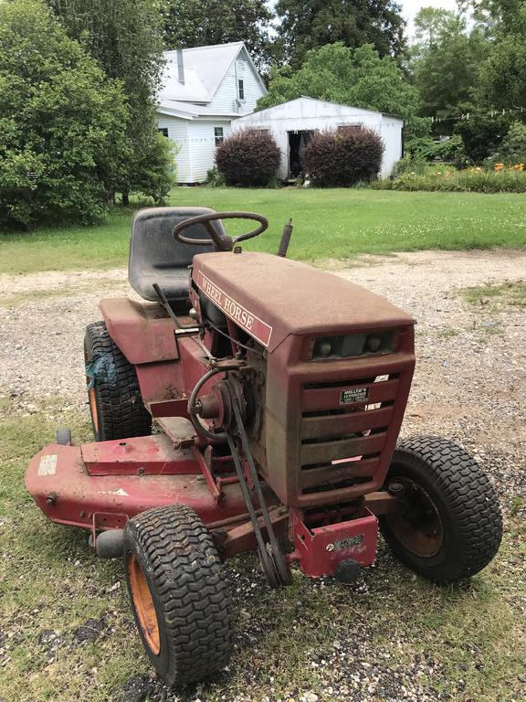

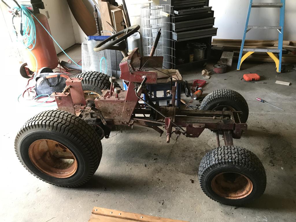

mc1960 43 #1 Posted June 10, 2018 Decided to restore my Mother in Laws 1976 C-160 8 speed. I have never done anything like this before so I will be asking for help from time to time. It has been kept under shed its entire life so everything is in pretty good shape. I haven’t got the engine running yet, waiting on carburetor kit and brushes for starter. I am going to take it down to the frame and repaint undecided what paint to use, I have sprayed lacquer on wood but have never painted metal with anything other than with spray cans. 5 6 Share this post Link to post Share on other sites

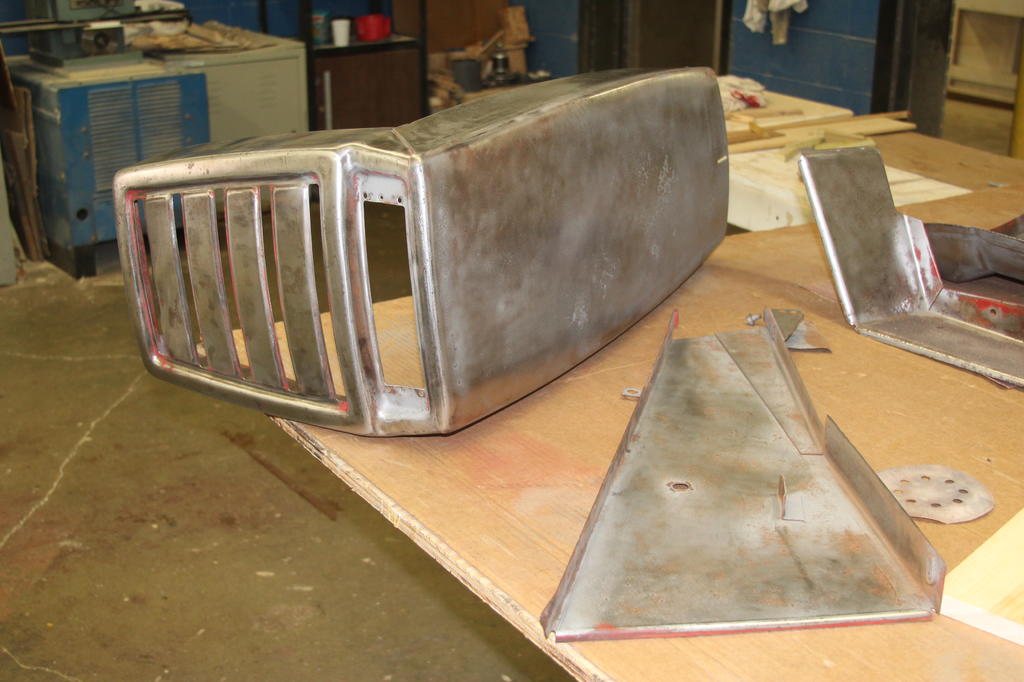

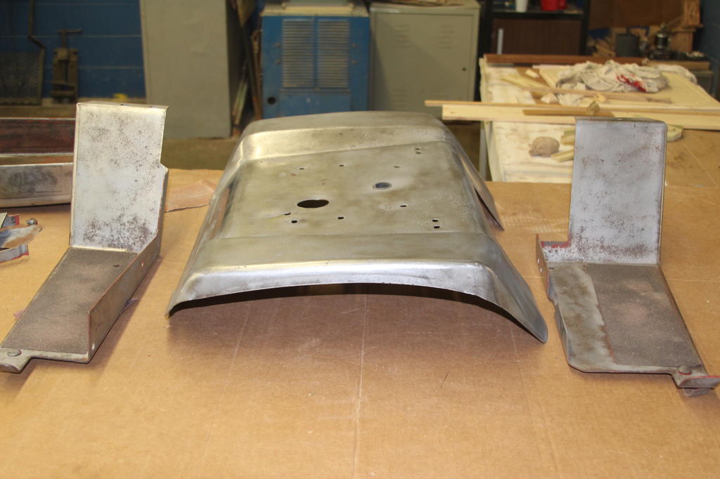

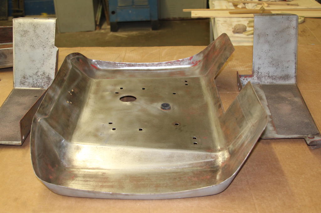

mc1960 43 #19 Posted June 17, 2018 Happy Fathers Day to everyone. I was reading on another forum and someone mentioned using a engine parts cleaner to strip paint. We have a big parts cleaner that heats up that we put car engines in to clean them before rebuilding them. Do you think this would strip the paint on the hood, fenders etc? Share this post Link to post Share on other sites
Sarge 3,464 #20 Posted June 18, 2018 An engine hot tank might be too much for sheet metal - at the temperature they operate, it could warp those parts. Sarge Share this post Link to post Share on other sites
mc1960 43 #21 Posted June 19, 2018 (edited) Thanks Sarge, it ended up that they had changed the fluid from caustic, to a degreaser, so I am putting it in the blast cabinet instead. Working on the hood, fender, floor boards and belt guard now. Edited June 19, 2018 by mc1960 Share this post Link to post Share on other sites

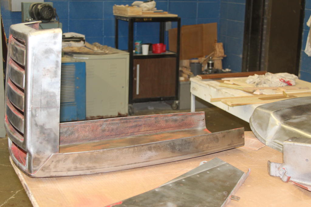

mc1960 43 #22 Posted June 20, 2018 Getting ready to fill some pits. 1 Share this post Link to post Share on other sites
ebinmaine 68,874 #23 Posted June 20, 2018 12 minutes ago, mc1960 said: fill some pits. How will you be doing that? I would be very appreciative if you were to share some pics and information about that process. I know very little About making things smooth. I have some body panels on a similar vintage tractor that I would like to try 2 smooth out before painting. Share this post Link to post Share on other sites
mc1960 43 #24 Posted June 21, 2018 I will be spreading a light coat of bondo over the pits then sanding them down, then I am going to shoot a coat, or more if needed, of high build primer until I have everything smooth and ready for paint. I am by no means an expert, fortunate to work at a technical college to where I have access to equipment, help and advise. I will post more pictures after bondo has been applied and sanded. 1 Share this post Link to post Share on other sites
