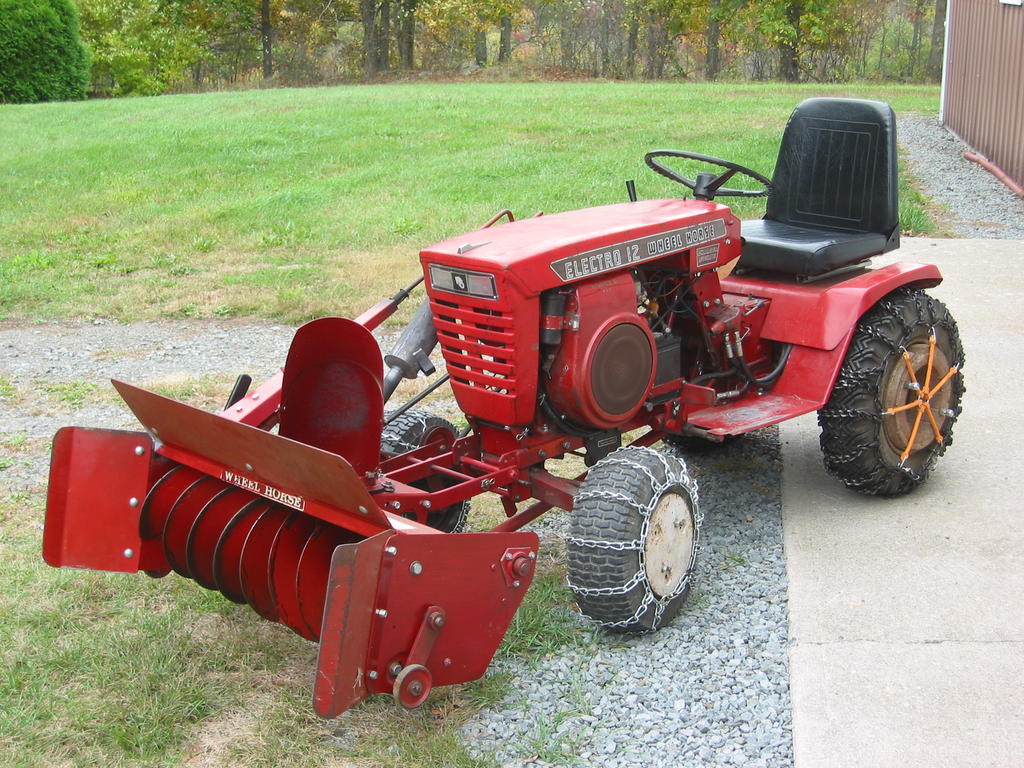

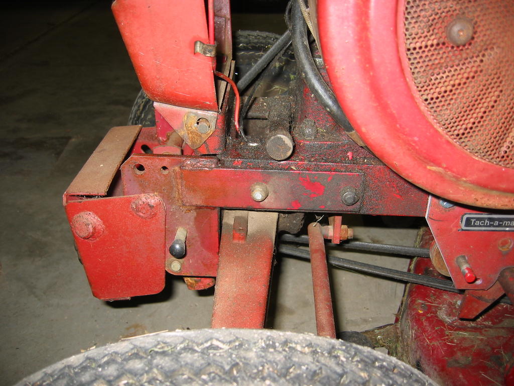

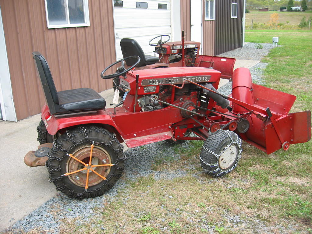

My electro 12 (now a 16 hp) with the 5551 hitch.  Easy bolt on.  There is a thread somewhere on here that shows how to do some drilling and mount a front tachmatic on  older machines
