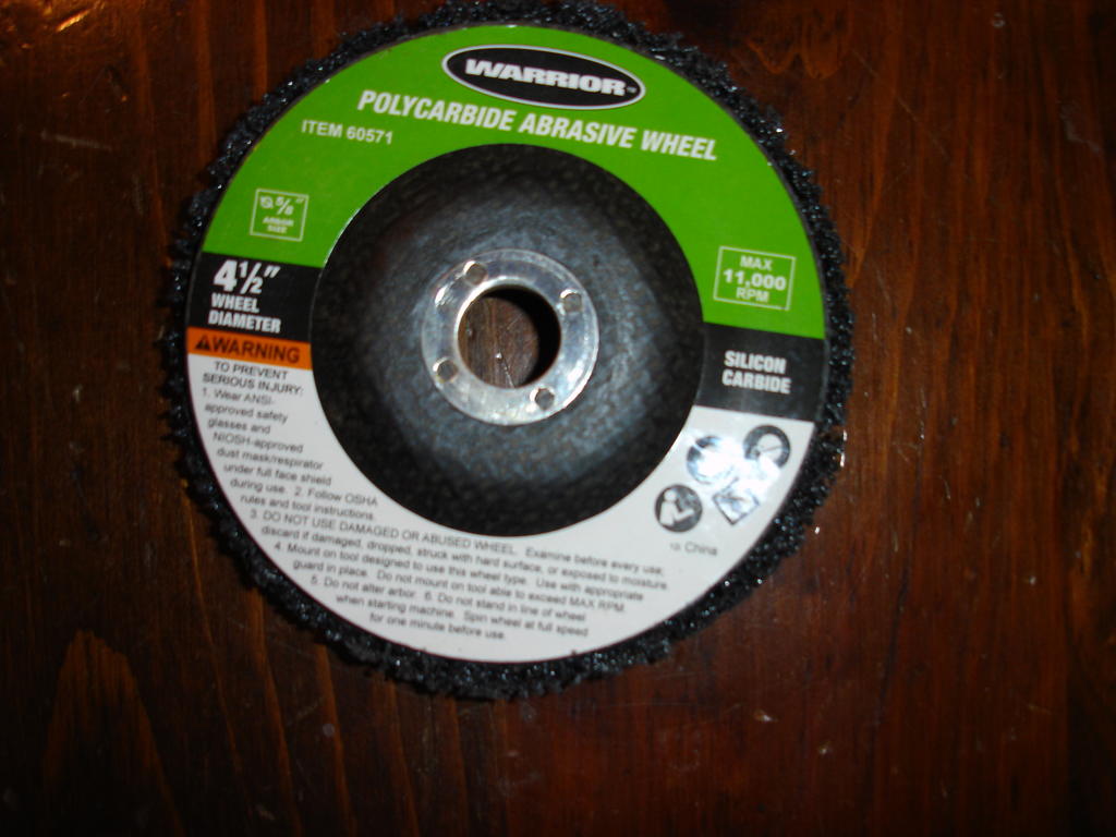

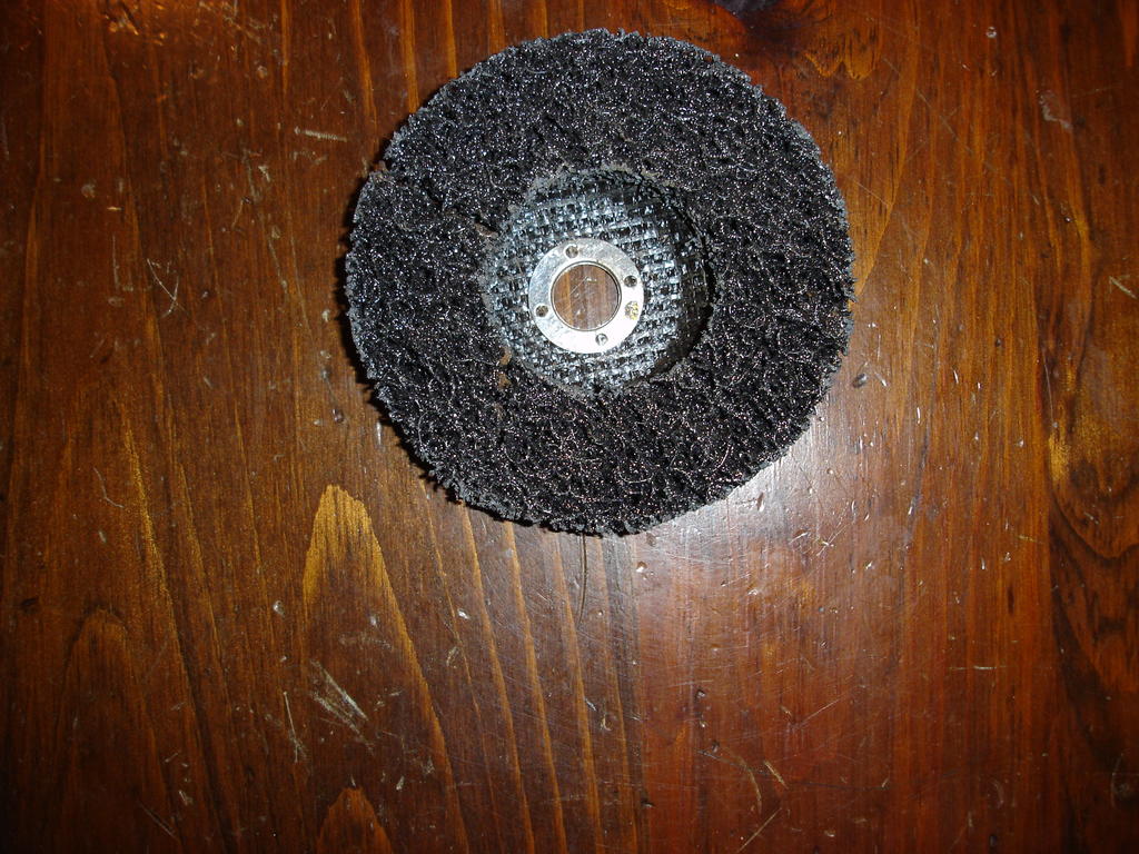

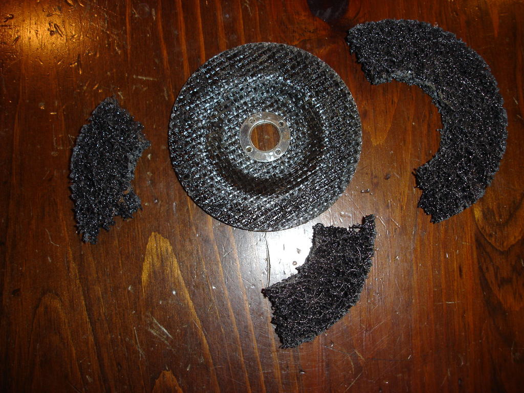

I have been using the discs in the following pictures. We are so used to reading the warnings on grinding wheels etc that we sometimes don't give it much thought. Well it did happen and I did have on the protective equipment. I turned the tool on and within seconds the abrasive separated from the backer wheel. Fortunately no damage to me. I use these things often and have worn them down to nothing almost without issue. Not this time though.

:text-yeahthat:               Had one come apart before it even made contact with the work piece, looked like only a third of it had any adhesive. yours doesn't look like it had any!

Open structure cleaning disks of that type are very dangerous, they probably have the highest track record of explosions due to how they are built. I do not use them and especially won't use any from Harbor Freight - sometimes you get exactly what you pay for. Glad to hear you were wearing a face shield, those fragments really hurt and are nearly impossible to dig out of your skin. It does look like it wasn't properly bonded, lucky it broke into large pieces and didn't totally explode as most do.
A much higher quality and much safer disk to use are the ones from either 3M, or Camel (CGW), such as this - http://www.cgwheels.com/strip-disc
That is exactly what happened with this one.
