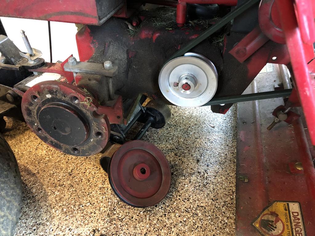

AndyK149 62 #29 Posted May 5, 2019 Today I replaced the transmission pulley with a 4.5":after struggling with the too-slow-two and too-fast-three gearing for decades. It was raining hard today so I only did a quick run up and down the driveway, but my intial impression is that two will make a very nice mowing speed. 3 will be way too fast but good for moving from A to B. One is actually a little usable now too. 2 Share this post Link to post Share on other sites
jay bee 912 #30 Posted May 7, 2019 I'm assuming you had to change belt size. What did you change to? Share this post Link to post Share on other sites
AndyK149 62 #31 Posted May 7, 2019 I bought this: https://www.amazon.com/gp/product/B000CRDLTI/ref=ppx_yo_dt_b_search_asin_title?ie=UTF8&psc=1 I'm not sure if it will stretch at all, but if it doesn't, I would want one an inch longer. I mowed with it yesterday, I like the speed change. Really makes a guy wish he had a hyrdro, but this is a better combination FOR ME than the OEM ratio. 1 Share this post Link to post Share on other sites
