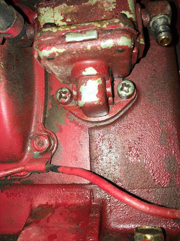

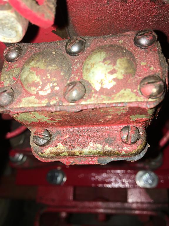

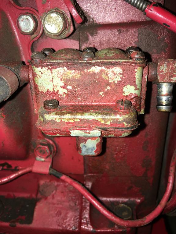

gapper 22 #1 Posted June 3, 2018 Hello all, I have a K341S Spec 71223a. Is there a fuel pump rebuild kit for my motor? If not can someone help me with the part number of the fuel pump i need? I see so many different numbers for pumps saying they are for a K341. I would prefer to have my OEM metal pump. I am open to doing the electric pump but it would have to be a simple setup. No regulator needed. I found a old post on here that had a electric pump part number but i could not find that part. Any help would be great as i don't want to mount the fuel tank on top of the hood so gravity can do the work. LOL here is a couple pics of my fuel pump Share this post Link to post Share on other sites

rjg854 12,625 #8 Posted June 4, 2018 I just took my fuel pump apart, off a 16 auto. It was leaking gas between the two halves. One of the screws was stripped out, which I replaced with a nut and bolt. The diaphragm was still usable but has some damage. The only problem I had was, it leaks oil between the pump and the engine once you shut it down. Now I know why they had 2 gaskets on it. So it's very doable, but before you read how to rebuild it in the kohler engine manual, there's some good tips in there. Share this post Link to post Share on other sites
gapper 22 #9 Posted June 6, 2018 I pulled the pump off and after a good clean job found that the four screws that hold the halves together were loose. I tightened them and reinstalled the pump to see if this was my problem all along. The pump is working and no more gas leak. I am going to run it for awhile to see how it holds up. Now i just need to figure out the kohler part number for the air cleaner and pre filter. The filter that is on it is Aprox. 6" OD 4 5/8" ID 3" H Does anyone have the Kohler part number for a filter of this size? Thanks for all the help Share this post Link to post Share on other sites
