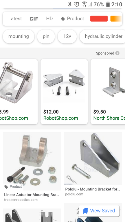

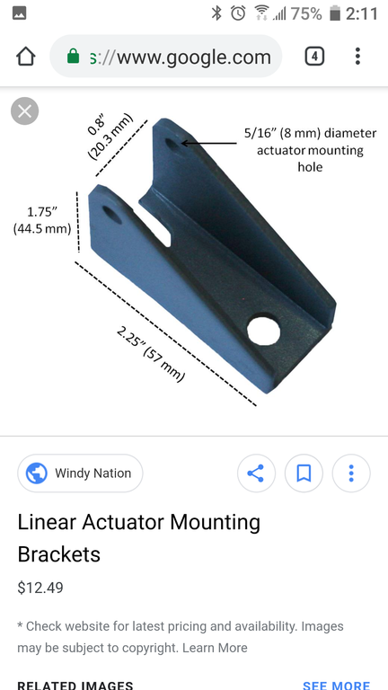

WVHillbilly520H 10,376 #27 Posted October 14, 2018 The brackets are the easy and cheap part, and I believe between 12-24" stroke would be what you need and thrust force should always be rated more than actual load. Share this post Link to post Share on other sites
ebinmaine 70,788 #28 Posted October 14, 2018 4 minutes ago, WVHillbilly520H said: brackets are the easy and cheap part, and I believe between 12-24" stroke would be what you need and thrust force should always be rated more than actual load. Those brackets look good. Those would work perfectly actually. I think I would probably want to go to a 24-inch. The load in this trailer would weigh over a thousand pounds when full. I'm not sure how much of the percentage of that would be on the wheels versus how much would be needed to be lifted. Share this post Link to post Share on other sites

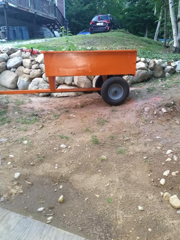

ebinmaine 70,788 #31 Posted October 14, 2018 Well, here's what I came up with as a temporary stop Gap measure for my hoist situation. @Mows4three @Machineguy I might try to pick up a very inexpensive boat trailer hoist and bolt it to the bottom of either the tongue or the vertical piece. More experimentation to follow... It seems to work fairly well with an empty trailer. Empty. Not full. No idea what's going to happen when I put a thousand pounds of rocks in it. 1 2 Share this post Link to post Share on other sites
Mows4three 826 #32 Posted October 14, 2018 Nice job! Just as long as Trina has enough leverage to run that come-a-long, you're golden! Now you've really done it, Eric. You've motivated me to get my own trailer project back onto the welding table. Have a mobile home axle and trailer wheels begging to get turned into a new firewood cart. Now that my 312-8 is all gussied up and ready to go to hunting camp, and the "new to me" White GT 1855 has a working 3-point hitch, I've got no excuses. Time to make a mess in the shop and put a new wood cart to work in the woods! Dave 2 1 Share this post Link to post Share on other sites
19richie66 17,578 #33 Posted October 14, 2018 41 minutes ago, ebinmaine said: No idea what's going to happen when I put a thousand pounds of rocks in it. Hopefully not a busted nose🙈 be careful with that comealong. Of course you know that...... your a trucker 👍 2 1 Share this post Link to post Share on other sites
ebinmaine 70,788 #34 Posted October 14, 2018 37 minutes ago, 19richie66 said: Hopefully not a busted nose🙈 be careful with that comealong. Of course you know that...... your a trucker 👍 This particular one has kind of a weird safety trigger on it. It's either tightening and pulling on the cable or completely in Freewheel to pull cable out. The other one I have you can back off tooth by tooth by tooth. This one will not do that. Because of not wanting to bash myself in my beautiful face I put it on upside down. It won't be on there for very long anyway. I may not even use it to move rocks at all. Might just wait until I get a different winch.... Also still thinking about the above idea with the hydraulic ram. 1 1 Share this post Link to post Share on other sites

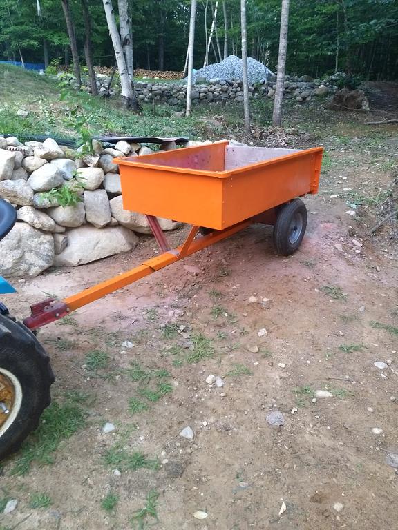

The Tuul Crib 7,338 #40 Posted October 18, 2018 On 7/29/2018 at 7:12 PM, ebinmaine said: Well, we finally got back to working on this trailer today. Haven't touched it for nearly two months because of many other things going on. My honey washed it off and put primer and a coat of paint on some parts of it. Hey that belongs in Tennessee! That's our colors! 1 1 Share this post Link to post Share on other sites
