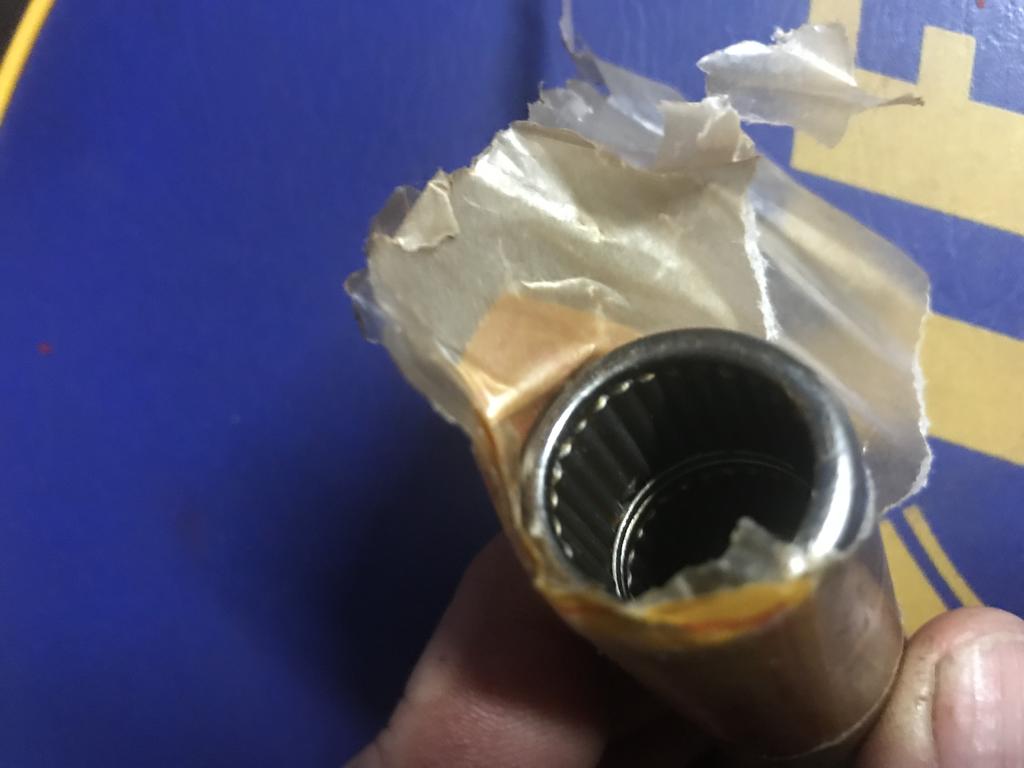

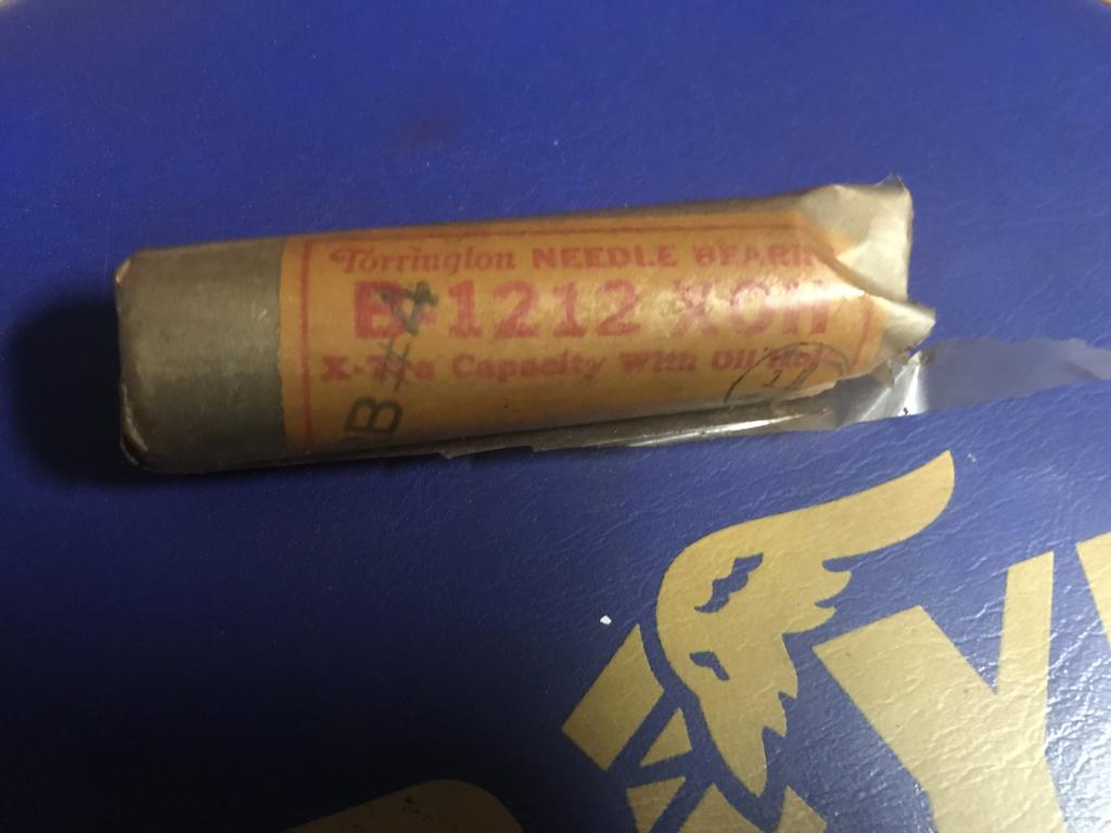

Lane Ranger
That is what I used on my RM-116  Lawn Ranger deck ten years ago when I  rebuilt the spindles.
And I used a large diameter dowell rod to place these bearings in the shaft as the needle bearings do not like metal to metal contact when pounding them in.
These Torrington B-1212 bearings were used in more things than anyone can imagine in World War II .  I bought a dozen for $5 dollars on Ebay years ago.   They were still wrapped in the wax paper they were originally stored in.   I still have four that still have the wax paper around them from 75 years ago !
Edited by Lane Ranger
