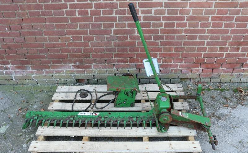

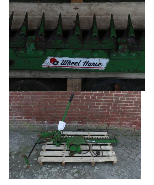

Hello All !
I came across this one.
It has a wheel horse sticker and the a serial number A-40391.
Does anyone have any additional information ?
Its on a local auction and closing soon... ill just go for it i think hihi.
Main thing would be.....to what will it fit ? and does it look like it has parts missing ?
Thank you in advance !

SMS-425 and appears complete except the travel arm which I have if you need one.  Will fit most early models i.e.701, 857, etc...  Some have modified them to work on a 520-H as well as others.  Here is one of mine on the 701.

I was looking at it one of the bearings, that seems to be gone.
Thats a relative easy fix. (the two above each other ..in the corner, one missing)
Most interesting.... it looks like it will "stock fit" the 316-8 ?
If measured bolt distances, and i think it will fit ....just like that ...with almost no "hush" at all !
Cant wait to see if that actually is the case, possibly being a bit too optimistic hihi.
If it does... deep respect to Wheel horse !... there is a large age difference between them, i almost cant believe it would.... ("stock fit  that is)
Most likely would have to change the pulley bearing ? as im not sure what RPM the sickle bar would like to receive.
But at least i could give it a try, before we repaint it and set it aside till the commando is ready.
Besides the fact its now "drained" in sae30 oil, ill first give it some new oil ...before we forget that hihi.
Other than that...it runs "smooth".
Hopefully i could give it a small test tomorrow !
Thank u guys !
henryhpsd
Obvious, I celebrated to soon.... hihi.
Seems the holes in the frame and the `gearbox` do line up on the `airfilter` side, but do not at the PTO side.
Besides if they did...i feel the PTO pulley is a bit to far out.(they are not in a vertical line above each other'.
That could be resolved using the attach o matic at the front which i use for the mowing deck...but still it doesnt line up like i would.
And in that case the protection plate of that gearbox needed some cutting (which i dont want hihi)
Taking a second look tomorrow !

I ended up taking off the mid-mount tachamatic and bolting it to the frame. As far as the pulley not lining up, I got an offset pulley for the shaft on the sicklebar and it works fine. I mounted it on a C-121 8 speed. When I get home from the big show I will try to remember to take pictures of it. Remember one thing, that is these things don't like to run fast. Running it too fast will blow up the wobble box!!!
