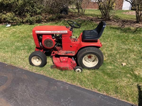

Bill Sherman 11 #1 Posted May 29, 2018 I have a 1979 C-161 automatic that still has 10w30 oil in it. What are the pros and cons of converting it to transmission fluid? My school of thought is if it's been working fine with oil in it then why change it? Also, it was designed to run on 10w30 so would converting it cause problems? I just wanted to hear what people who know more about Wheel Horses have to say about the subject. Any input is greatly appreciated. Share this post Link to post Share on other sites
