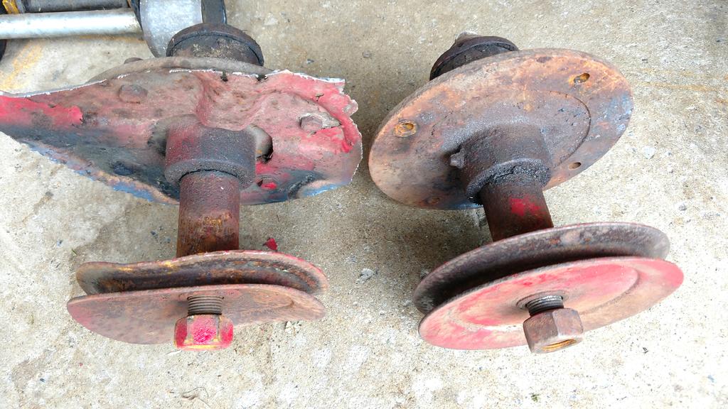

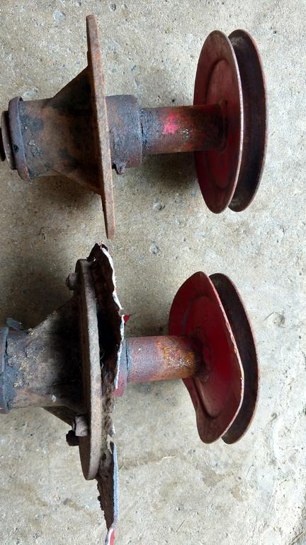

I'm trying to salvage the spindles from my old deck before I toss it to the road.  I tried using a puller I have to remove the pulley from one and bent the pulley in the process.  What's the best way to get these pulleys off so I can take the spindles off the deck?
EDIT: We cut the deck to get the assemblies out, still need to know how to get the pulleys off the shafts.

I have the same deck and needed to remove the pully.  You want to be careful not  to damage the pully because they are hard to come buy.  The pully just slides on the spindle but is probably badly rusted on like mine was.  I turned to deck upside down and soaked the pully and shaft in wd40 for about a week.  I was able to drive the pully off, without damage.  I put 2 2x4s under the pully across the deck and put 2 nuts on the shaft to start and took one off as the shaft went down. It took a lot of time but worked.
Good Luck
