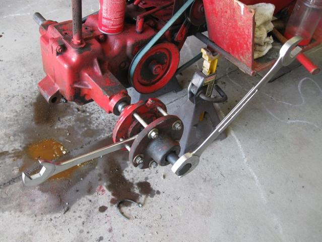

daveoman1966 3,809 #2 Posted May 18, 2018 got an old hub...if so, try this setup 1 2 Share this post Link to post Share on other sites

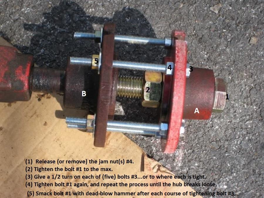

953 nut 57,985 #3 Posted May 18, 2018 If you have a bottle jack, some 3/8" all-thread and an old hub you can do this. 5 2 Share this post Link to post Share on other sites

Mike'sHorseBarn 3,144 #6 Posted May 18, 2018 7 hours ago, daveoman1966 said: got an old hub...if so, try this setup 1 hour ago, 953 nut said: If you have a bottle jack, some 3/8" all-thread and an old hub you can do this. I'm stealing both of your ideas! 1 1 Share this post Link to post Share on other sites
meadowfield 2,651 #7 Posted May 18, 2018 9 hours ago, Mike'sHorseBarn said: I'm stealing both of your ideas! That bottle jack looks familiar... as does that workshop... 1 Share this post Link to post Share on other sites
953 nut 57,985 #8 Posted May 18, 2018 1 hour ago, meadowfield said: That bottle jack looks familiar... as does that workshop. I was so impressed with the puller that I saved the image, but couldn't remember who to credit for the idea. I have now rectified that shortcoming! 1 Share this post Link to post Share on other sites
